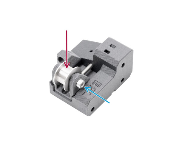

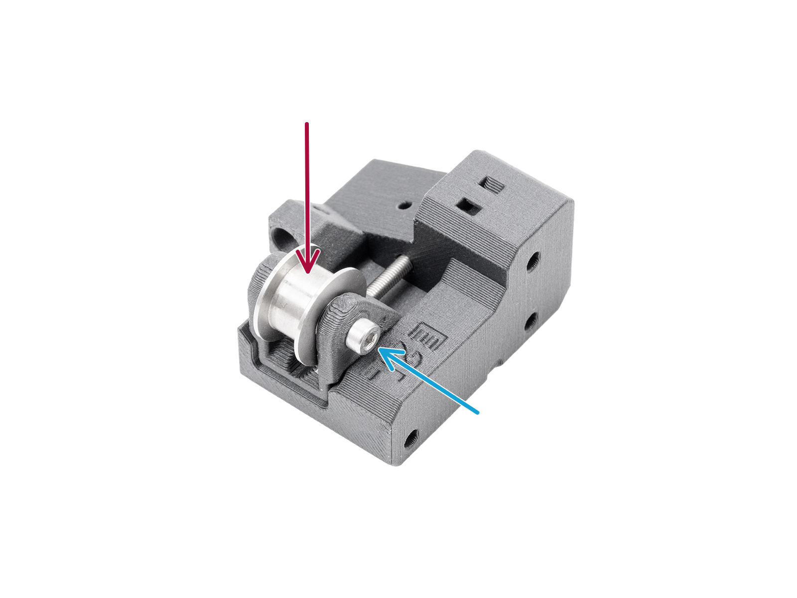

What about using some PVC, rubber or other slightly elastic plastic tube on the screw going through the idler in the tensioner? That with blue arrow pointing at it here:
Should be quite easy to test.

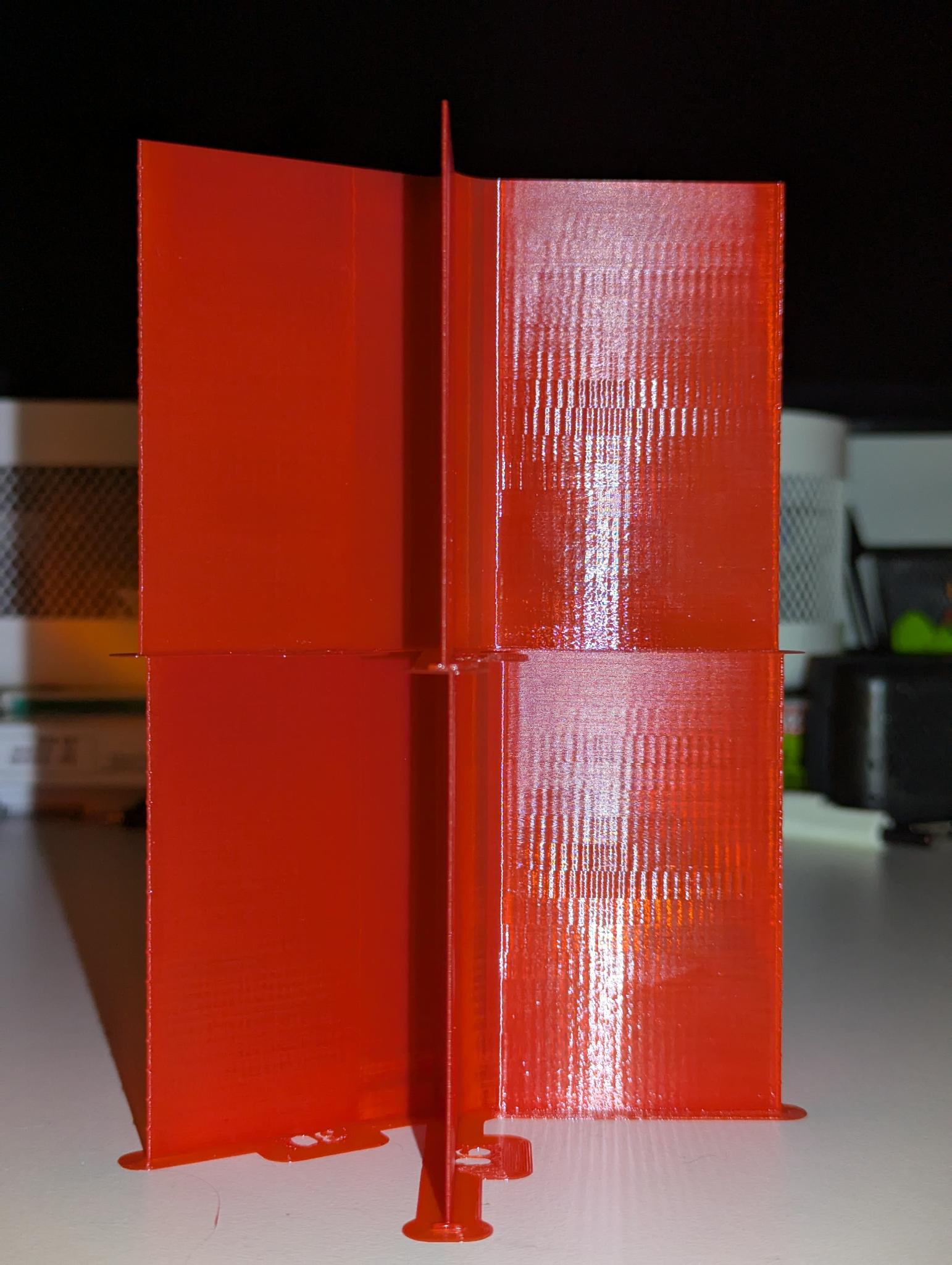

I did the phase stepping calibration five times and got the following X/Y reduction percentages: 69/77, 35/34, 39/45, 41/46, 64/44. With the last calibration I printed the VFA test (top without, bottom with calibration). The printer is definitely a bit quieter and the print seems to have improved slightly. The calibration still seems to produce lots of variance in results, so I'm not sure how effective it is for my motors.
