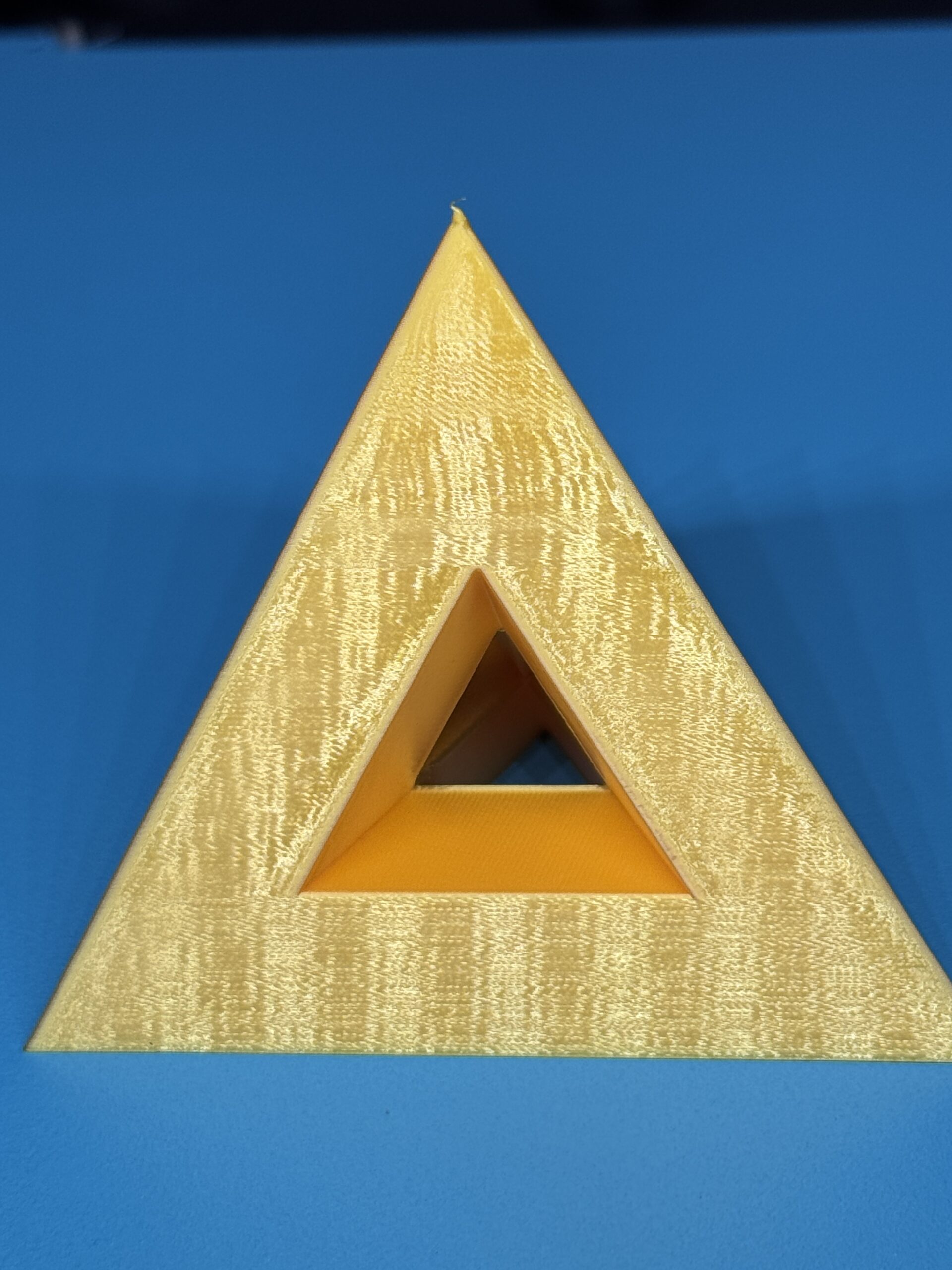

So I set a minimum layer time of 0s, to disable that setting, and sure enough the print is clean all the way up.
Thanks for the tests! I'm gonna swap to 1.5 belts too in the near future.
Just picking up on this part: If you can be bothered, Orca Slicer has a feature "don't slow down for outside walls".
This makes everything else print slower, until the minimum layer time is achieved, but then does the external perimeters at normal speed.
It also has an additional printing order from what I've read, but I didn't compare them yet.

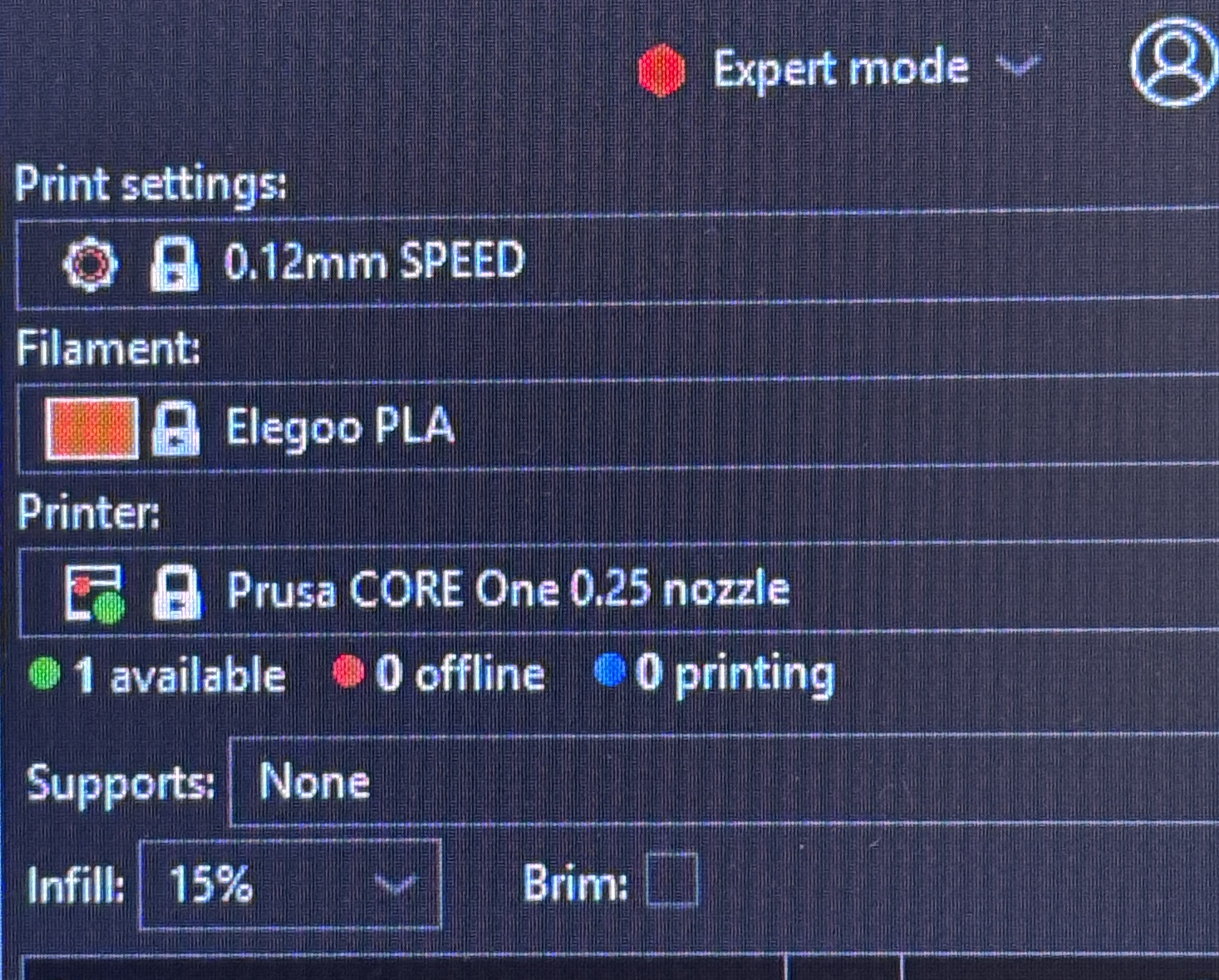

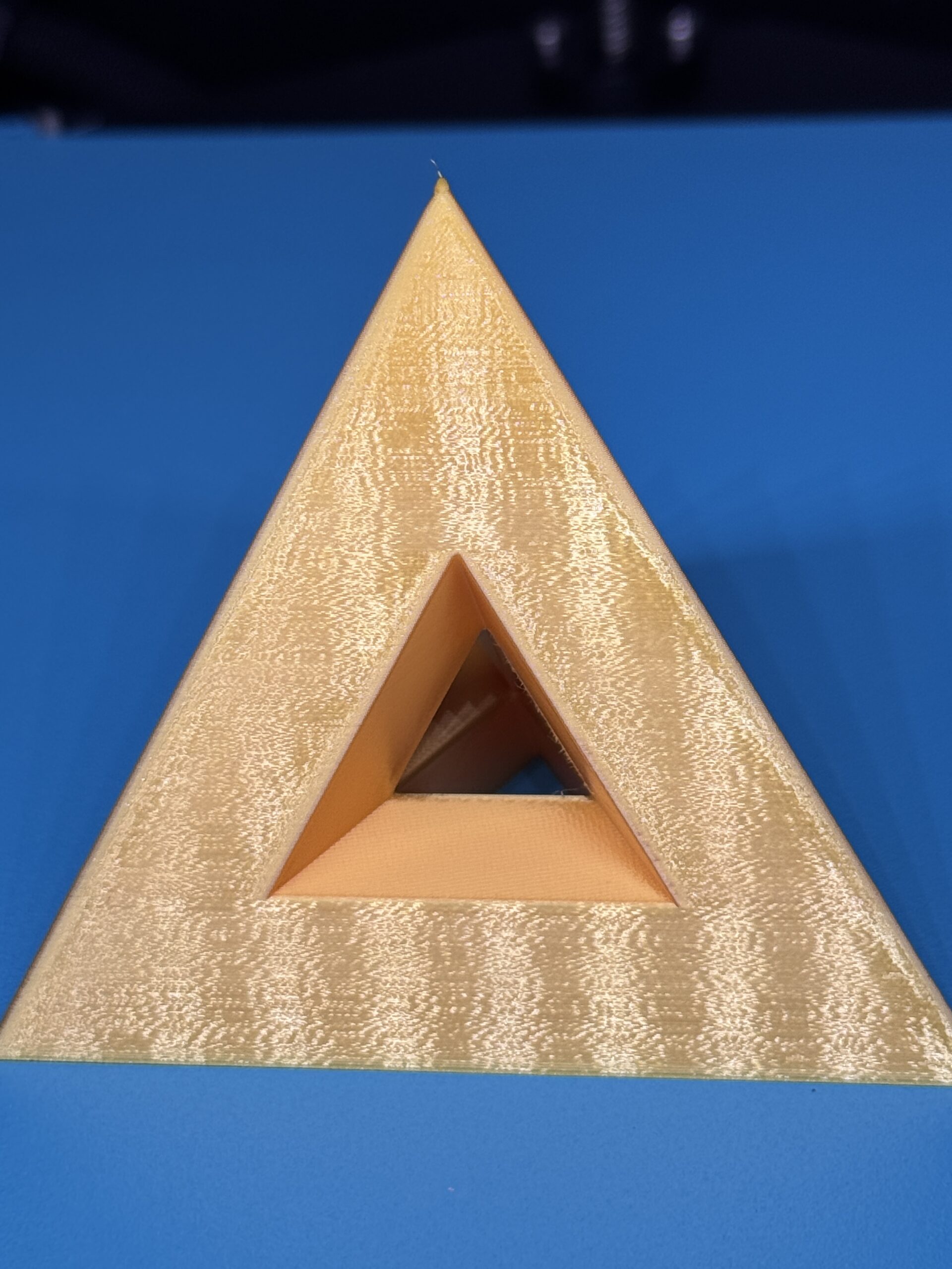

Prusa built core one. 0.12 MM speed setting, elegoo silk PLA, 0.25mm nozzle:

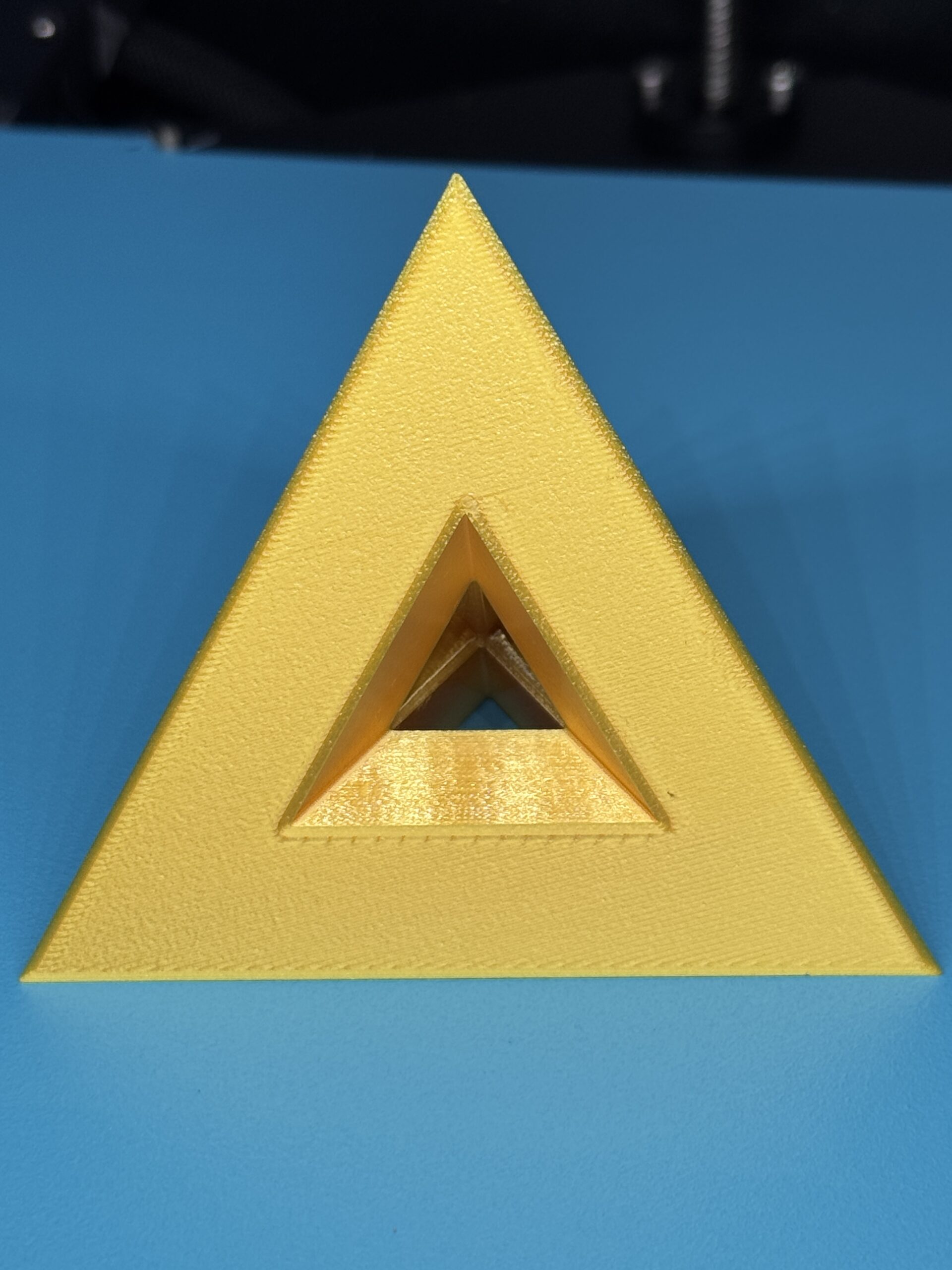

Great work Chris! Glad you printed my G-code box examples to see the comparison vs mine in the OP. Good improvement.
It sounds like belt pulley engagement is the root cause - 2mm seems worse than 1.5mm. Belt idlers seems to be a red herring that everyone keeps trying and failing to get results with.
As mentioned previously in the thread, there is a case of someone using strings instead of belts and getting VFA on their Voron CoreXY, but these must be motor induced artifacts rather than the string.
