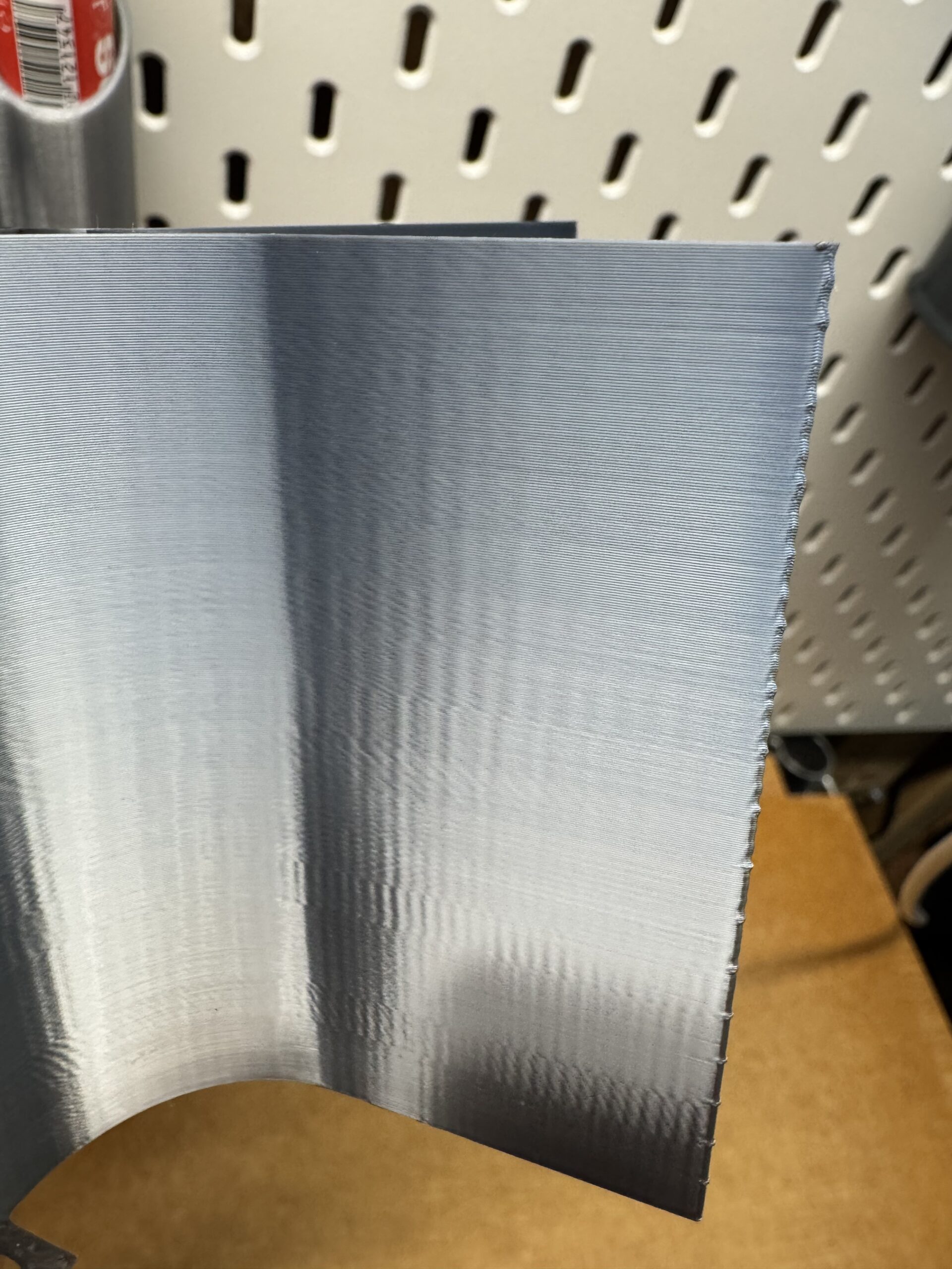

I have 2x Gates pullies that I installed in mine (immediately upon build of my conversion kit - I never used the Prusa ones in it). Reason I had two? I had terrible artifacts on my MK4S Y axis, and as part of an overhaul of it to try to fix them w/ a model someone posted, I bought the pulley and a spare. It immediately fixed my issues, so I went ahead and put both in the Core One. I've got some shiny silk PLA I'll print a VFA test with later tonight.

Not really sure how to read this, but here we go.

Posted by: @aaron-11
Have you run phase stepping calibration? The second picture shows a similar pattern to an image I saw on the GitHub phase stepping issue.
Posted : 06/06/2025 9:22 am
SgtCaffran
(@sgtcaffran)
Any context on what image represents what? Would it be possible to make a photo in the exact same orientation and light?
