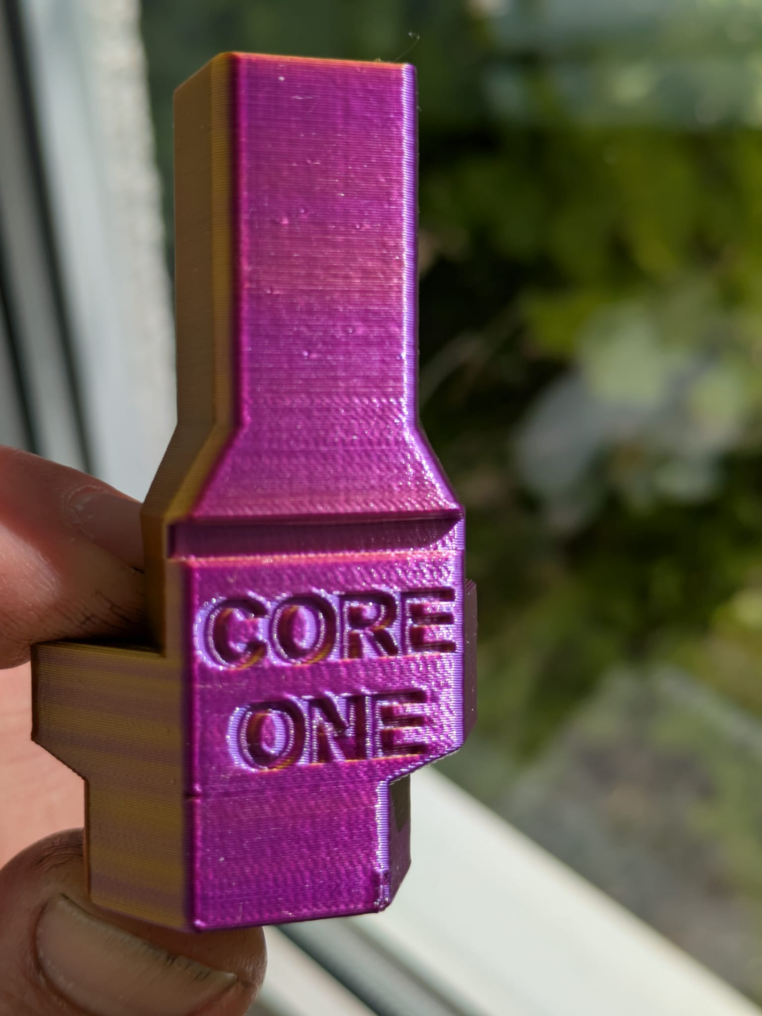

Since someone posted pictures of this print, here are some for comparison.
The glossiest filament I have right now, with the standard 0.2 Speed ​​Pla_Silk profile in the Orca Slicer. The only change is the outer walls to 45mm, and no slower outer walls if the layer time is exceeded.
I took the pictures so that they look as bad as possible in terms of light. In real life, the part looks really good. And to be honest, I could have made the pictures look that way, too 😉
A slightly different angle to the light and the image would look just as good.
In my opinion, you can't expect more from an FDM printer.
Posted : 29/05/2025 9:39 am

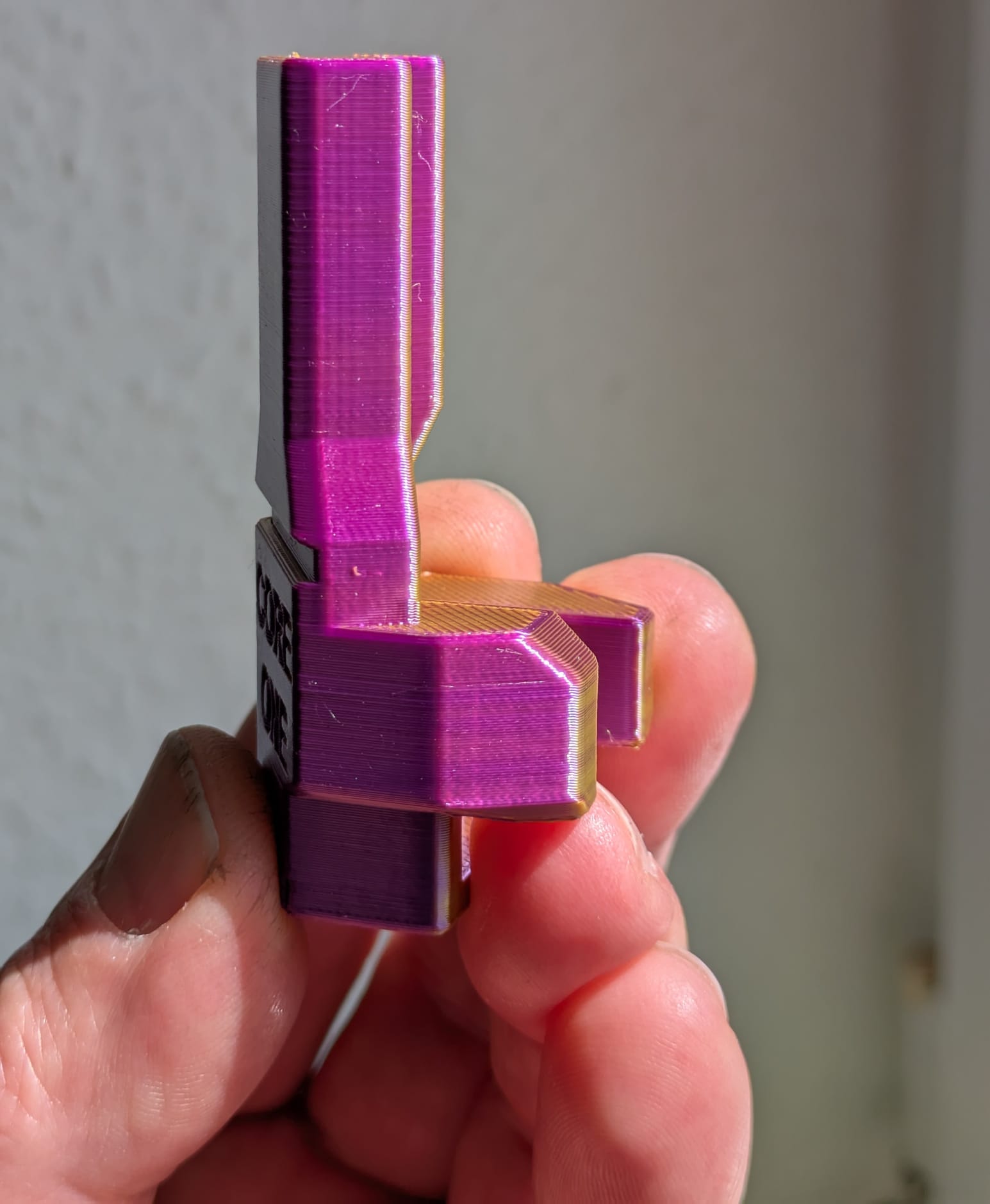

Page
 Page
(@page)
Here is I hope better picture. It is just perfect for me.
Posted : 29/05/2025 9:49 am
