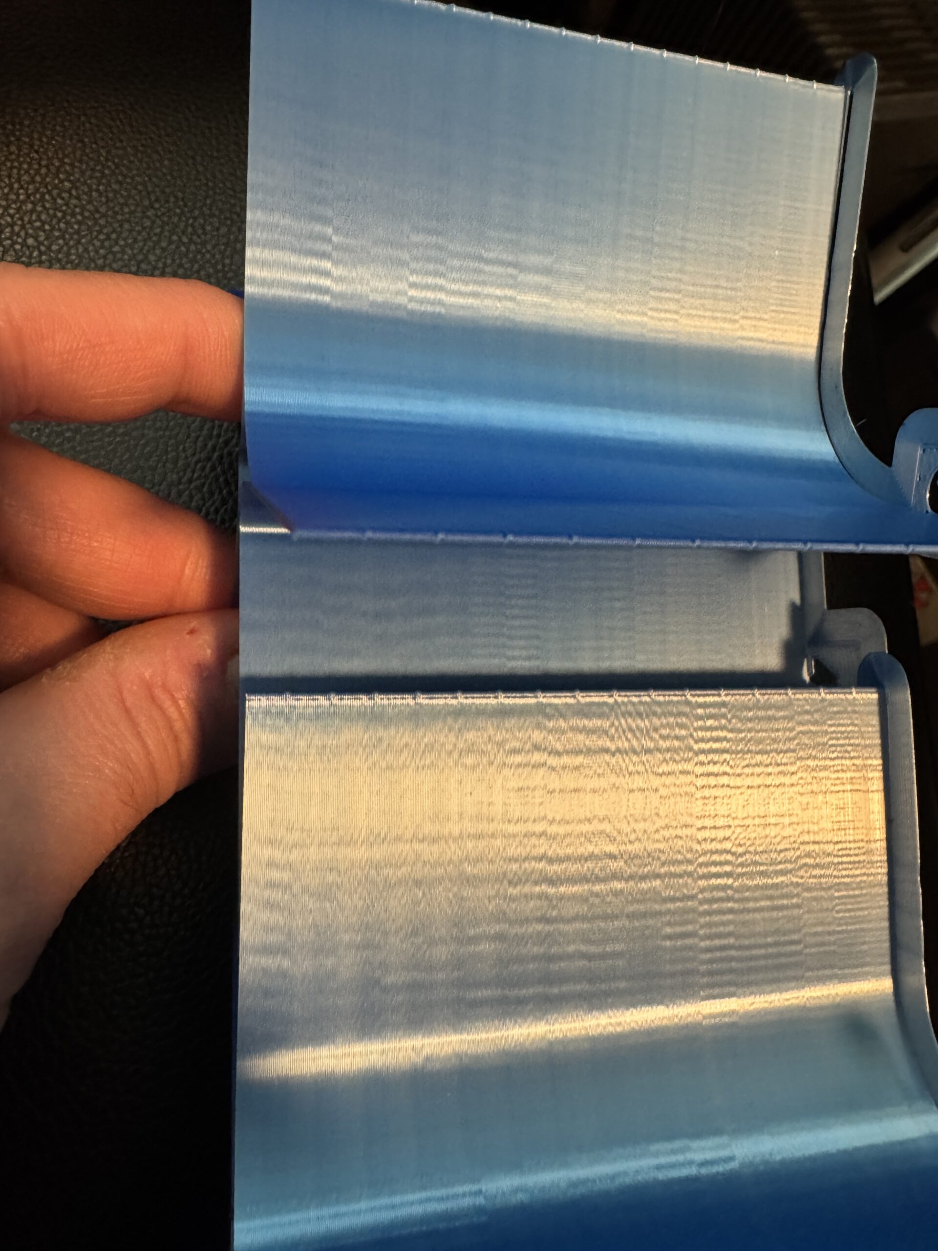

pjs37
(@pjs37)
I am giving this a shot now and printing the VFA test to see the results.  I am at about 103hz on each belt now from 85 so I am curious to see if there will be any difference in the prints.
Posted : 10/05/2025 4:30 pm
pjs37
(@pjs37)
The top is 103hz belt and the bottom is 85hz.  I don’t see anything that much better.  Right is slowest speed left is fastest.  Granted this is silk filament but I think it’s a good way to show it. I used this model for both tests. https://www.printables.com/model/1189256-vfa-test-prusa-core-one
Posted : 10/05/2025 5:27 pm
Brian
(@brian-12)
I think the top definitely looks better.  Not gone, but better.
