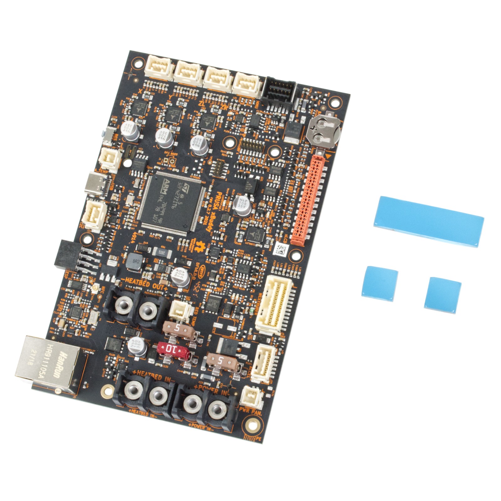

True. But I am pretty sure it's not the additional text for the menu item, but the execution of the calibration algorithm which causes the "out of memory" crash. It's another instance where I wish Prusa had not prioritized MK4S compatibility, and had rather given the Core One a more powerful main board. Fingers crossed that they figure out a software workaround quickly!
Posted : 01/04/2025 4:43 pm
Kachidoki
(@kachidoki)
The xBuddy board was and is still a very powerful board to drive a 3D printer. When I remember how far they were able to push the old 8-bit board, it was awesome. I hope they could do the same with the xBuddy.
The fact is that it was a Prusa choice to not embed a Linux platform with plenty of compute power/flash/ram on their printers. This is true for the motion controller, but to handle all the connectivity, webserver and UI it would have been a better choice to delegate this to a real computer platform. Maybe they will come to it one day and our printer will take a minute or so to boot up and .bgcode will be uploaded in no time to compensate. 😆 In the meanwhile they need to make their common platform profitable.
Posted : 01/04/2025 5:59 pm
3 people liked
altaic
(@altaic)
I wonder why it works on the XL and not the Core One. And it looks like it's now enabled on the MK4 as well, apparently without memory issues. They all use the same STM32F427ZIT6 microcontroller (see xBuddy pic and XLBuddy pic).
Posted : 01/04/2025 9:45 pm
Posted by: @kachidoki
The STM32 they use is powerful for a motion controller (although the phase stepping calibration is now apparently pushing it to its limits in that area too). But it's not up to the task regarding the Ethernet/WiFi connection. Requiring a camera with its own separate WiFi connection is a kludge in my book.
Posted by: @altaic
Is it really enabled in the MK4? I never saw VFA or noise complaints for that printer. Maybe the shorter belts reduce the risk of belt resonances, so you don't need the extra-smooth (and compensated/calibrated) motor control via phase stepping?
It might be the 0.9° stepper motors which require larger sampling rates, longer sample records or whatever during the calibration, exceeding the available memory? But that theory would only make sense if neither the Core One nor the MK4 can use phase stepping at the moment.
Posted : 01/04/2025 10:04 pm
altaic
(@altaic)
It appears to be enabled on the MK4, see commits:
Not sure why or what would cause the OOM on only the Core One. However I did notice that they completely rewrote `phase_stepping/calibration.cpp`. It looks pretty fancy now, but I guess there's a bug in there, perhaps triggering a stack overflow since it uses a recursive search. Didn't have time to give it a thorough look over, though.
