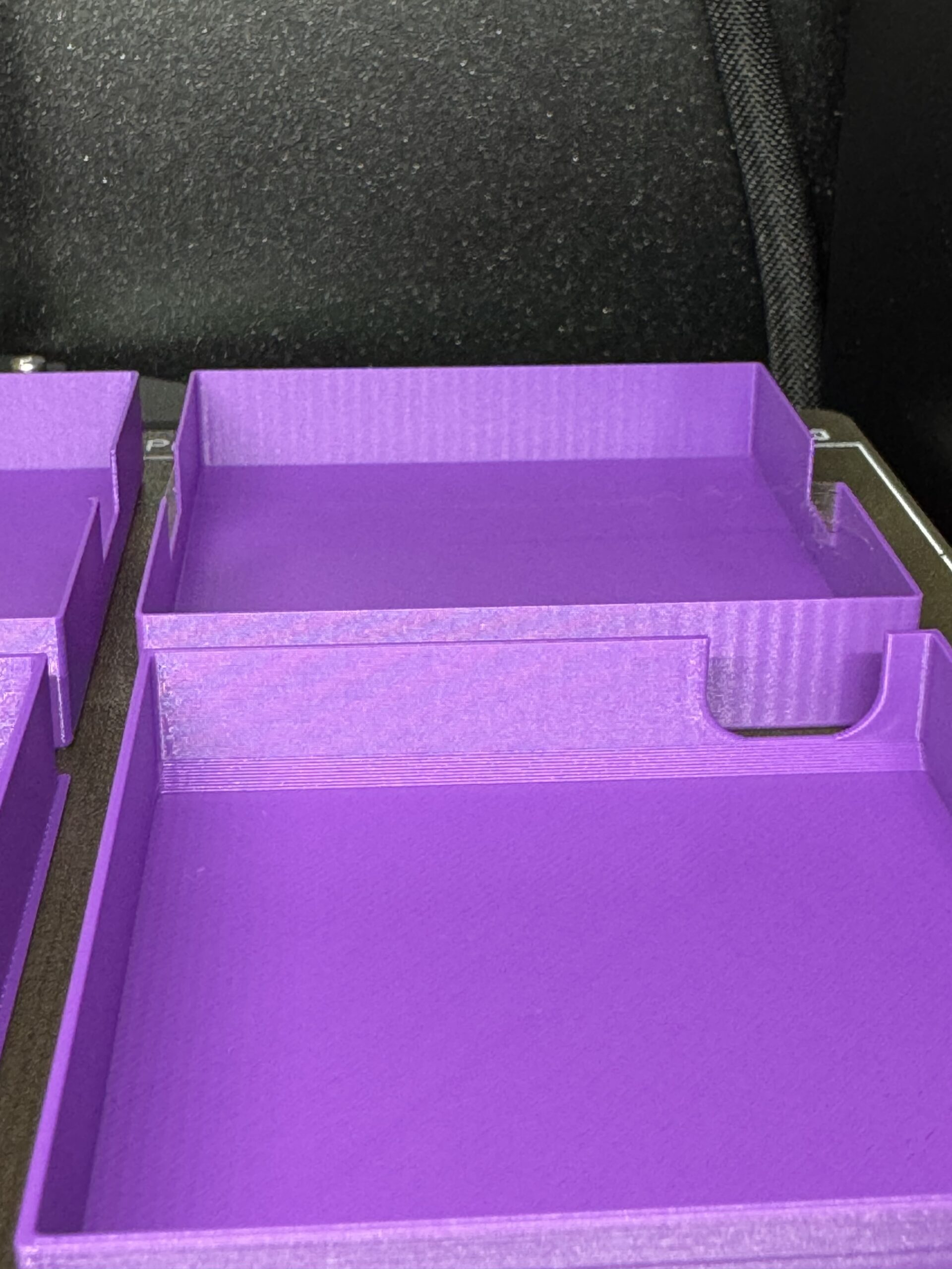

I get really bad VFA's too. I thought I would post it here. It is only on certain travel speeds, but they seemed to be used on most outer walls. The print quality is terrible compared with the MK3s/Mk4s. The VFA's seem to be linked with the loud travel movements / vibrations.

Thanks for this reply and photo this is exactly the same problem I am seeing in my original post and it is making me think it is more of a fundamental issue with the machine.

So I took a look at some prints under a microscope to try to determine what is causing the visual artifacts we are seeing.  Looking at the side walls I wasn't able to see much likely due to the way the cylindrical layer lines reflect light differently at different angles.  I made a new print and increased the number of perimeters until there was no infill.  This also led to the print being printed without top layer(s) so I could directly observe the perimeters from the top.  Since the top of the perimeters are squished down some they are easier to visualize.  After printing I could visibly see the same VFAs on the top of the print as the side walls.  They are the same frequency and in phase with the side wall VFAs so I am fairly confident they are produced by the same effect.  Here are some pictures of the top surface:
To me it looks like the amount of filament being put down per unit area is oscillating.  Since the frequency of the VFAs vary depending on the angle of the print I think that rules out the extruder varying the amount of extruded filament.  That leaves either the print head speed oscillating around it's target speed or the height of the nozzle oscillating.  I think the former is more likely than the latter due to the way the frequency of the VFAs follow the belt speed but can't rule out the latter.
What would cause an oscillation in the print head speed?  At least I can rule out the belt teeth contacting the smooth idler because there is only one of those per belt and that particular idler will move slower during a diagonal movement compared to a pure x or y movement.  The rest of the idlers are contacting the smooth side of the belt.  However, I could see even those having some contribution as when the belt is wrapped around the idler the parts of the belt below a tooth are going to have higher strain then the parts of the belt without a tooth.  I could see that causing some oscillations in the tension of the belt as it comes on and off the idler.  It could be also variations of the speed of the stepper motor itself, but as was pointed out earlier the frequency of the VFAs are very close to the belt tooth period.  I measured the VFAs on a diagonal to have a pitch of 1.35 mm.  Most sections of the belt move sqrt(2) faster than the print head on the diagonal so that corresponds to a 1.9 mm pitch within the margin of error of the tooth pitch of 2 mm.
