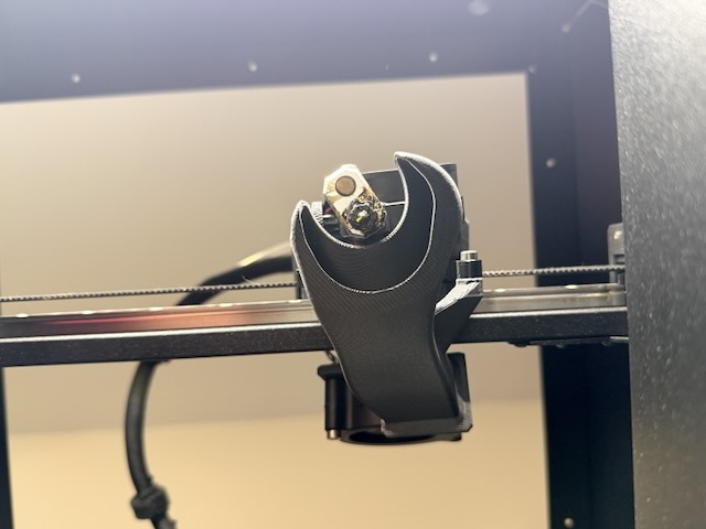

Trying to remove nozzle for the first time.
First off, this is what my original nozzle looks like. Looks like there is a lot of gunk around it. Is this normal? How do I clean it up?
Prusa Core One
Posted : 16/03/2026 4:15 pm
RE: Trying to remove nozzle for the first time.
Heat the nozzle to 290C and clean it with a brass brush.
Posted : 16/03/2026 4:28 pm
miroslav.h4
(@miroslav-h4)
If you are not using a silicone cover, this is quite normal. You can heat the block and try to clean it with a brass brush. Place the nozzle replacement tool on the on the cooled block (if you don't have one, look for it on printables) to fix the block, loosen both side screws on the Nextruder cooler and use a 7mm wrench to loosen and unscrew the nozzle. Or you can disconnect the relevant cables on the love board, and after loosening the side screws on the cooler, remove the nozzle and the heating block.
@miroslav.h4 and @ hyiger - I was using a silicone sock. I took it off after my 7mm socket wasn't engaging the nozzle to get a better look at the nozzle. I will try the heating and brass brush method @hyiger recommends. See what happens.
Anyone know how this buildup happens? I used it only with a silicone sock and also cleaned it between prints with a brass brush. (I bought the Prusa brass brush, too).
Some filament residue always gets caught on the nozzle and slowly creeps up and under the silicone. There's nothing you can do about it except clean it. And if you use the nozzle replacement tool, always remove the silicone and use the correct version of the tool. Without silicone, the heating block holds better in the tool. And if you brush it with reasonable force, you can't damage anything.

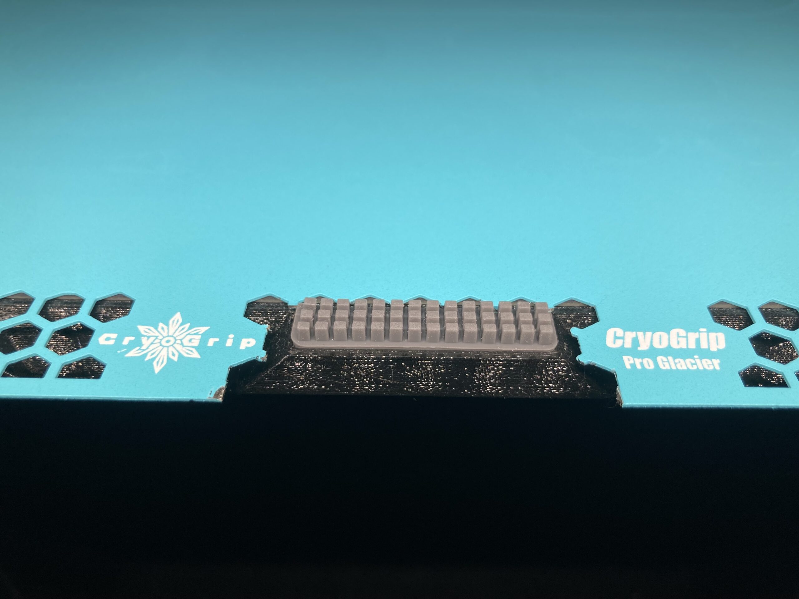

which nozzle wiper mod do you recommend? There are many and IDK which one is a good one. Thanks

Posted by: @phil-15
Depends on what build plates you use. If you use the ones from BIQU then you need one that is compatible with the sheet. If you only  use the Prusa sheets then pick anyone you like. This is what I use: https://www.printables.com/model/1416818-core-one-universal-nozzle-wiper-left-or-right-side (which happens to be designed by me)
Posted by: @hyiger
Posted by: @phil-15
And if you're using https://www.printables.com/model/1452284-core-one-stealthbrush-for-the-inner-monk-of-clean you can still use it with the BIQU. You just have to take wire cutters to it:
