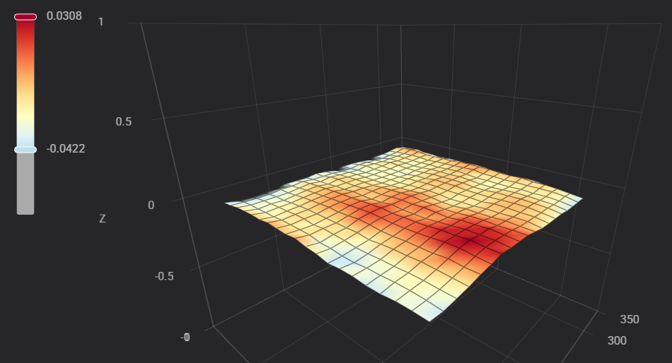

baatbyggeren
(@baatbyggeren)
RE: OctoPrint bed visualizer gcode
Thanks, that works! My plan was to print some of these and see if I can level it further. https://www.printables.com/model/1289015-prusa-core-one-bedlevel-correction-dust-cover/comments
Here's the initial results:
Posted : 22/05/2025 10:29 am
baatbyggeren
(@baatbyggeren)
That's better! I put a 0.4mm shim on the left front rod.
Posted : 22/05/2025 12:12 pm

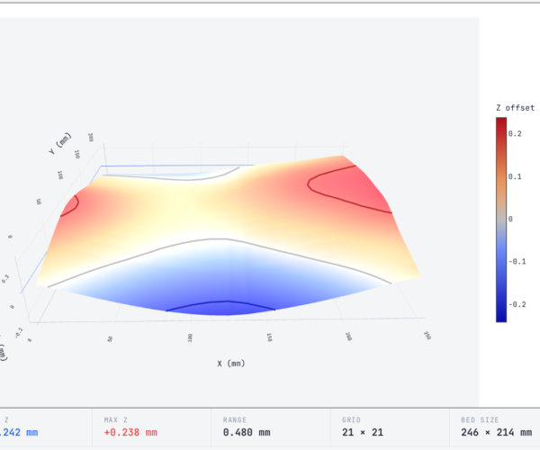

Wejn
 Wejn
(@wejn)
Btw, using that tool I went from:
to:
Still not ideal, but seems better 🙂
Posted : 21/03/2026 1:25 pm

Wejn
 Wejn
(@wejn)
Posted by: @mnentwig
Whether the tool is accurate is another question. There may be systematic error. 400 µm peak-to-peak would be visible with plain eye, I don't believe it. Have you checked with a simple ruler?
I just checked with a carpenter square (only thing I had available) and there's significant play that matches the contour of the bed reported by the "G29 T". I have no way of measuring the actual size now, but at least direction matches well, and it definitely is a fraction of a mm...
