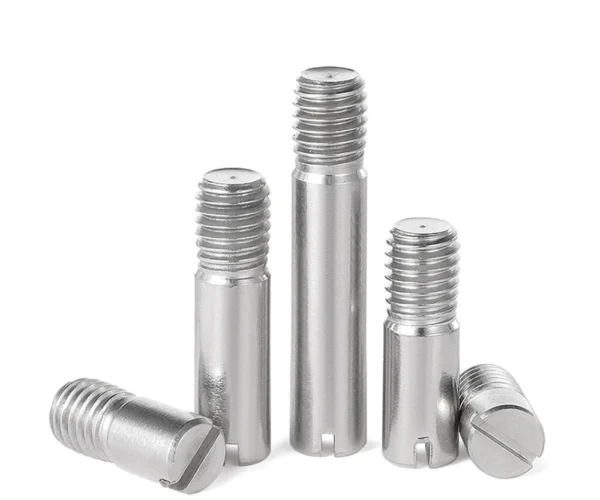

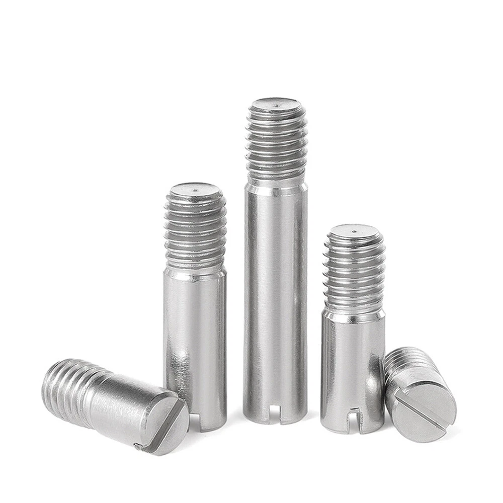

@abmantis, it's interesting you're hearing it also, but on the top belt. And I think you might be on to something re: it being a pulley. I wonder if it's a pulley "clicking" over a thread on the M3 bolt that's used the pin.
I was thinking of swapping out the M3 bolts for M3 dowels/pins with threaded ends. Would need M3x30 and M3x18 I believe.
Something like:
https://www.amazon.com.au/Stainless-Slotted-Cylindrical-External-M3/dp/B0B7S4R2B7?th=1

Could be. Skates use that type of screws to hold the bearings too. It can also be some bad bearing (or just dirt in it).
I hope I don't have to, but if the noise gets worse over time I will probably disassemble the motor part to take out the bearings and check them individually.

TLDR; Rattle noise is completely gone after replacing idler pulley bearings and using proper 3mm threaded dowel pins.
So I reached out to Prusa support and they very promptly sent me two replacement pulleys. However, both of them also had bad/notchy bearings!? Interestingly, they both also looked used (witness marks on the pulley surface). I didn't bother contacting support again, and decided to source my own bearings.
I completely replaced all pulley bearings and pins with these APE ABEC-9 693ZZ bearings, and 3mm slotted/threaded dowel pins (4x30mm and 8x18mm). Pressing out/in the bearings from the pulleys was very easy.
The difference was huge. Print head motion is much smoother and quieter now. I'd be very curious what others find from the inexpensive mod.
