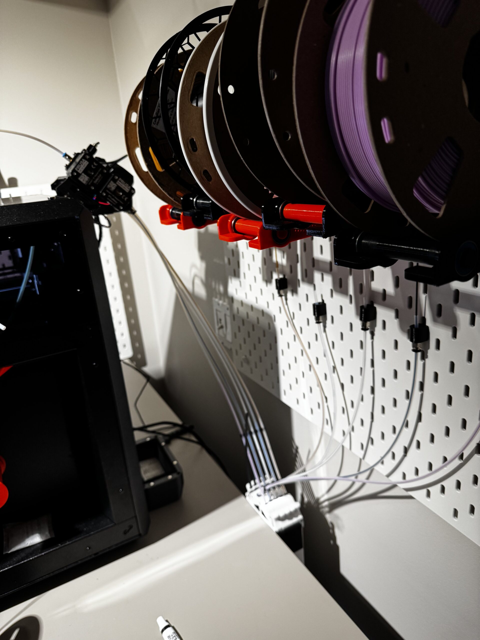

Rolf
 Rolf
(@rolf-7)
RE: MMU3 on Core One Attempt
Thanks for sharing the gcode, my Core One now runs with MMU3 as well.
That's the mounting solution i came up with as i'm using the stock mmu3: https://www.printables.com/model/1281631-prusa-mmu3-core-one-frame-holder
Are you using the stock buffer solution?
The filament has already become tangled in mine.
Due to the long tube between the MMU and the print head (~480mm), the filament protrudes too far back in the buffer.
As a result, one filament has gotten wrapped between another when being fed in and blocked it.
Apart from that, the first attempts went without a problem.

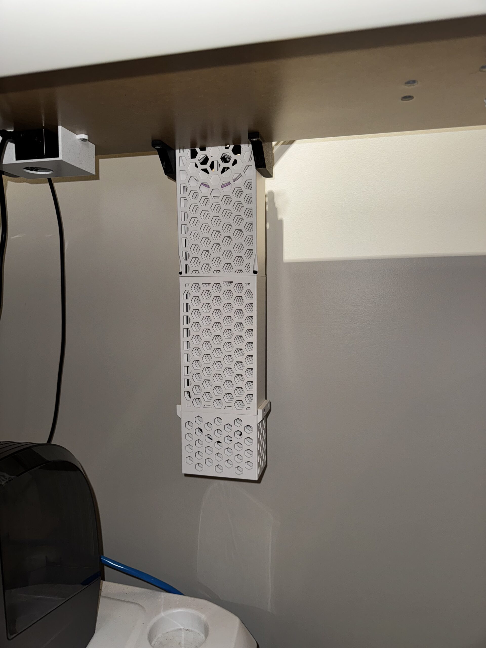

I got my MMU fully working now in COREBOXX with filament rewinders that use the back drive power from the MMU motor.
Had to reprogram the MMU registers, but havee not had a single buffering tangle or error since.
I am struggling however with getting a good filament tip to form. They always seem to be flat/ almost hollow, and curved to 1 side slightly.
Any tips?

Rolf
 Rolf
(@rolf-7)
Yesterday I did my first multicolor prints (two colors, PETG) with the HF nozzle (I was too lazy to change it). Not a single problem, even if the tips weren't so pretty. The quality of the print was also great and I was impressed.
