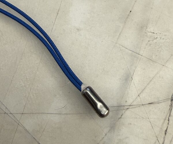

There seems to be a quality issue with the hotend thermistors - mine failed after 40h. Resistance infinite. The grub screw was extremely tight and I was unable to take the thermistor out. Got a new hotend - thermistor DOA, this time I was able to take the thermistor out of the hotend, but still the grub screw has left a significant dent.
I guess someone is a bit overmotivated....
Hot End NTC with dent Hot End NTC with dent

Mine too went faulty after a couple of months. Was reading around 500 ohms, support sent out a new one which works fine. Being curious I noticed that when held at a certain angle the faulty one would read ok...the wires from the actual thermistor are ridiculously thin single copper strand..so it's no surprise that they break. Mine must've been just holding on by a tiny amount of copper for the resistance to read so high.
Need to be extremely careful anytime you're taking the hotend out for any reason.
