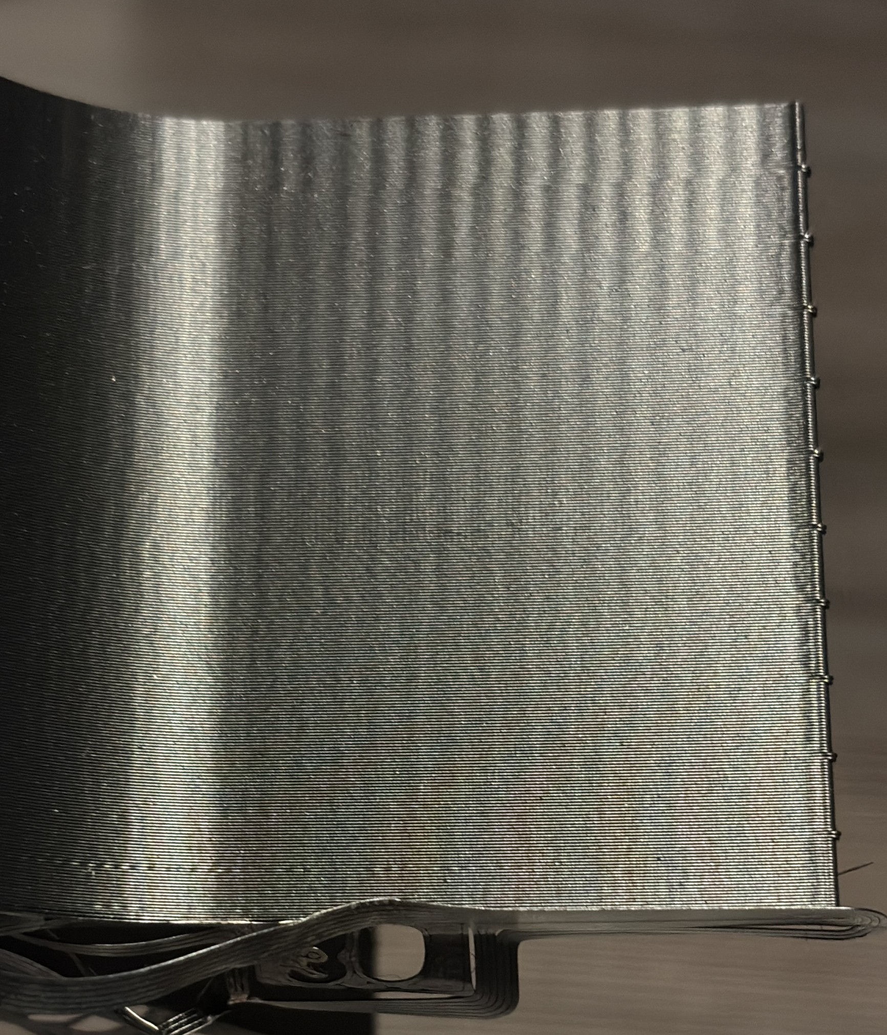

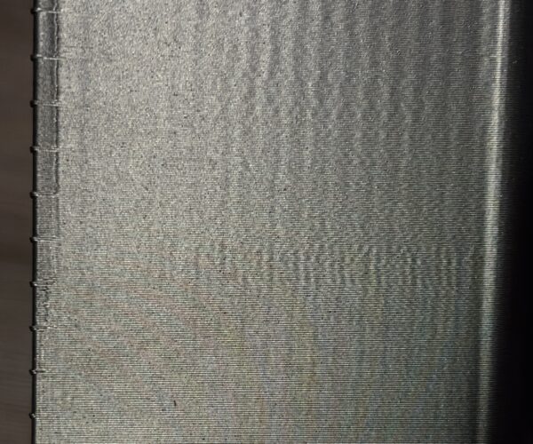

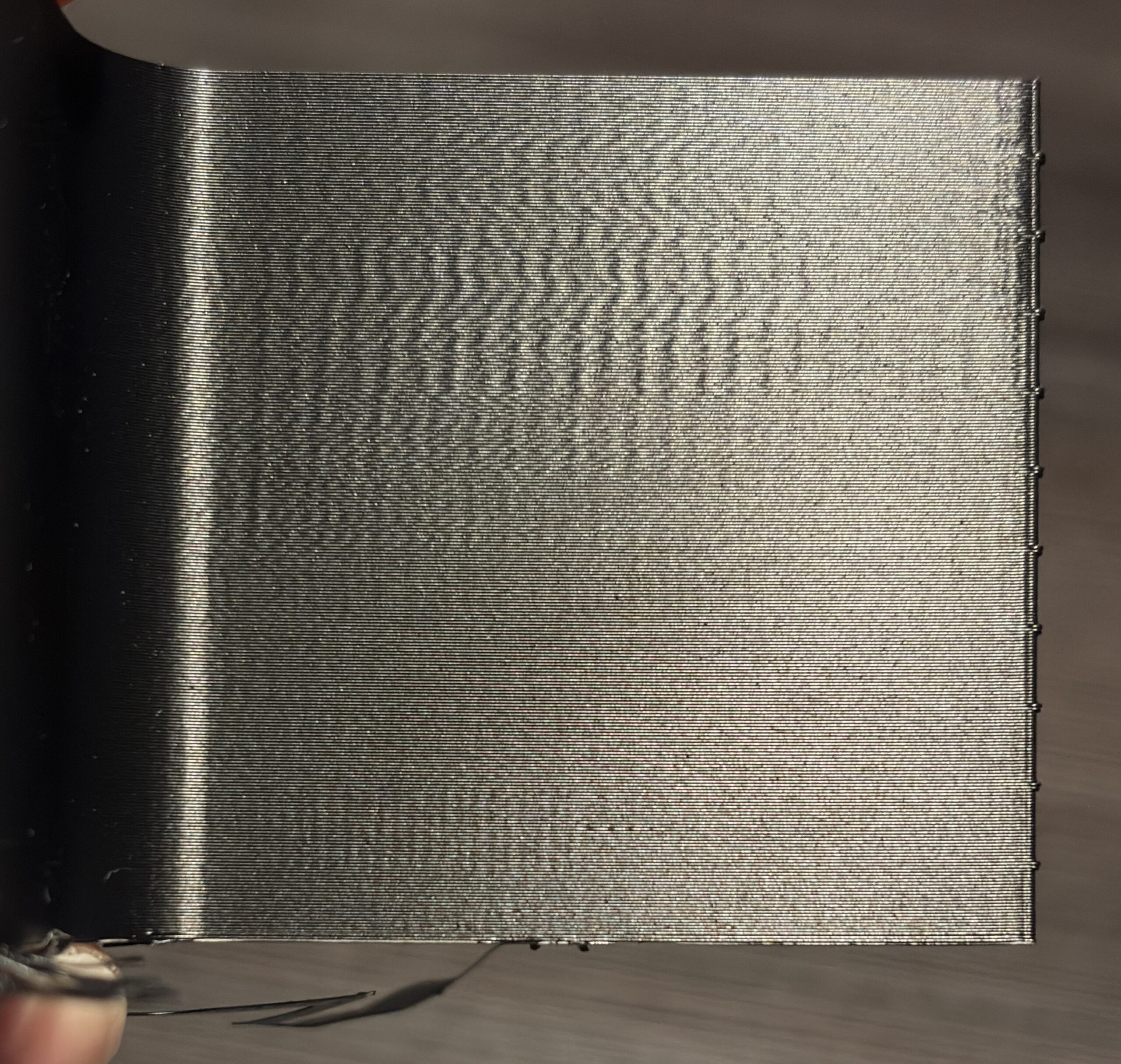

Now I'm going to take a VFA test.
Yesterday, I conducted another VFA test with the two slide bearings.
PETG Black from Bambu Lab. I will have a glossy PETG available for testing again tomorrow. I believe it is still evident that the waves have not improved significantly.
As has already been mentioned here several times, the wave spacing is exactly the same as the tooth spacing of the GT2 pulley. Nice to see at the 30-degree test week.
My VFA test ranged from 50 to 150 mm/s in 10 mm/s increments.
Front and back - 90 degrees
Front and back - 0 degrees
Front and back - 30 degrees
Front - 60 degrees
Posted : 17/02/2026 7:29 am
