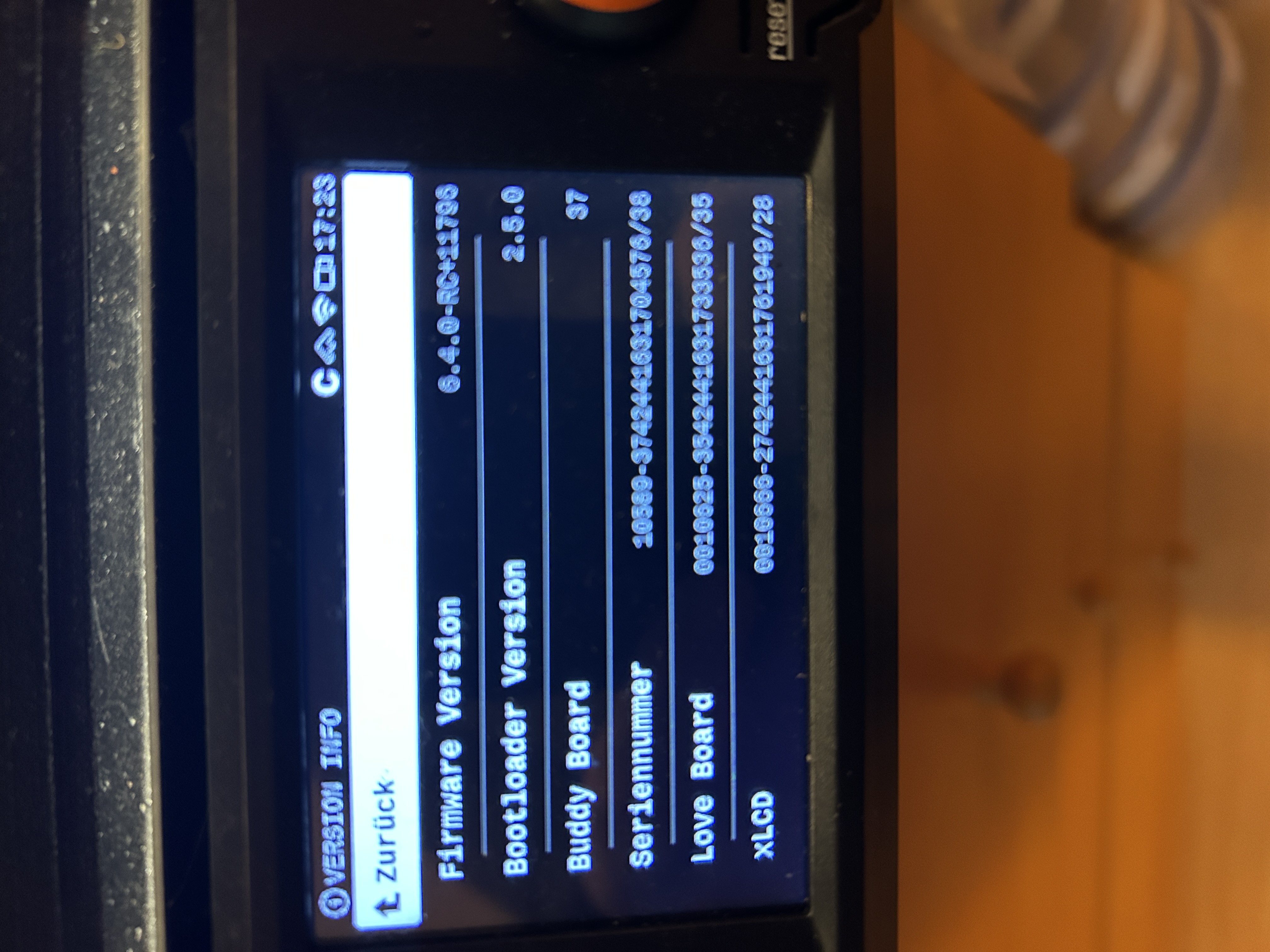

Hi. The last day I experienced my first blue screen. I printed two jobs wich took about 5 and 7 hours each.
each time the print finished but than the printer beeped constantly and showed a blue screen with some „marlin error“
I have my motors grounded, so that should not be the reason.
I printed a testpiece in 1 hour and it did fine. I than only altered one setting. I reduced the perimeter speed to the point where the print would take 8 hours. And after that I had the blue again.
Also varied the hight. But the longer prints course the error. Regardless of the height
latest slicer version. And happened with latest alpha an RC fw.
(Right now I’m printing 4 , 8 and 9 hour prints to see were it fails.)
any ideas ?
thanks

BTW are you running the latest firmware? The screen reads 6.4.0-alpha+11774 but I'd expect "RC" for the latest "release candidate" version.
Just double-checking (you wrote  >>And happened with latest alpha an RC fw.)
A stable released version might be a safer bet...
Posted : 11/10/2025 2:05 pm
Ckobar
(@ckobar)
RE: Core one crash After longer print. BSOD (not a ground issue)
yes. its on RC too.

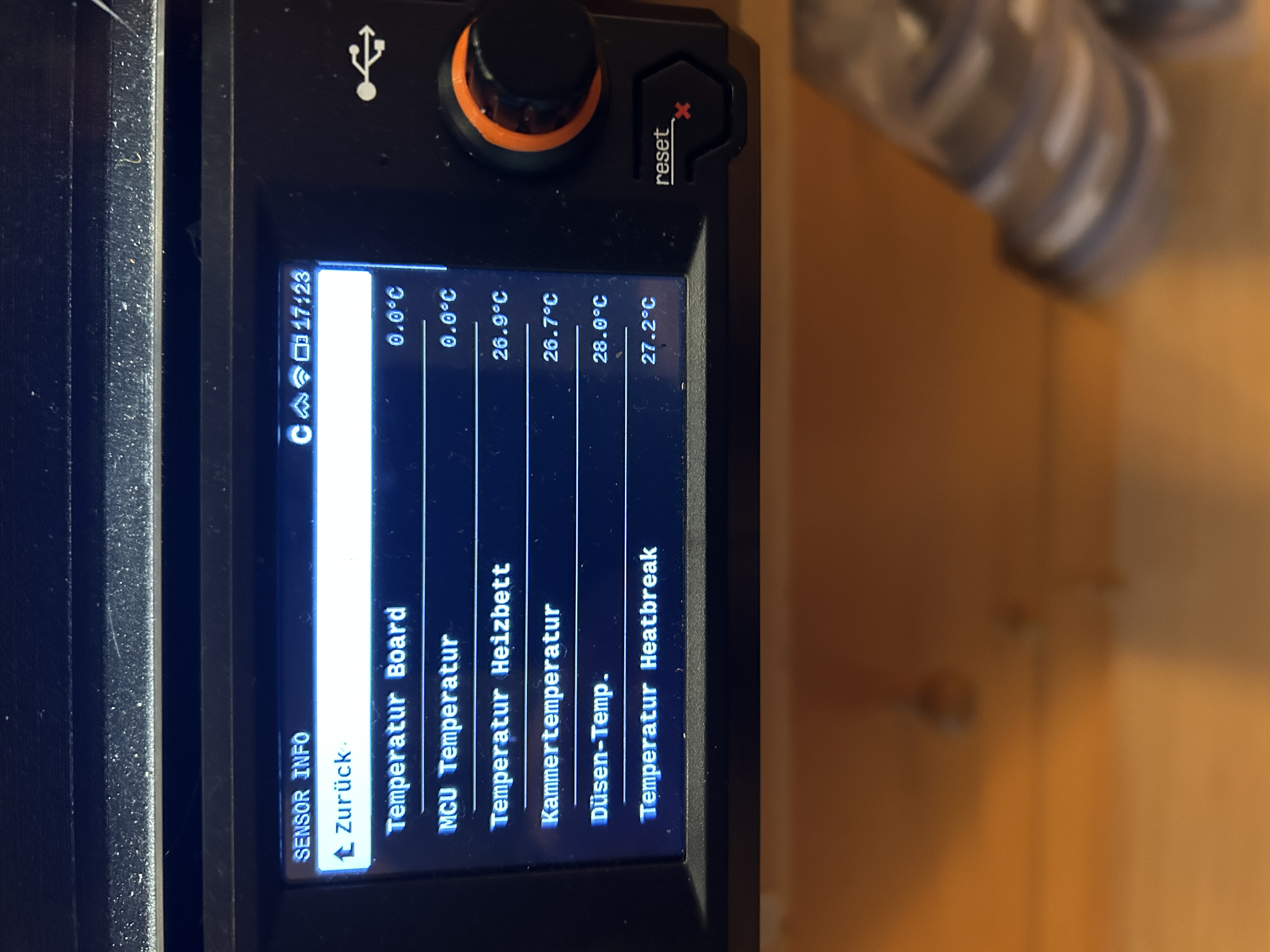

btw. just saw, that on alpha and RC the board and MCU temp are not shown anymore under Sensorinfo. (works under 6.3)
Do you see the same ?
Posted : 12/10/2025 3:35 pm
mnentwig
(@mnentwig)
Same for me, 0.0 degrees. That's a bug... I wonder whether that is related e.g. if an overtemperature condition was never spotted, lacking sensor readings...
Posted by: @mnentwig
I should show 6.4.0-RC at the top of the screen. If not then the firmware didn't install.

@hyiger. To satisfy you 🙂
I tested the temp-bug with all latest 4 fw-versions.( quite easy via connect btw)
