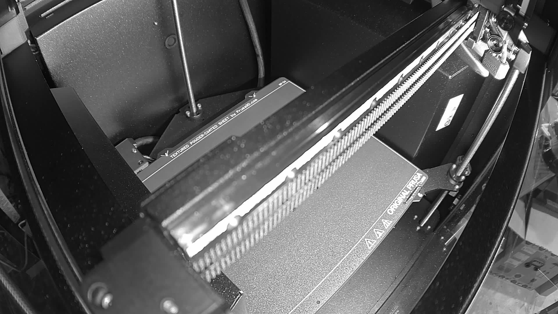

So the home position of the print head blocks the view of the finished print...... anyone know a simple way to change the head position at the end (I guess maybe modify the end gcode).  Image attached.

Make sure you're in Expert user mode in Prusaslicer, go to Printers>Custom G-code>End G-code, and look for the line
G1 X242 Y-9 F10200 ; park
Change X position to something else that works better for the camera. X0, X10 etc.

Sadly, neither account offered the correct info.  😉  The Y axis is the one that needs changing, not the X.  No offense.  As a dyslexic, I make those mistakes all the time.
Posted by: @foxrun3d

Yeah, I guess I was hoping there was a magical on-printer setting I was missing so I wouldn't have to rebuild my gcode.  I have a few things that I print all the time.  Not that big a deal.  Thanks!
For those that find it in the future, here is what worked for me:
G1 X242 Y220 F10200 ; park

So for whatever reason this still parks up front.  I've saved the edited profile, I've made sure I'm selecting it when I slice..... any help would be appreciated.
{if layer_z < max_print_height}G1 Z{z_offset+min(max_layer_z+1, max_print_height)} F720 ; Move print head up{endif}
G1 E-1 F2400 ; additional retraction
M104 S0 ; turn off temperature
M140 S0 ; turn off heatbed
M141 S0 ; disable chamber control
M107 ; turn off fan

Same here. You can see the Head is going to the new position, but half a second later it is going back to the front right. No Idea how to solve that behavior

same problem. my camera look on the printhead not on the bed after the print 🙁 i make the same entry...

The Problem is fixed with Firmware 6.3.1 and the newest CORE One Profiles in PrusaSlicer.
"Park printhead in the back after print
Based on user feedback, the printer now parks the printhead in the back after a print and during pauses to avoid obstructing the Buddy3D Camera's view.
For filament changes, the printhead still parks in the front for easier access. Homing also remains at the front due to the sheet detection process."
