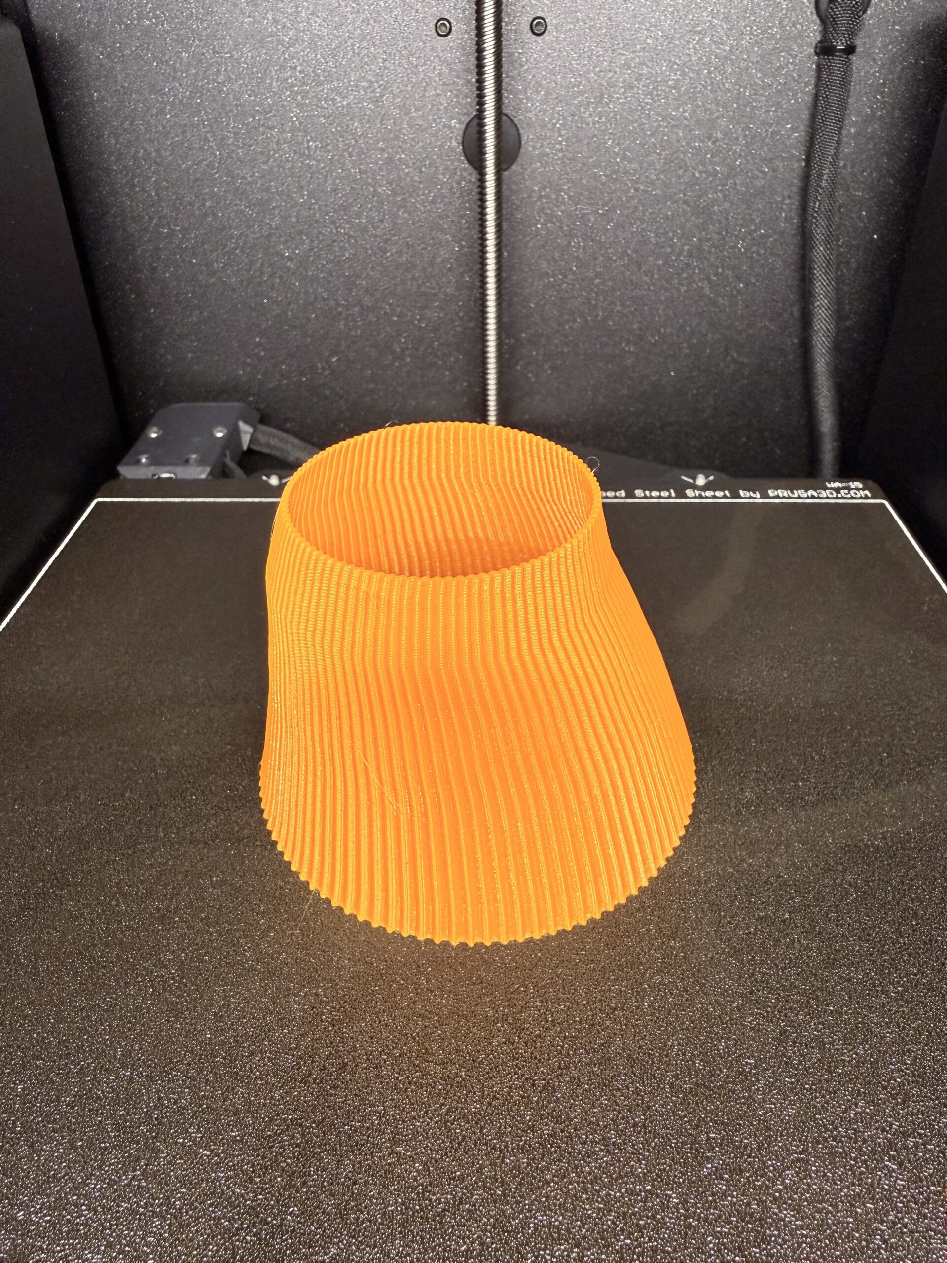

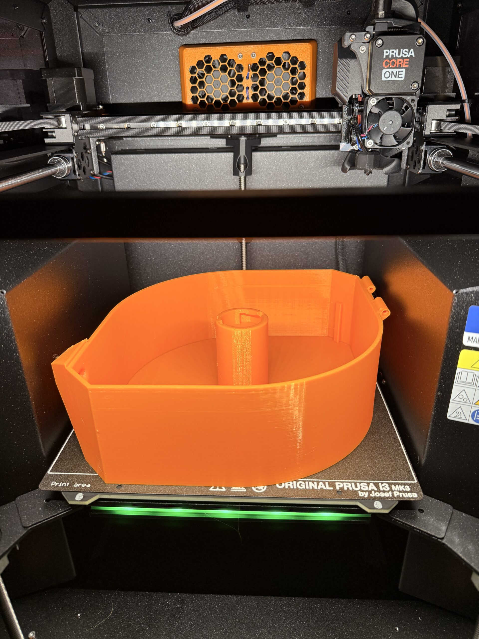

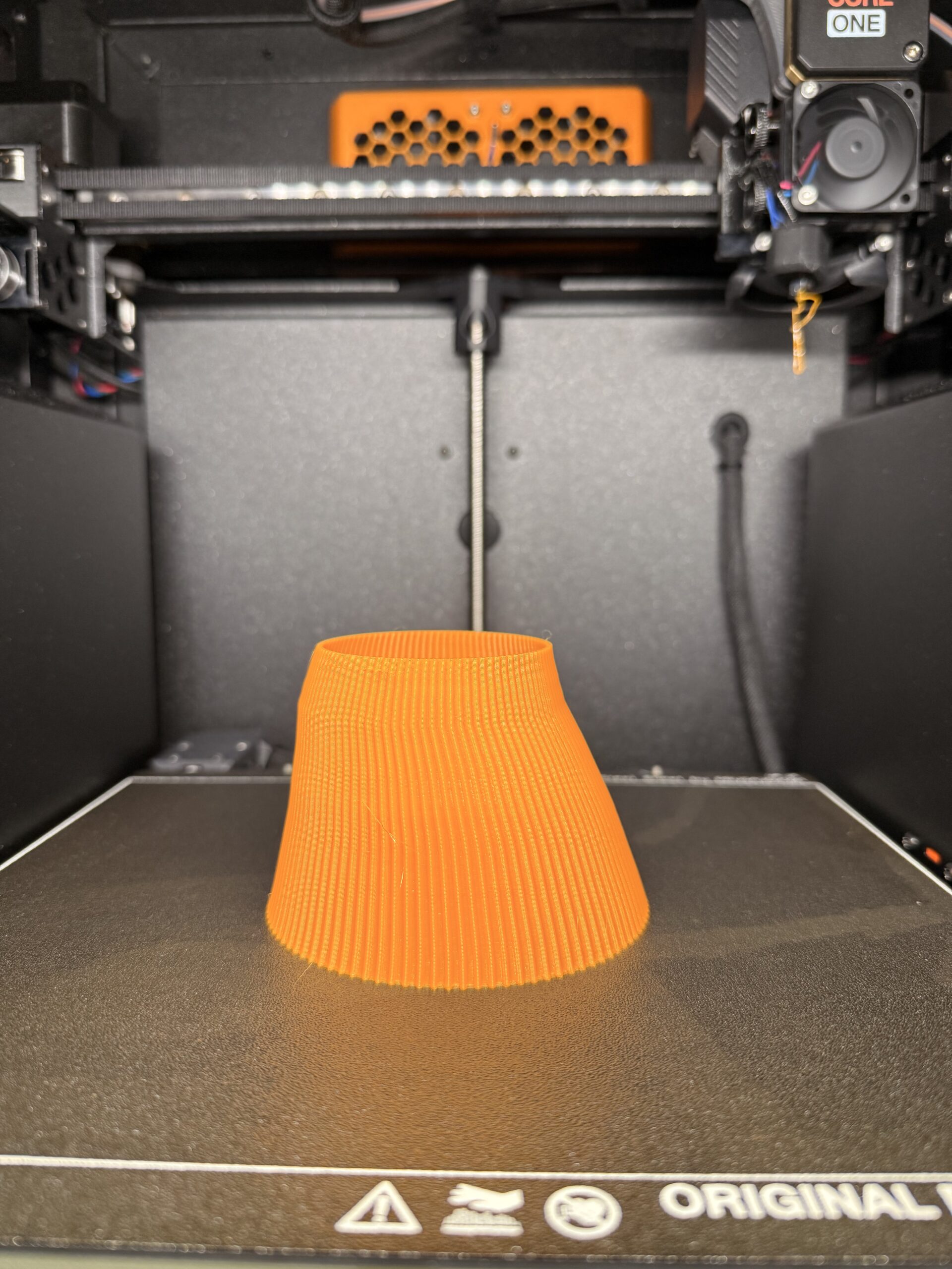

I have a very similar problem. I finished my kit assembly last week. The first prints looked great. Until I printed a lampshade (round) in vase mode. At a height of about 5 cm, the circle kept shifting.
I then printed a square, more than 20 cm high, and the print was perfect. The next morning, I adjusted the belt tension again, and the values were perfect. I then printed another square column in vase mode, and again it was great. Then I tried the lampshade again – same problem. I made the lampshade smaller – same problem. Today I printed a large filament box, almost 8 cm high, and again it was very good (for a fast print).
I have no idea what the problem is. The Core One is my third self-assembled printer after the MK3, MK4, and MK4S upgrade. I've never had a problem like this before. I'm pretty frustrated.

Initially, I had an issue with the belt tension, as the deviation between the upper and lower belts was consistently too high. Then, repeatedly, auto homing took a very long time before printing. The prints still looked OK, though. Until I printed the lampshade...
After carefully following the instructions for adjusting the belt tension, I realized that my gantry was not square! After correcting this, the belt tensions at the top and bottom were in the optimal green range (as measured by the Prusa app). However, the lampshade in the photo was printed after the gantry correction (but failed again as before the correction). Finally I printed the large filament box yesterday evening.
This morning I checked the tension again and found that both belts were a little too loose: 94Hz at the top and 86Hz at the bottom. The difference between the two belts still seems OK though. I can readjust this after work today. I'll do another test later today with a round column in vase mode (it took far too long with the lampshade).

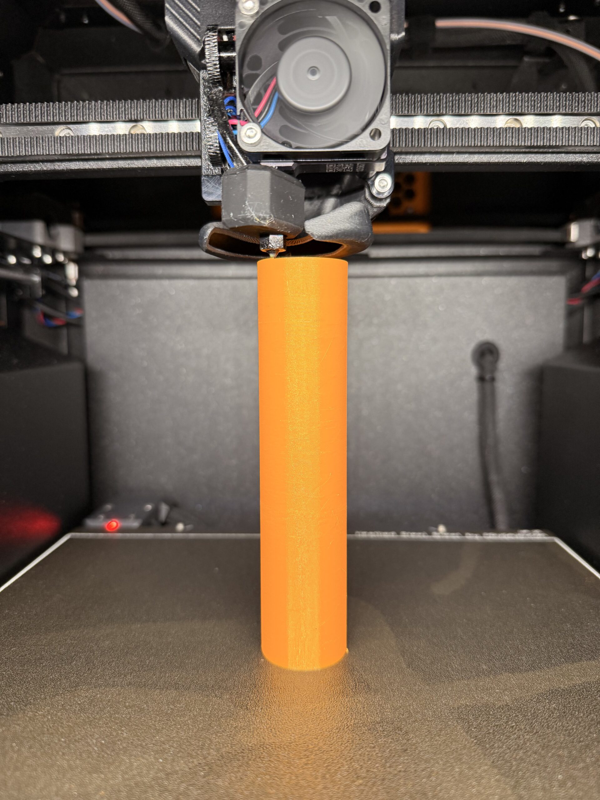

After readjusting the belt tension to 96/92Hz, I printed a column in vase mode. It looked good so far:
Then I sliced and printed the lampshade again using the same slicer settings:
This time it looks even worse... I'm going to contact support now.

Thanks for your help. I loosened the belts again. The gantry was square, I didn't have to bend anything. As described, I adjusted the belt tension once more. I have now printed a similar vase in vase mode, with a similar movement pattern, and the print was perfect. Maybe I'll print the other lampshade again tomorrow.

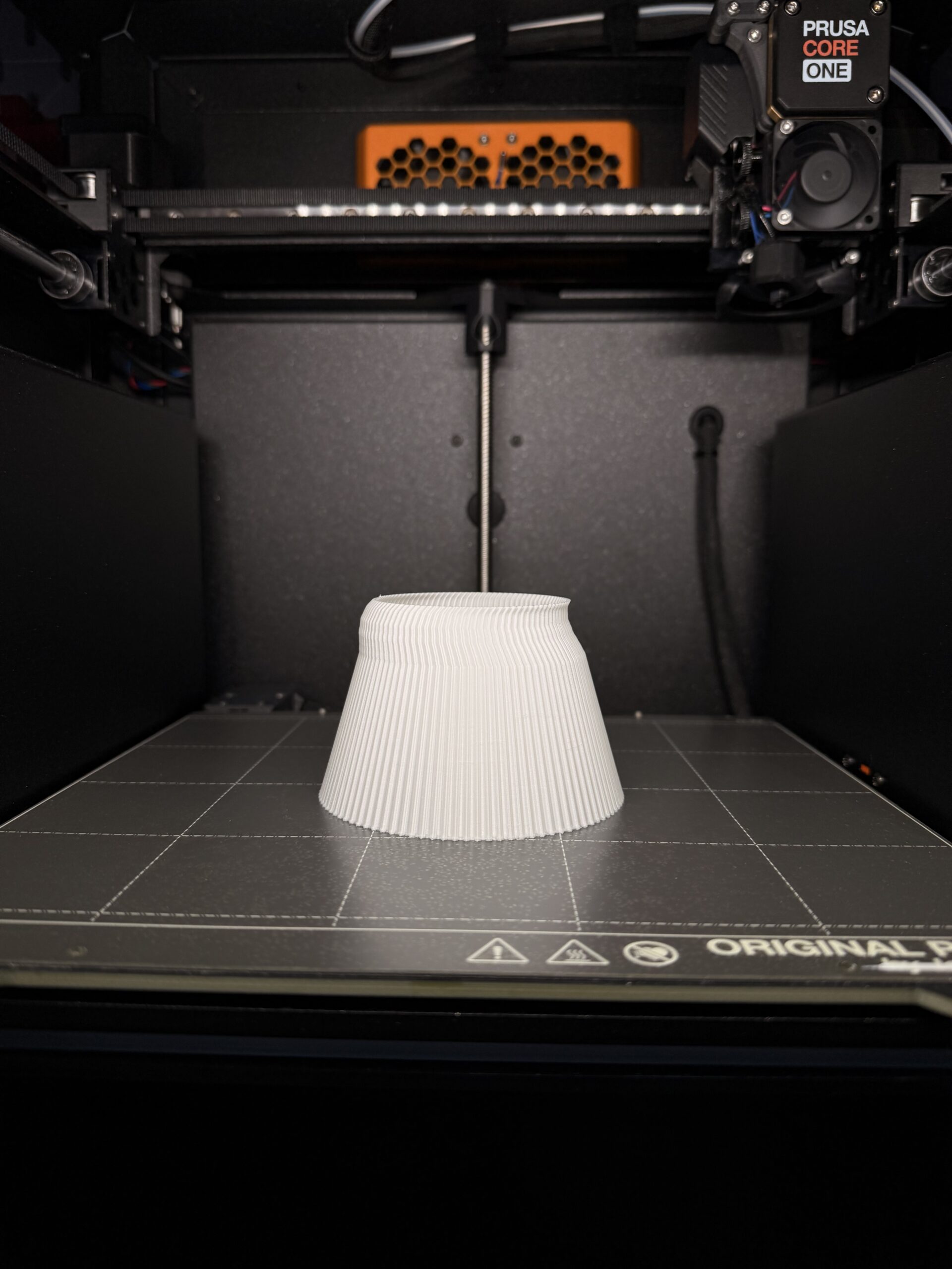

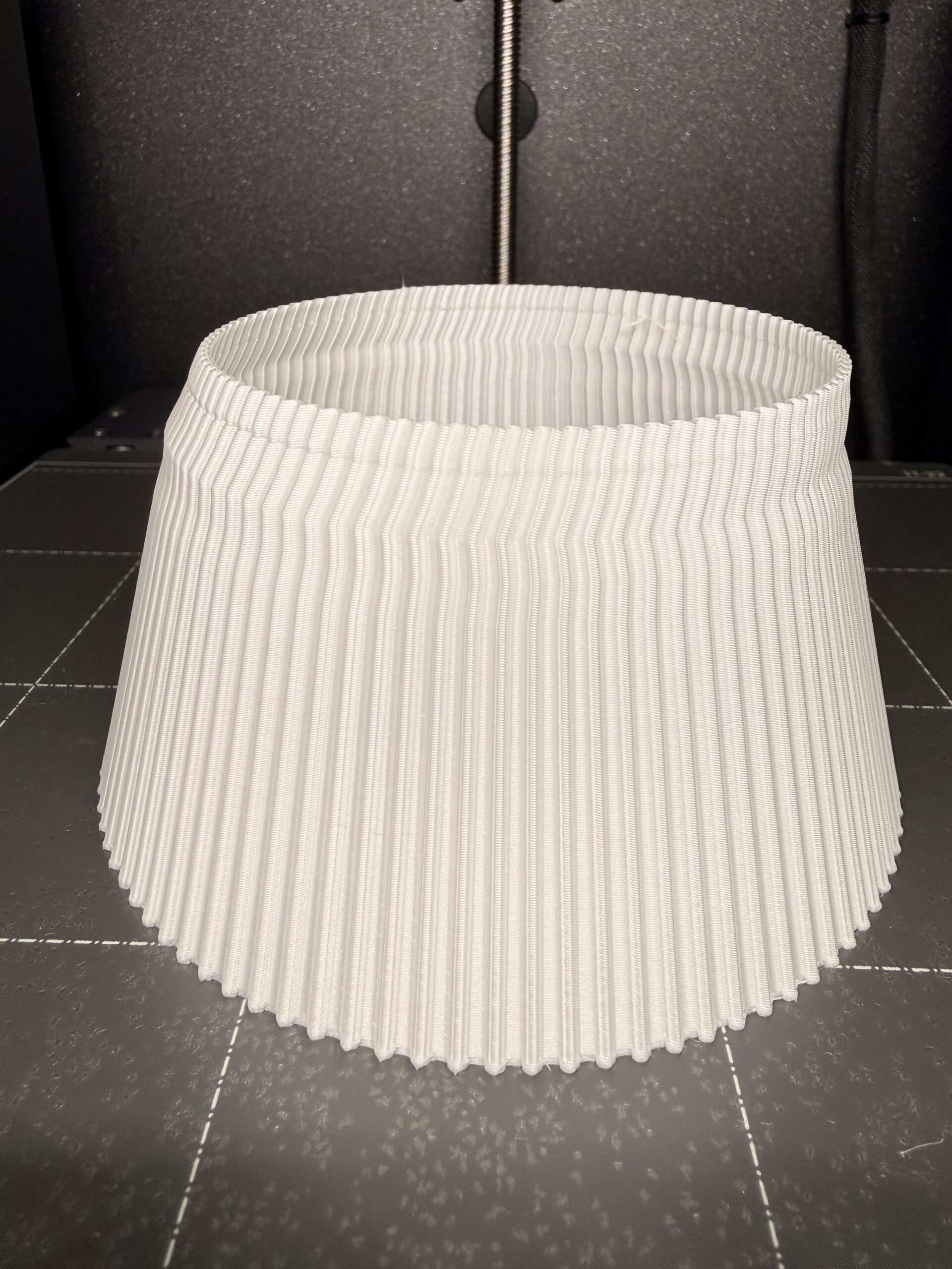

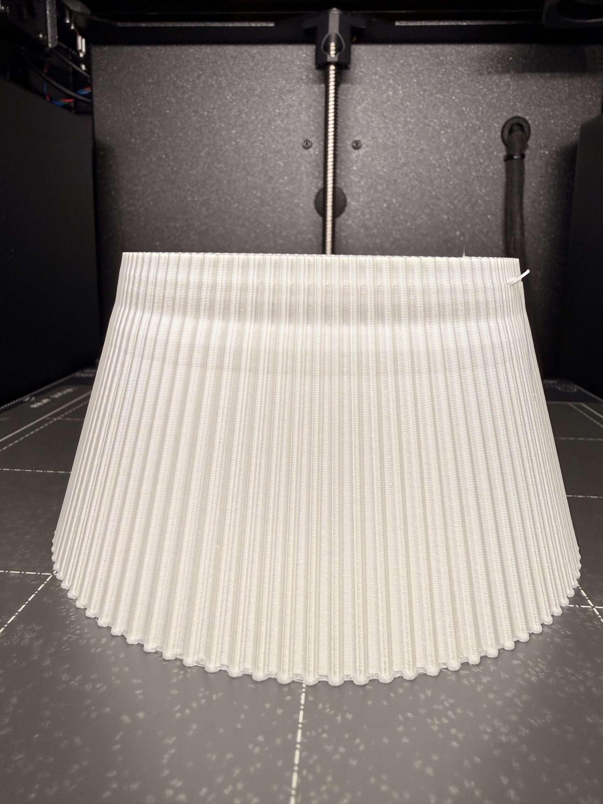

I printed the lampshade again today. It didn't work again. Basically, it always looked similar.Regardless of my settings for belt tension and gantry.
The problem starts at about 4,5cm (except yesterday with PETG, where the problem occurred much earlier). Can you even call it a layer shift? The shifts only seem to occur on the X axis. When I look at the lampshade from the side, the lines run straight up.

Lifting from the bed causing a collision with the nozzle?
That part doesnt look to have hardly any area actually holding the print to the print bed, so that’s where I’d look first.

Makes sense. Seems like maybe a print bed adhesion or perhaps a warping issue causing the print head to collide with the print?
@j-martin, could you attach a link to this lampshade you are attempting to print?

Here is a link to the lamp:
https://www.printables.com/model/1198955-lucent-lamp
I reduced the size bei 50%. Printing in vase mode.
The adhesion seems always good until the end of the print or until I stopped it. But of course there really isn't much connection to the bed.

OK, I think now it might be a bed adhesion issue. Can you try printing with a brim?

Any chance it could be correlated to the fan speed?
With PLA a change of fan speed occurs at approx 42mm:
For PETG it's much earlier:
Posted : 25/11/2025 10:24 pm

It's not a big difference but it's an interesting observation. Perhaps lower the maximum fan speed and try that as well.

Honestly, some of those images above look to be a cooling issue. Are they being printed VASE mode? If yes, then slow down your print speed and/or increase the part cooling fan; might even want to print with the door open.
