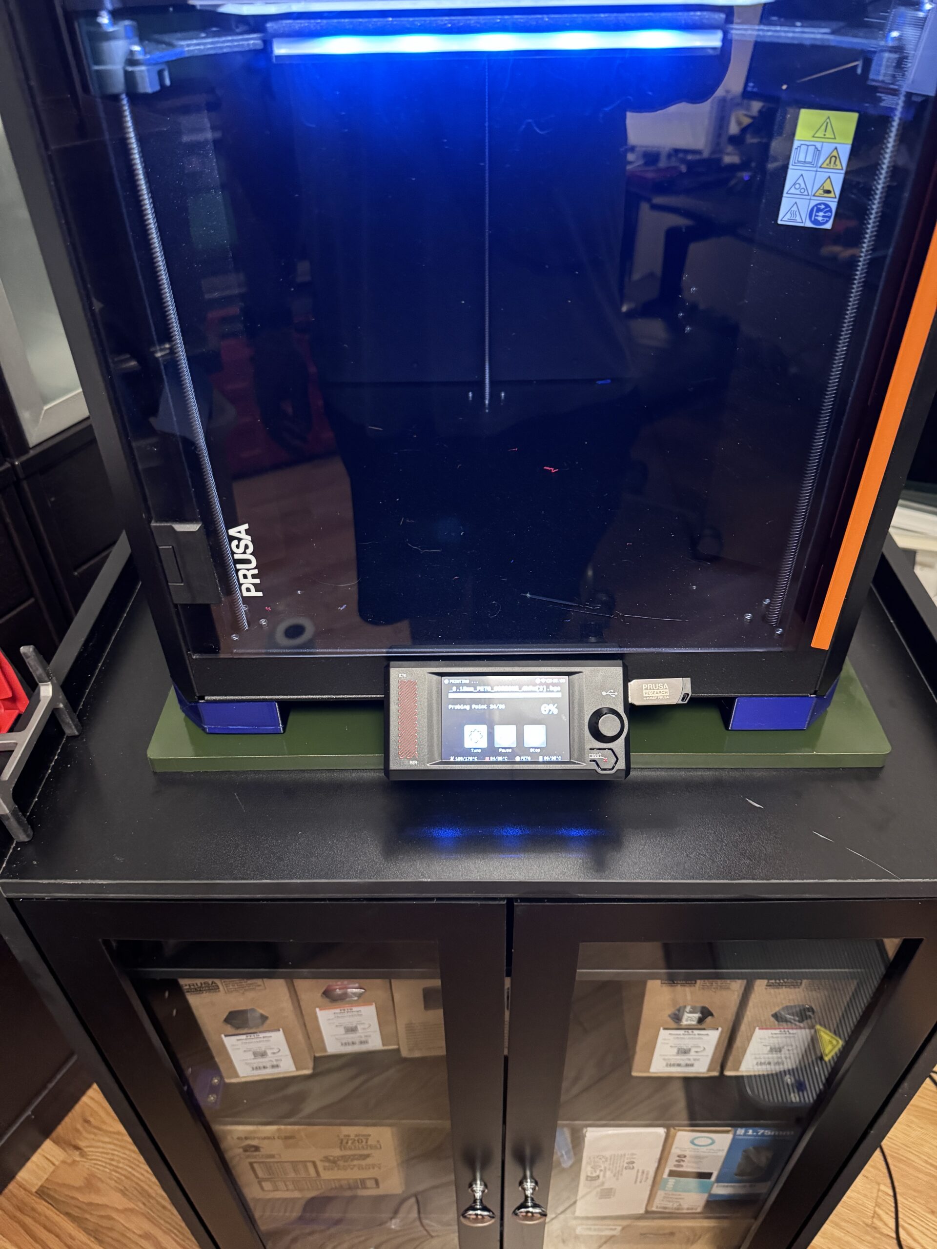

GBMaryland
(@gbmaryland)
RE: Bad Vibrations
Vibration:
I noted that printer stability was a challenge with the OEM provided rubber strips on the Core One.
I printed some feet with some TPU pads I found on Printables. Since they are installed on the four corners of the printer stability is significantly increased and general print vibration and rock is reduced.
I’ve also noticed that placing the printer on a 13mm, 460mm x 460mm steel plate adds to this stability. (Ignore the Sako green, it was all I had laying around in the shop…)
Lastly, I found that the belts had to be re-adjusted relatively soon after initially placing the printer in service. Additionally, I noticed that 90Hz was a little better than the 85Hz Prusa indicates for the core one belt adjustment.
