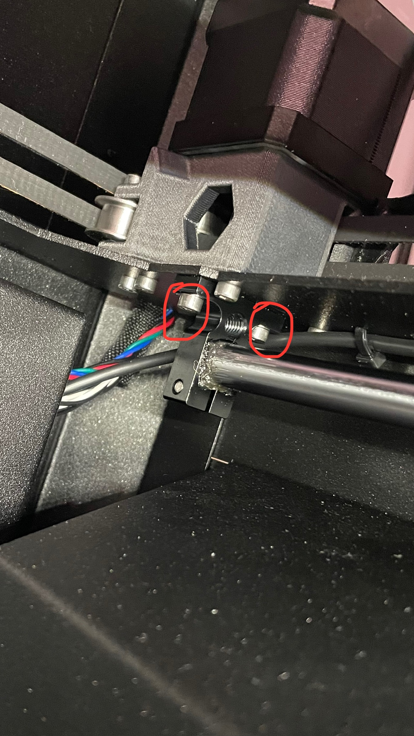

So, Core one kit, assembled now since July. Mostly happy customer. A few weeks back I broke the left belt tensioner, (too much fiddling with belt tension tbh). TLDR - since disassembling the nextruder to replace the tensioner and reassembling, I have been having a nightmare with homing. Never had a homing issue prior to this, it would do a couple bangs and move on. Now after changing filament or just before (most) prints, I get an endless loop that I generally need to reset the printer for. Calibration passes ok every time. Hoping the community might just give me some tips as to specifics I could look at following the work I did.
I have a couple more relevant details. I also changed my linear rail brackets. I always had issues with resonance noises. Between prints and when I had the time I'd try one of the many suggested fixes in the forums. Run a "noisy" print and pray... (that my wife wouldn't kill me for spending more time with the printer than her and the kids!). I systemically went through all the different tweaks that people saw varying success with in the forum. Last 2 on the list 1. changing out the linear rail brackets 2. the x y motors (don't think these are my issue). After breaking the belt tensioner I figured I may as well give the brackets a go considering I was going to have to dissemble the nextruder and reroute the belt anyway. Cheap enough parts. Gantry only ever had the tiniest misalignment (<1mm)  but said I'd give it a go. Funnily changing the brackets seemed to have solved the worst of the resonance issues (yayyy!) but now I have this homing problem (boo). Resonance seems to have come back now today... could start a print with the homing issues, so loosened the belts to check the gantry squareness (all good), and re-tensioned the belts per the new process. Fit to cry. This printer is great when it works but I have spent more time trying to tweak it than Id say I have print hours put in at this stage.
Any recommendations on most probable cause would be most appreciated.

RE: Another thread about homing issues but at my wits end
Unless the kit assembly instructions have been updated in the meantime, they do not include a step to ensure that the two Y rods are actually parallel. They just get bolted down, but there is always a little tolerance in the screw holes.
I recommend that -- after the X gantry has been installed but before the belts are added -- you loosen the screws which mount the Y rail blocks to the CoreXY frame, on one of the Y rails. Then slide the X gantry back & forth, to nudge the movable Y rail to the correct position. Lightly tighten the mounting screws, slide the gantry once more for a final correction, then fully tighten the screws.
Posted : 01/12/2025 9:38 pm

Thanks for your reply Jürgen. I can remember reading your comment in the kit assembly and I thought I did this but thinking now I left the rods loose not the rod holder/blocks. Which makes more sense in hindsight! I will give it a go, it’s something.
This could very much be it. When I took off the side panels yesterday I saw that one of the bolts that secured the right y rod was completely loose. I thought I had found my culprit but it’s been worse since I tightening it. The rod would have still been pretty secure with it loose but possibly it being loose was giving just enough movement to compensate for them being misaligned. Now that I’ve tightened it, there’s no give and it’s made it worse.

Just so I’m 100%, you’re referring to keeping these loose and the bolts holding the y rod block at the opposite end? I assume you do that movement prior to installing the xy on the rest of the frame?

Posted by: @wdlandry
No, it would be the screws bolting the gantry to the Y axis bearing holders
https://help.prusa3d.com/guide/5-corexy-assembly_835522#844219
The four screws to where the belt is exiting in this photo. Loosen all four on both sides, slide the gantry back and forward several times then tighten.
Posted : 01/12/2025 11:08 pm

Thanks, I’ve tried doing a few different times and unfortunately it hasn’t helped. Even with the screws that attached the bracket to the linear bearings loose, I still get a rattle noise if I move the printhead slowly by hand.
Maybe at this point either re-lube the bearings or replace them.
Yes, those are the mounting screws I had in mind. (Sorry, did not see your post before I went to bed yesterday.)
When you loosen and re-tighten the screws at the gantry's mounting bracket, as suggested by @hyiger, you let the gantry length adjust to the Y rod distance at that Y position. But if the Y rods are not parallel, the X distance will still not match once you move the carriage to a different Y position.
Having said that -- if you get bearing noises even with the screws still loose (i.e. when the carriage length can change "in real time"), something else may be at play here. Maybe the Y bearing was indeed damaged somehow and should be replaced, as hyiger suggested.
Posted : 02/12/2025 6:56 am

Thank you both, appreciate the advice. From the weekend and yesterday I created a few videos and photos to send to Prusa support of me ruling out the usual suspects, very much leading towards something related to the right Y rod or bearing/pulley system. Hopefully they’ll be quick to reply and send me out a couple bearings to test. Not looking forward to having to dismantle the core xy to replace them though!
Again so I’m not crazy, I’ve attached a video of me moving the printhead by hand. The variability in the noise at different position’s means that the noise is somewhat sporadic when I’m printing. When I lower belt tension into the 80hz and below range it moves smoother and doesn’t make these same racket. I have tried lubing the rod with no improvement
Hmm -- you seem to get the same noise whether moving in X or Y direction? I had misunderstood that before; thought it was during Y movements only. This makes the Y bearings a much less likely culprit, I think.
Can you isolate the noise to just one of the motors moving? I.e. if you move the print head at +- 45°, does only one direction trigger the resonances?

Just checked. Moving by hand, those vibrations are the same when isolate either the x or y motor by moving 45o. Worse at the furthest and closest points

As a follow up on this. After a back and forth over the last few months with Prusa support, multiple disassembly's and reassemblies, pictures and videos, they are planning on sending me out 2 new y bearings and a new Y motor. So fingers crossed that'll sort it. The fear now is I'll get my Core One to a state where I'm happy finally from a noise perspective... and then I'll have the INDX pre-order drop at my doorstep. Honestly making me rethink that pre-order, solely because I don't want to spend the guts of 2026 troubleshooting that. 🤣
