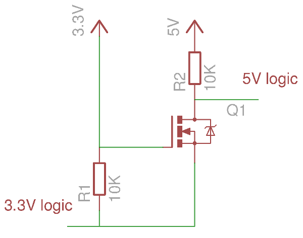

You will need to handle the sensor signal through something like a transistor as ESPs IO pins don't handle signals higher than 3.9v
Posted : 18/12/2025 3:39 pm
RE: Why can't my Core One do something basic like detect a filament jam or a nozzle clog?
Yep. The world has moved on from 5V TTL. I'll need to add a simple MOSFET level shifter. Maybe I'll dust off KiCAD and create a custom board.
Posted : 18/12/2025 4:12 pm
mnentwig
(@mnentwig)
How about a blue LED from the 3.3 V input to GND and, say, a 2.2kOhms resistor to the  5V output (driving 1+ mA which shows the typical ~2.5 V forwards voltage of a blue LED). "Almost not a hack", works well enough at prototype level. Free indicator included :-).
Or just a 10 kOhms series resistor (relies on the digital input's ESD clamp diodes tolerating ~500 µA). This was officially sanctioned for some older 3.3 V chips but nowadays it's a hack (e.g. I've used displays with 2k2 I2C pullups to 5V supply without breaking anything)

With "it" you are referring to the 5V TTL sensor? RPi inputs are not 5V tolerant. It needs the same logic level translation.
