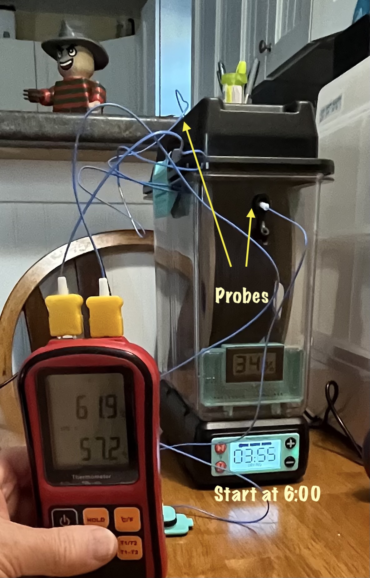

I live in Nova Scotia, Canada, and our average humidity is 83%. (AVERAGE!, so that means in summer it is often above 90%). This would be similar to anyone on the Atlantic coast in Boston, New York, etc. So humid environments can be very common.. and a huge concern. I never realized that moisture can penetrate the vacuum seal of filament rolls (except those from Polymaker that I've gotten (PETG) in mylar). I've had to dry many spools of PLA after noticing stringing.
So I've tried 3 filament dryers.. Here, I tested the PolyDryer and PrintDryer Pro 3 that I have and results are below.. Here's my experience:
Sunlu S1: Great UI, temperature very accurate. Died in less than 5 months and neither Sunlu or the Canadian distributor "DigitMakers" would replace at their cost. So I was out $100 and I now never buy Sunlu products. I attempted to repair but it seemed to be a component failure)
PolyDryer results are below. And I have had great service and response from Polymaker for their filaments and other products. I really like their filament. Now they claim their unit heats to a max of 73C, but this is likely measured only an inch or two from the heat exit. In my probe placement you can see I get between 55-60 on their highest setting. I used PETG which the article in the previous post states use 65C for drying. I have noticed that on setting #2 for PETG (as recommended) It took a long time to get my PETG down to 15%. I think I will now use the max setting for my PETG. (and likely setting #2 for PLA although I've not tested). Since I only use PLA/PETG/TPU, the PolyDryer is fine for my needs. (But using setting #3 for PETG  (or setting #2 for PLA) is not recommended.. but I am willing to sacrifice a spool to see if I can cut down the drying time by hours.
The PrintDryer people have given me great customer service replacing my Pro V2 with a ProV3 base  (which gave me increased temp range) when I showed them a noisy fan. No cost. Great service. (disclosure, they are Canadian, but really has nothing to do with it). At setting 65C, the temps inside, with probe placement as shown in pics below, were 54-62. Likely pretty close since the heat exit was about 6-8 inches away where the temp is likely much closer to 65C. The nice thing about the Pro V3 is that it goes up to an 85C setting and although not tested, I'm pretty confident its air temps would far exceed the Polydryer for engineering filaments.
My Conclusions from these 3 print dryers.
1. Sunlu is not bad, but only a single unit and has zero warranty.
2. I love the Polydryer for my use because I have an open-frame MK3S+ and no MMU/AMS so printing directly from their boxes is an amazing convenience, as I can also dry at the same time. I likely would question if it is effective beyond PETG/TPU because of the very long heating times.. and am unsure if it would meet an optimal temperature. I use this often when I have a damp spool and don't want to wait to dry. I start the print with drying active.
3. The PrintDryer Pro3 works very well. I have made my own spool rod and I will heat 3 rolls of PLA/PETG at once (it fits, but the middle spool is over the heater so might be a bit of an issue). The Pro3 UI could be much better.. I understand they did it to keep costs down, but I'd like to see something a bit better.. But it has been the best of the 3 for me over drying about 100 spools.
4. Everyone should characterize their own dryer using thermometer probes at some point. I had to do this with my espresso machine and so had a bunch of temp probes available.. but it really shows you what your equipment will do. You can't read specs and really know what is going on.
5. Humidy is a real problem for me. Without constant maintenance of spools and desiccant, I can't get great prints.. and it takes a commitment. I recharge desiccant (50-112 gram bags) about every month by putting each in my microwave at a setting of 2 of 10 for 5 minutes.. and measure the result. Most bags take 2-3 cycles.
6. As an operational note, I often print multiple parts in sequential print mode because it limits the possibility of stringing. This mode has better inter-layer adhesion and generally I get very good surface finishes for PLA/PETG/TPU.
