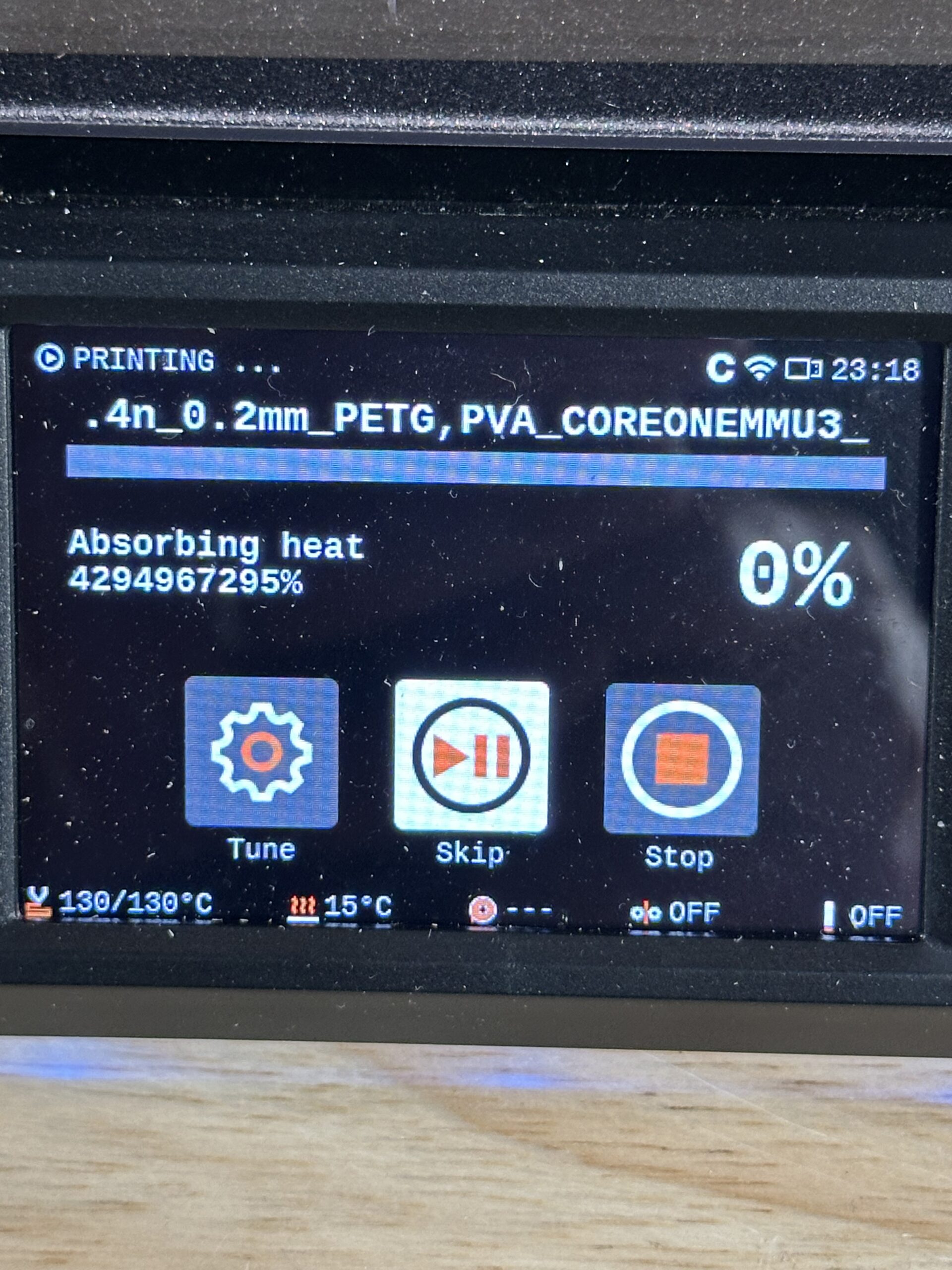

BrokenToes
(@brokentoes)
RE: Waiting for Chamber Temp
some impossible % number. Bed temp is not on so I wonder if that has domething to do with it
Posted : 30/11/2025 10:25 pm
Posted by: @brokentoes
The was fixed in the 6.4.0 firmware.
Posted : 01/12/2025 2:50 pm

BrokenToes
(@brokentoes)
thanks
one thing I noticed with the print I was trying to do. No bed temp - I was laying down PVA first for the next print as a soluable setting - which called for no bed temp. So I think the slicer should have hinted that the heat soak may not be needed if bed temp is 0.
Bottom line after 6.4.0 it sat at heat soak for a few hours - never started the print. I'll need to go back in today and disable heat soak.
Posted : 03/12/2025 1:28 am
thanks
I reported a bug on that. If I set the bed temp to 0 it would oscillate between 0% and -1% until I stopped it. I tried adjusting the temp up 5° and then back down and the heat soak started going negative. That should have been fixed in the 6.4.0 firmware.
I also modified the g-code to do something like this. I'll probably go back and simplify it later.
{if filament_type[initial_tool] !~ /.*(FLEX|PLA|PETG).*/ and first_layer_bed_temperature[initial_tool] > 40}
G29 G ; absorb heat
{endif}
