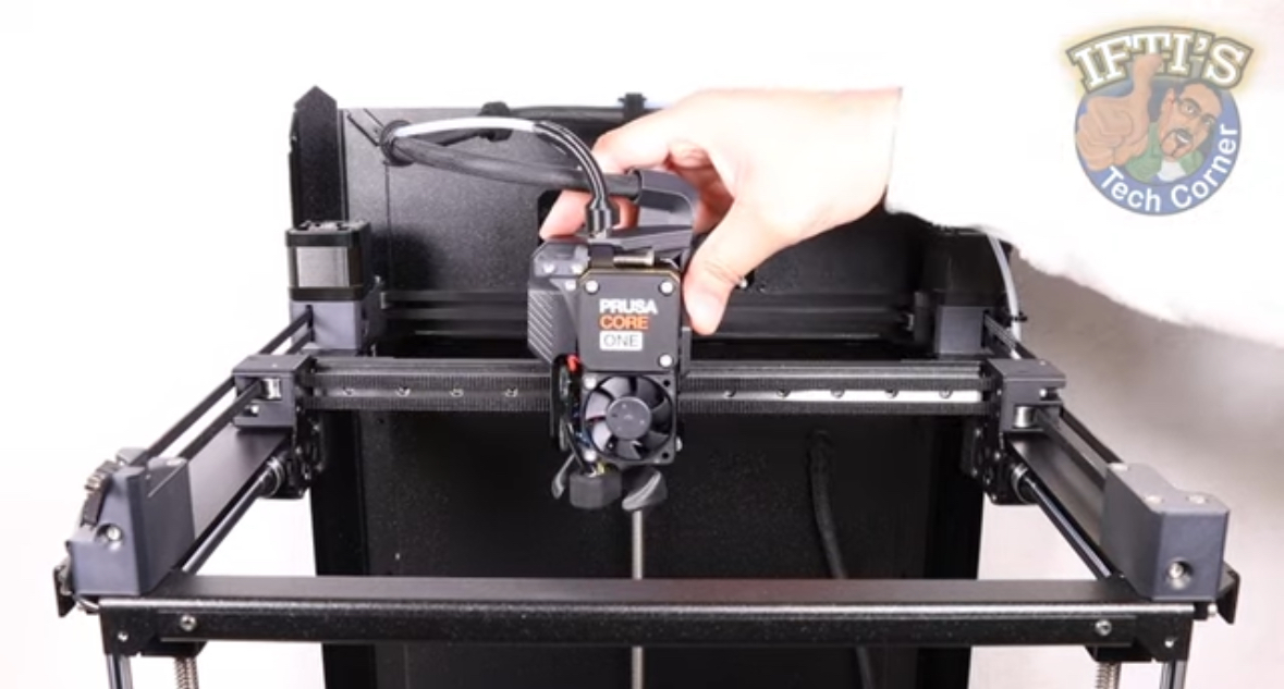

I think he is referring to step 16 in the Heatbed chapter?
Its the only heatbed mount with bearings......
https://help.prusa3d.com/guide/4-heatbed-assembly_835514#842336
With this part note that one end of the section the bearing slides into has a lip that clips into the bearing. As mentioned in my video guide, place the bearing down and push the part down onto it. You will then hear a click when the bearing sits into the lip mentioned above. Ensure the bearing does in straight as much as possible. Once the bearing is in place it is easy to rotate it so the line of balls inside form the X shape, before securing with a screw and nut.

Yeah, @iftibashir is right. The lip broke when I pushed the bearing in, even when I spread the sides with screwdriver. Without the lip, the bearing wasn't fixed in the part even when screwed. I tried to tighen it some more to give the part a better grip of the bearing, but it snapped - layers got separated. It still holds intact so I'm continuing the build, but am pretty sure that it needs replacing.

As long as it securely holds the bearing, you will be good to continue and will most likely be fine. As it later attaches to the Z-Motor and the rod however, it may be a bit of a pain to replace. If support are able to get you the part quickly, I'd be tempted to wait. Although if it's going to take weeks then carry right on! lol

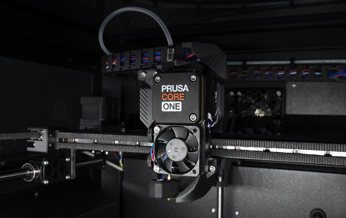

Um, did any one else notice this? When you build the Prusa core one kit at the top of the extruder, you secure everything with Velcro straps, but look at this image. The filament guide and the wiring is held in some kind of plastic tube like case

*That's the cable chain the early promo images had. That was swapped out late in development for the swing arm/velcro setup.

Ok, that explains it. Thanks for the info

That appears to be the same cable that comes with the unit. It's just not a great photo. The black you see is the fabric wrap around the cable bundle. I thought you might be referring to the cable chain the early promo images had. That was swapped out late in development for the swing arm/velcro setup.

You could probably find the chain online should you want to build one and use it instead of the metal arm and textile sleeve. Not sure if would add any value over the stock setup though.....just look cooler!
