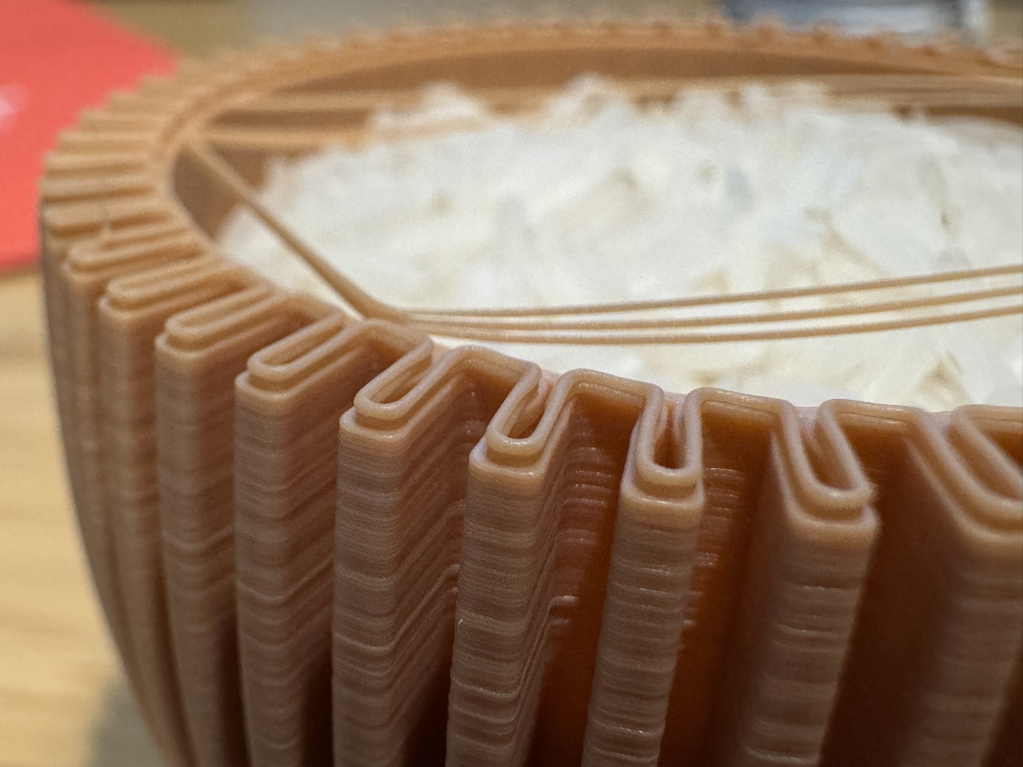

I'm having the opposite issue... on resume the nozzle isn't going low enough, so the filament doesn't adhere properly. Was able to replicate--same object paused at different heights. when I went to resume it missed by ~1 layer, causing failure.
