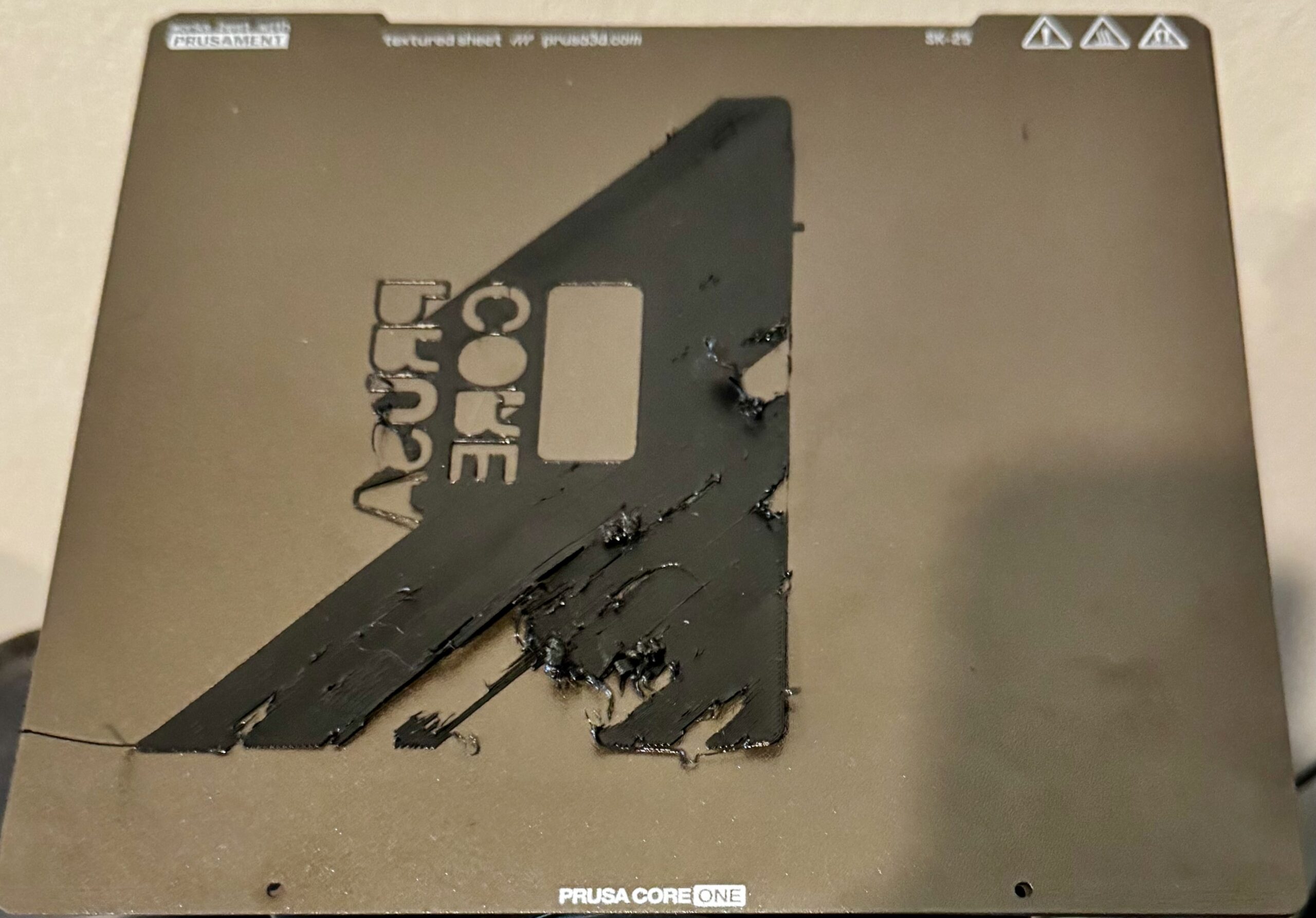

Bought the Prusa Textured and Satin Powder Coated plates. I've only been printing Prusament PETG and clean before use with 99% isopropyl while cold.
Brand new Prusament PETG filament straight from the bag to the drier for 6 hrs before printing:

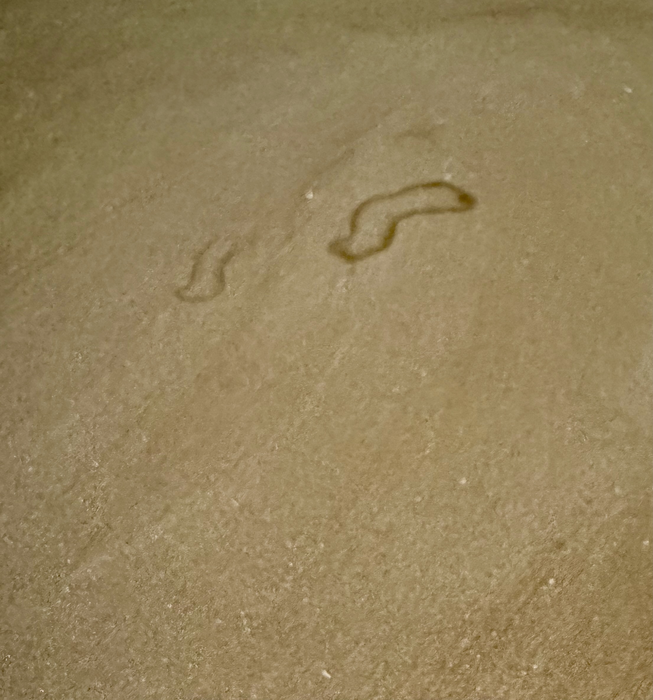

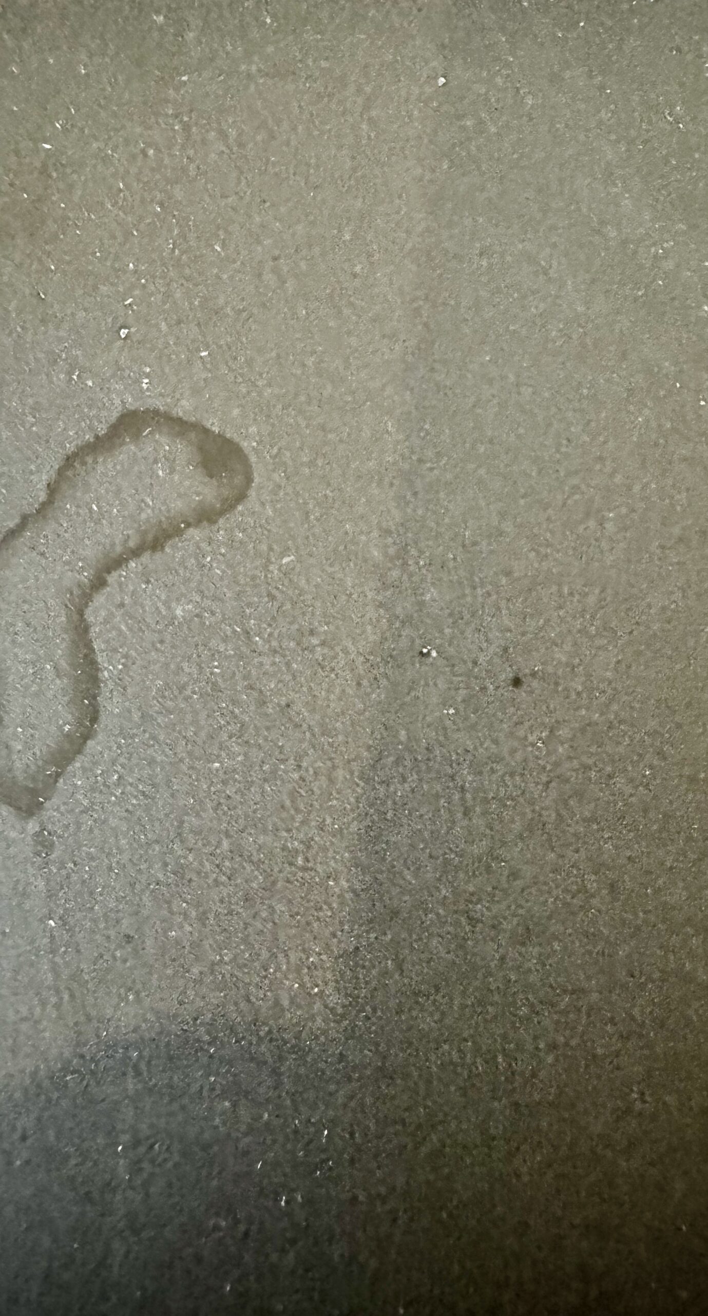

1. The satin sheet powder coating is already wearing off after 2 days of use and it stains very easily if water gets on it (no I didn't wash them in the sink). Also, the first layer is terrible with ripples in the center of the sheet and warping.

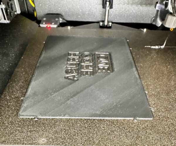

2. The Prusa textured sheet is even worse. First layer doesn't stick well at all with PETG. After 4 attempts, I replaced it with a $20 no-name brand from Amazon that works perfectly each time.
Of course I contacted support over chat and they referred me to the quality control department and I've had not response to follow up emails over the last 2 week.
These photos are the results of printing on the Satin sheet with rippling caused by and adhesion problem and also showing "water marks"

Fourth attempt printing on the Prusa textured sheet with Prusament PETG
First Attempt with $20 sheet from Amazon

It's a bummer that you're having a poor experience with Prusa build plates. There are many thousands of Prusa customers (including myself) who have had an incredible experience with the satin sheet.
The very first order of business with any new build plate should be to scrub it really well in the sink with warm water and dish soap.
Also, are you saying they the watermarks are showing up on your build plate spontaneously? Nothing at all had spilled on them, no fluids dripping from above the printer perhaps?  It's common for there to be harmless outlines of previous prints being visible on the build sheets, but organically shaped watermarks are something else and would make me think that there must have been a previously spilled liquid that is both effecting adhesion and collecting dust/dirt in the shape of the stains.
I should add that it's poor form to post here suggesting that an entire product is faulty because you are having a bad experience with one example of it.  Prusa satin sheets are highly respected in the hobby, having proved themselves over and over to be reliable and effective.  I agree that something is up with your experience, but either it's solvable with a good cleaning or as support suggested it may be a quality control issue.

2 out of 2 build plates I've purchased recently are bad. I did not categorically state that all prusa build plates are bad. I'm still using the satin build plate from 2 years ago. The one I most recently purchased is obviously flawed and I've been struggling to get a replacement. After speaking with support, the QC team will not return my emails. Anyway, I have found $20 alternatives that, in my experience, are better quality and certainly much cheaper.
The stains are caused by water. I purposely dropped water on the plate and, yes... it creates these stains. It is not a case of "liquid leaking from above"

Same filament, exact same print settings, exact same sheet cleaning method and radically different results between the expensive Prusa plate and a "noname" $20 plate from Amazon.
Update: QC (more or less) admitted to a problem with the sheet and are sending me a new one. Hope it's better than my 2 year old Satin sheet that I still use in place of the new one I recently purchased.
