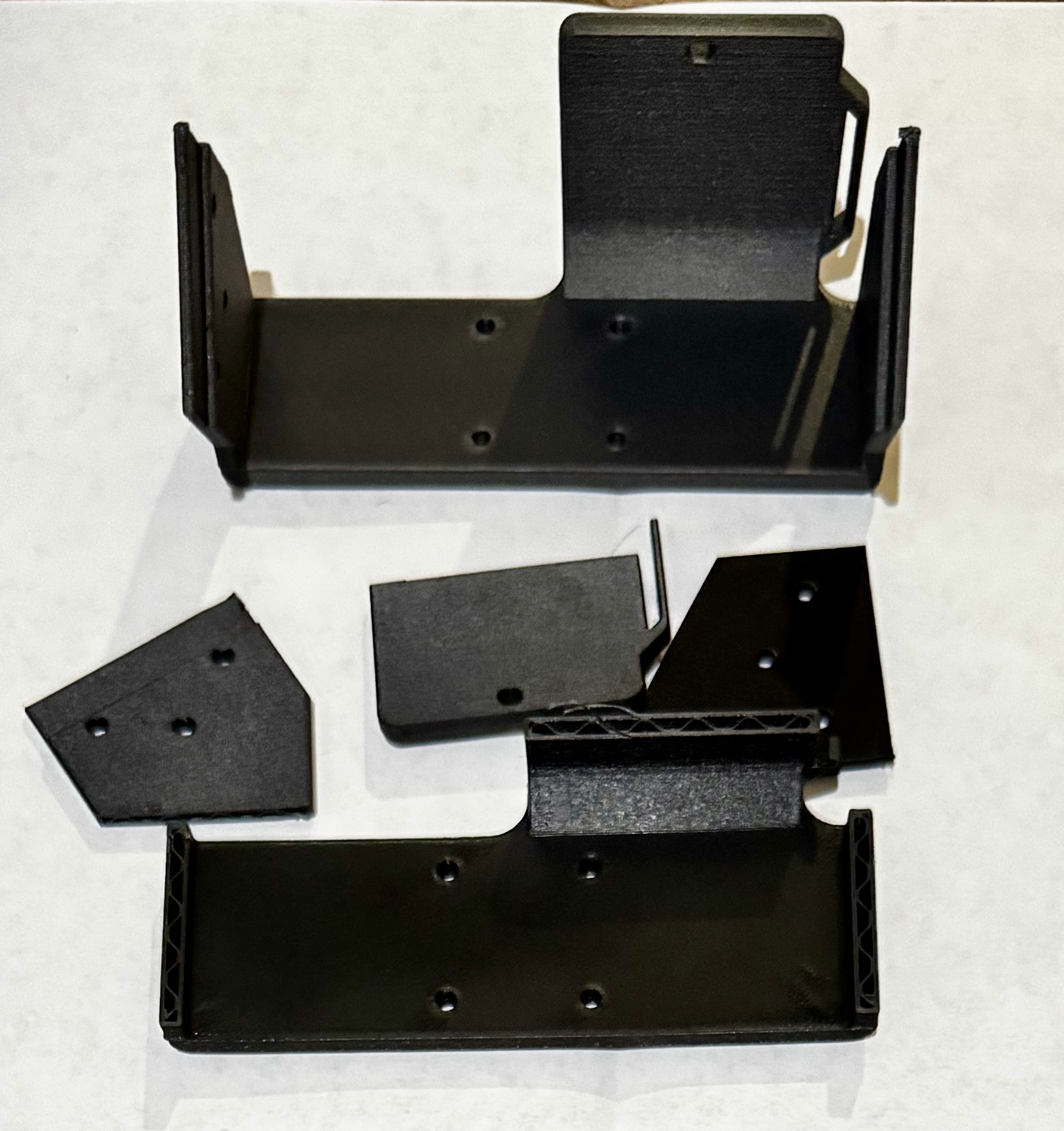

Thought I'd share this. Side by side comparison of Prusa PC-CF and IEMAI PC-CF in this image. Top is Prusa, bottom IEMAI both straight from the dryer and using manufacturer settings for each.
Then I flexed them a bit applying the same amount of force to each. And IEMAI snapped like a dried twig... and was slightly warped.
