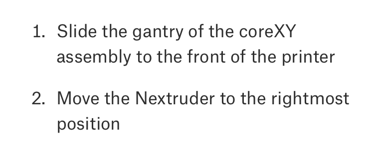

After I tuned my CoreOne to the new 98/92 Hz with Printhead in the right forward corner (which take a while to be at 98/92), I ran the Phase stepping Calibration and after than the Input Shaper Calibrations.

Apologies for what is likely a dumb question, but "front right" would mean the closest left corner to us (the user) when facing the printer, correct?

My understanding is to move the Head to the front right facing the printer. Works for me

I tried this and it made my gantry out of alignment, one side hit before the other and homing the print head took forever (might have eventually failed, I gave up before then).  Went back to stock tuning method and it's fine again.

The instructions on the new belt tuning site make it more clear.
1. Move the gantry to the front of the printer.
2. Move the Nextruder to the rightmost position.

I find the method somehow troublesome. First, it results in the uneven tension of the two belts (in my case >6 Hz difference when comparing with the head placed in the middle of the furthest position), resulting in heavy head-banging. Second, tuning one belt affects the tension of the other one as well, similar as with tuning a violin, or any other wire instrument with a floating tailpiece.

Why would there be such an uneven belt tension? With the print head moved all the way to the right, the free length of the two belts along the X gantry differs by about 5%. (The lower belt is longer since its left-hand idler is placed further to the left.) The different target frequencies are about 6% apart, in inverse proportion to the vibrating belt lengths. So the resulting belt tensions should be equal to within 1%.

New method: Head forward to the right, plucking in the middle of the rail.
Old method: Head backward in the middle, plucking in the middle of the belts on the left and on the right side.

This suggests either that your gantry wasn't square before you started to tension the belts, or that the belt tension wasn't increased evenly.  I've seen it myself - if I let, say, the right tensioner get too far ahead of the left one, it will open a gap on the left side of the gantry, such that adding a bit more tension to the left side results in both belts having an increased frequency.
For me, the solution has always been to slacken them both off again, check that the ganrty is square, then go more slowly and evenly with the tensioning.
