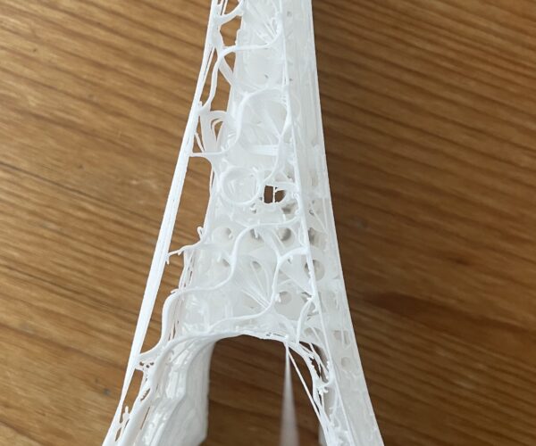

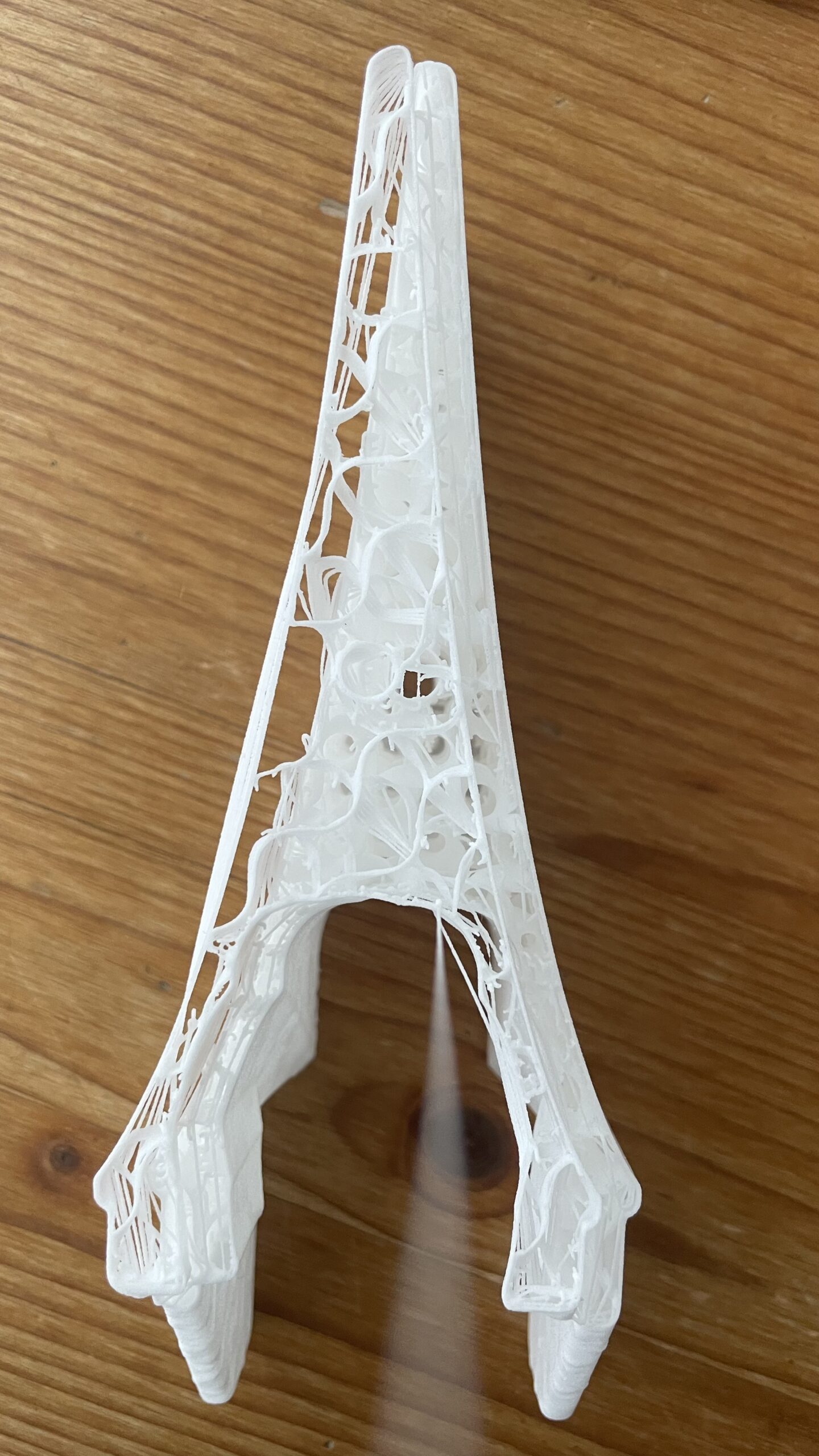

#1&#2 - first rodeo with layer shift, so makes sense that I would rely on default settings. Real question is, if it should be turned on, why isn't this the default?
#3 - avoid crossing perimeters enabled
#4 - avoid crossing perimeters enabled
#5 - avoid crossing perimeters enabled
Posted by: @jurgen-7
... and please add comments with each print whether you had "avoid crossing perimeters" enabled. 🙄
Posted : 31/10/2025 12:58 am

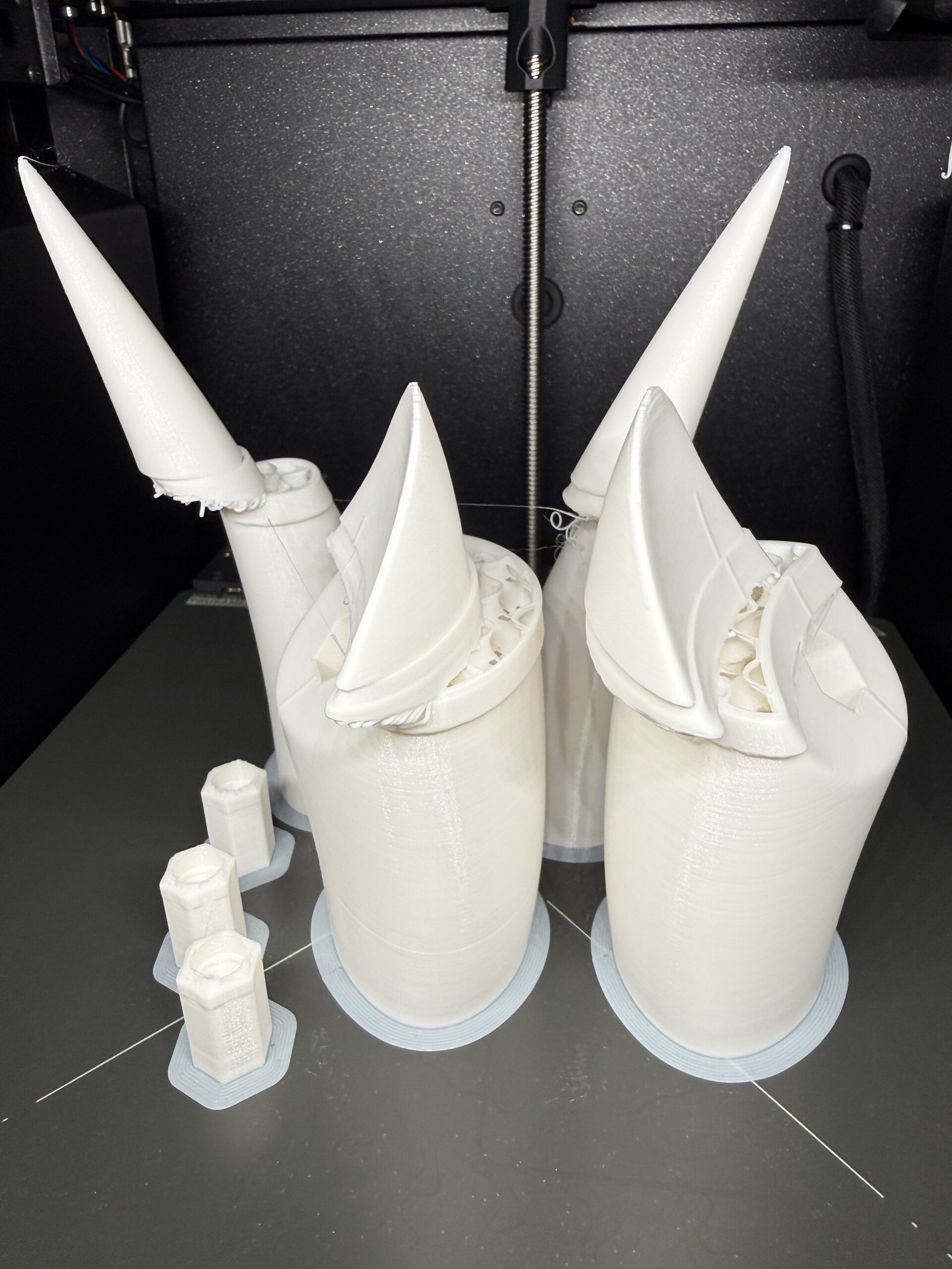

Core one with MMU does have a problem:
I put two otherwise totally undemanding objects into the back corner of the printbed.
Lo and behold, layer shift (most likely the umbilical getting stuck).
Prusa, please fix this...
(PS the picture needs to be clicked as the objects are on the far left and right)
Posted : 31/10/2025 7:25 pm

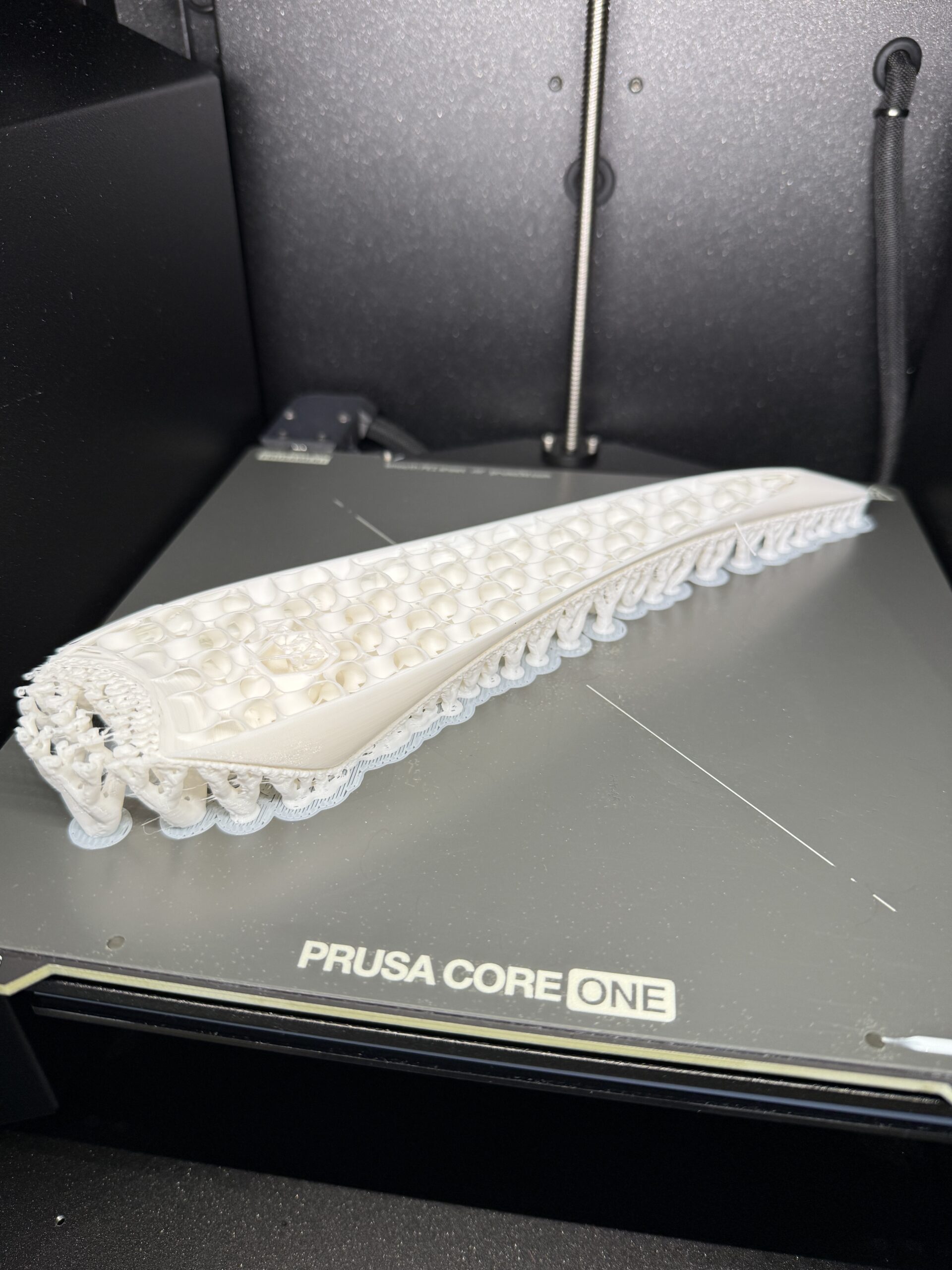

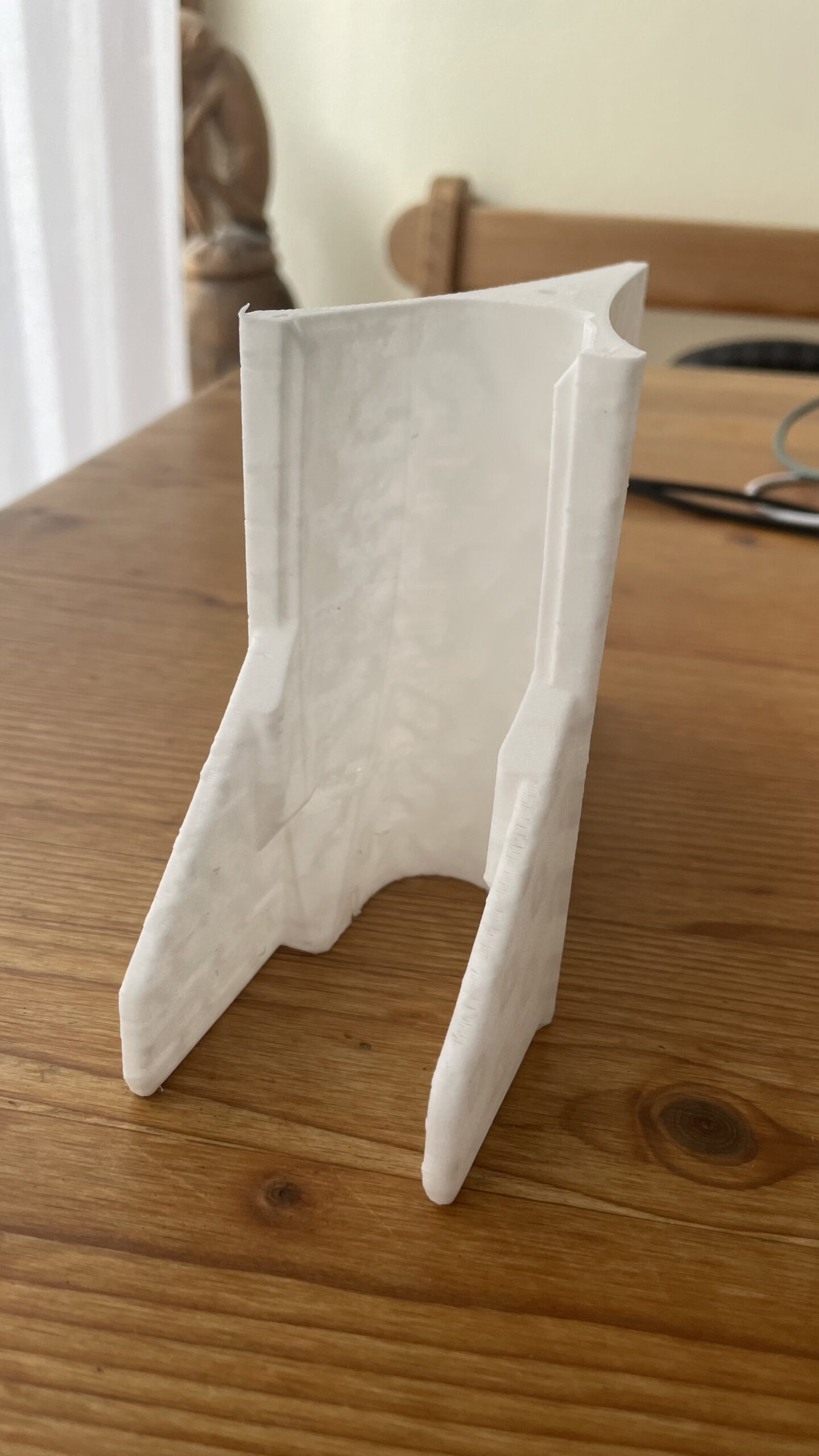

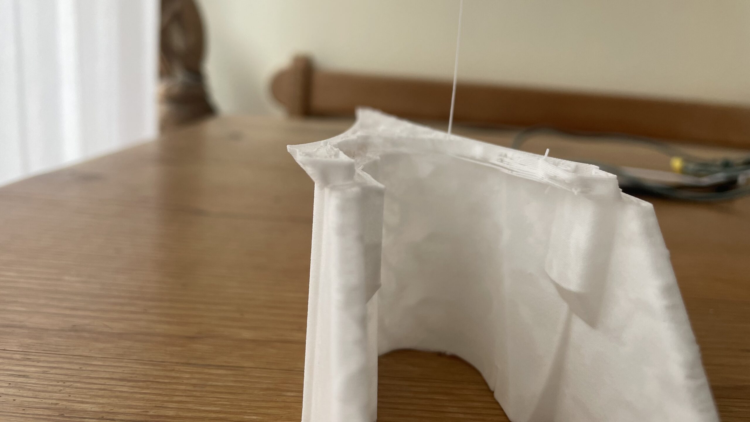

I have encountered a layer shift again. The only reason I have found why it happens is the activated „Avoid crossing perimeters“ option. But it doesn‘t occur every time. In my case when I print fuselage parts and at higher levels (see photos), not at the beginning. I was present when it happened. You can hear a loud bang as if the printhead runs into one of the rails and then it resumes „off track“. Is there a workaround to avoid that happening? (speed in sharp bends or something?
Posted : 04/02/2026 10:59 am
HatIdi
(@hatidi)
RE: Layer Shift Wall of Shame Post 2
I have just printed the above item in stealth mode. no issues. The problem is within the slicer software as mentioned in another post. I hope Prusa will fix that soon
