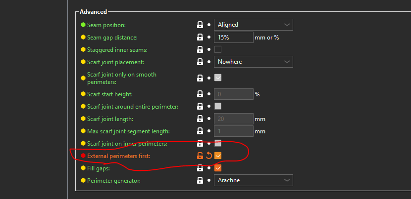

Hi, try "External perimeters first" option in "Advanced section" of "Layers and perimeters" settings. (slicer must be switched into "Expert" mode)

I tried making the outer walls first, but it ended up with a bunch of unconnected layer lines. Then I gave that hull lines solution from the video a shot, but that didn’t work either.
