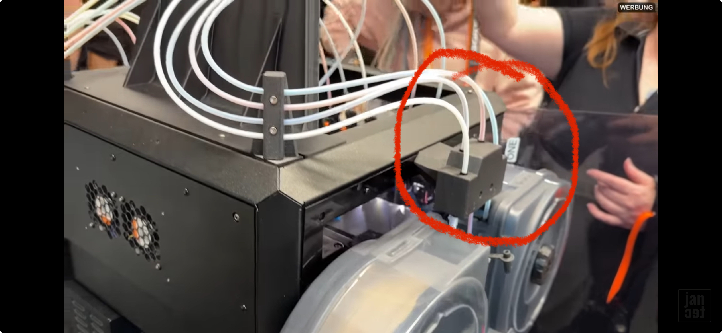

Posted by: @jurgen-7
 And there are a few integration questions which I am wondering about. E.g. it seems we are losing the side filament sensor. So how will filament runout detection -- and in particular unloading of the remaining bit of filament -- work with only a printhead sensor? (Or will it be a printhead sensor?? I can't quite see how that works with the exchangeable tube & nozzle combos. It's listed as "will be there for the Core One version, but is not implemented on the Formnext demo unit" in the INDX specs.)
While I’m not 100% how’d you’d wire it back to the buddy board, without cutting a hole on the case or acrylic, but the ptfe tubing holder on the sides are pretty over sized. They have more than enough space for a filament sensor/s to catch run out prior to getting to the extruder.
Opublikowany : 20/11/2025 11:34 pm

gb160
(@gb160)
RE: INDX is coming for CoreOne?
Yeah I'm pretty sure it was mentioned at Formnext there will be filament sensors where you've circled.
