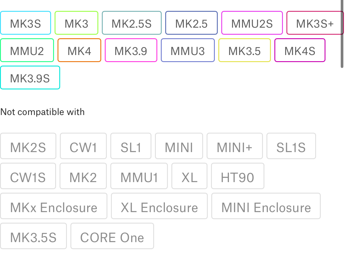

When I ordered my core one I did not add the additional sheets.
Recently I made a separate order to get satin and PP sheets separately.
What I didn’t realise though is that although I filtered to print sheets > core one, the sheets I ordered actually state not compatible with core one
I couldn’t find a core one specific set of sheets in the store
Is the listing a mistake and the sheets should be marked as compatible, or are the sheets for core one only selectable when you buy the printer, and not available in the store separately?

I think this is an oversight.
as you say, the only print sheet that says it is Core one compatible is the Smooth sheet,
However all of the mk4, mk3, mk2.5 sheets are the same size and the heading  lumps the Core One in the same group.
I will ask for confirmation,

I'm using my MK3 plates on the core one no issues whatsoever, so any from MK3 or 4 will work.

Yep, I'm 100% sure that you can use all the standard Prusa size sheets.
I also asked Make-O-Rama to check, if the door closes, when using a Bambu sized sheet and she did a short about it.
Yes, Bambu sized sheets fit too!

Ok it’s good to hear these sized plates do in fact work
I hope the store is corrected soon
(it’s these tags that I’m referring to mainly:)
Posted : 05/04/2025 10:13 am

The Core One does use the same size build plate as the Mk2, mk3 and MK4 printers, the smooth sheet has outline printing on the steel sheet,
I believe the Core One era Powder coated Build plates  will have different screen printing to show the enlarged Print area, meanwhile the earlier printer build plates will fit the Core One.

I use my old sheets coming from my MK3S and MK4/S and also "without printer branding" purchased separately on my CORE One without any distinction. In fact the steel sheet coming with the CORE One is still wrapped. 😆
As mentioned, the print area outline doesn't match with the CORE One specs. It doesn't matter excepted for non-smooth sheets where the silkscreen leaves its imprint at the bottom of the prints. Below an example with a Satin Sheet.

So that explains the new versions.  You could use the old ones, just as long as your prints remain within the older print limits, right?
Yes, exactly.
And ofc this is only important, if the object touches these areas with the first layer and you need a "pretty" bottom surface there.
