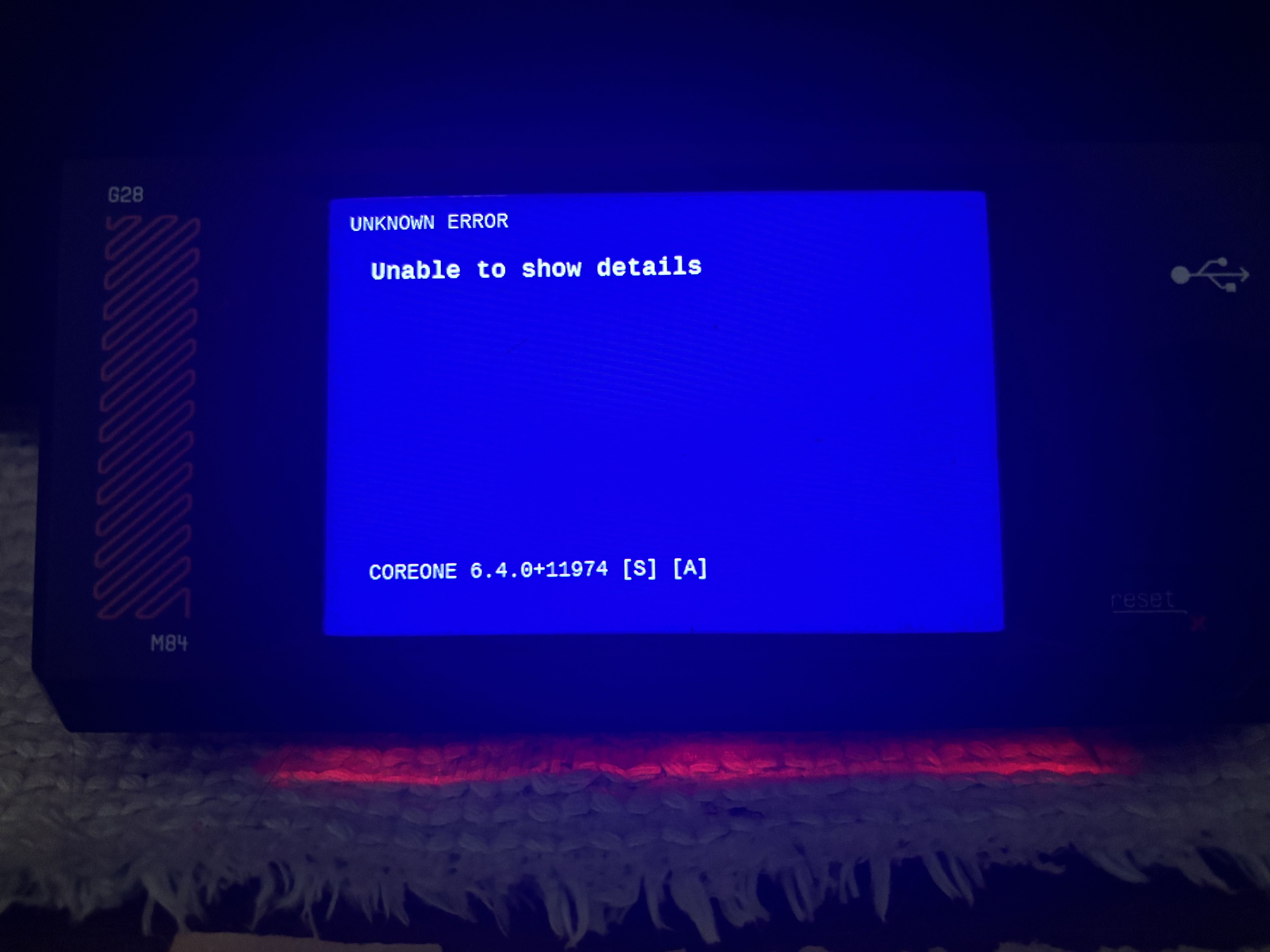

Biscitt
(@biscitt)
RE: 6.4.0-RC Firmware for Prusa CORE One
I have just started to get the same issue but with a different software version (?). I don't know enough about the software to understand most of what has been mentioned on this forum but it sounds like the same issue. It clears when I reboot:
Posted : 19/06/2026 6:46 pm
