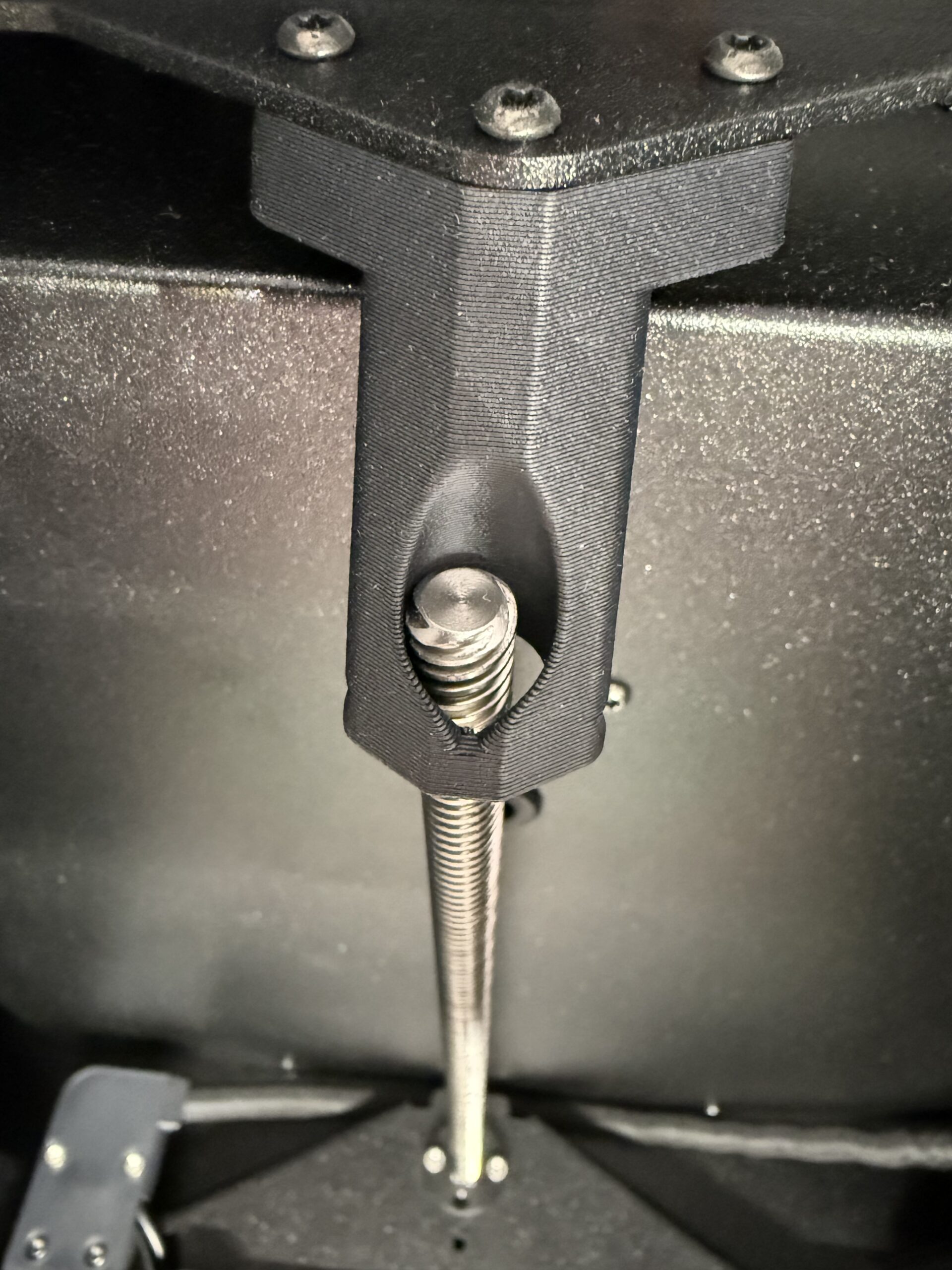

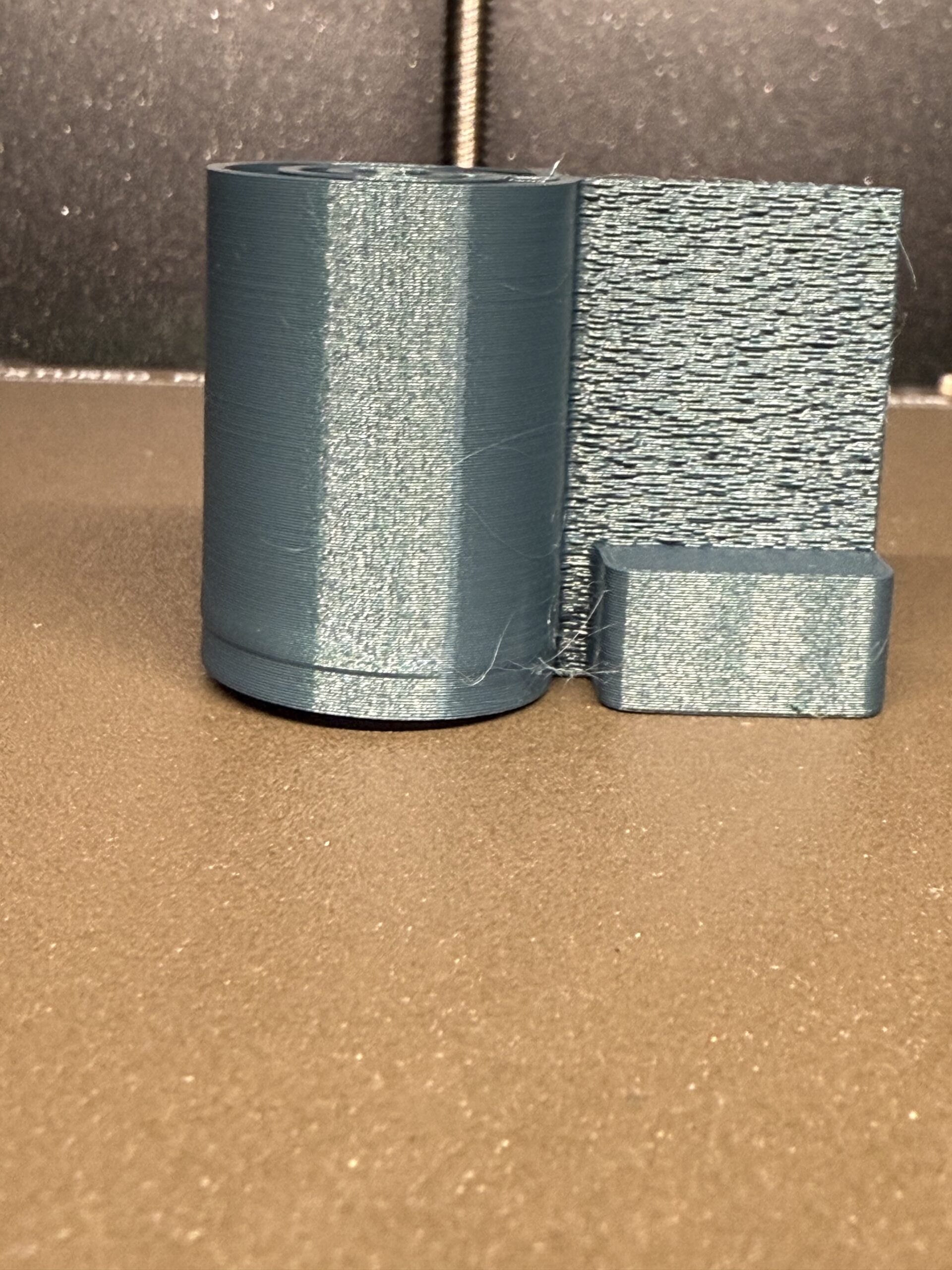

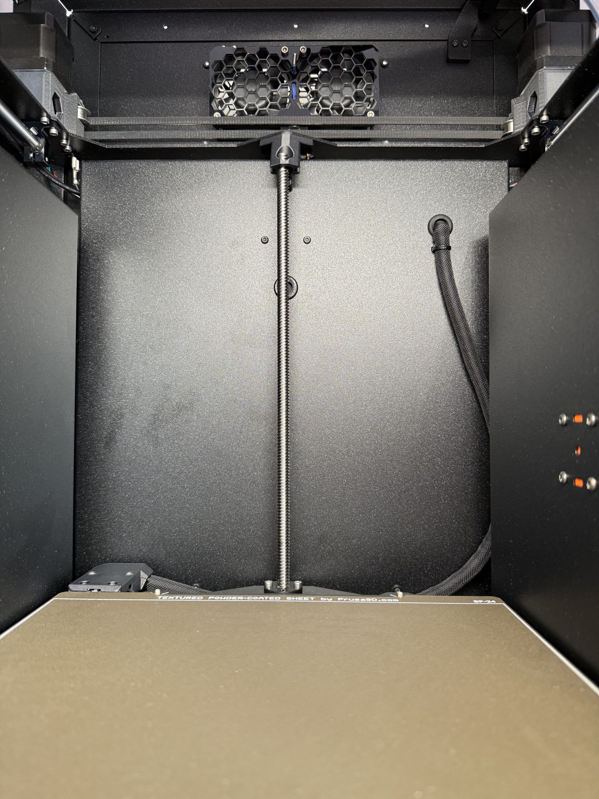

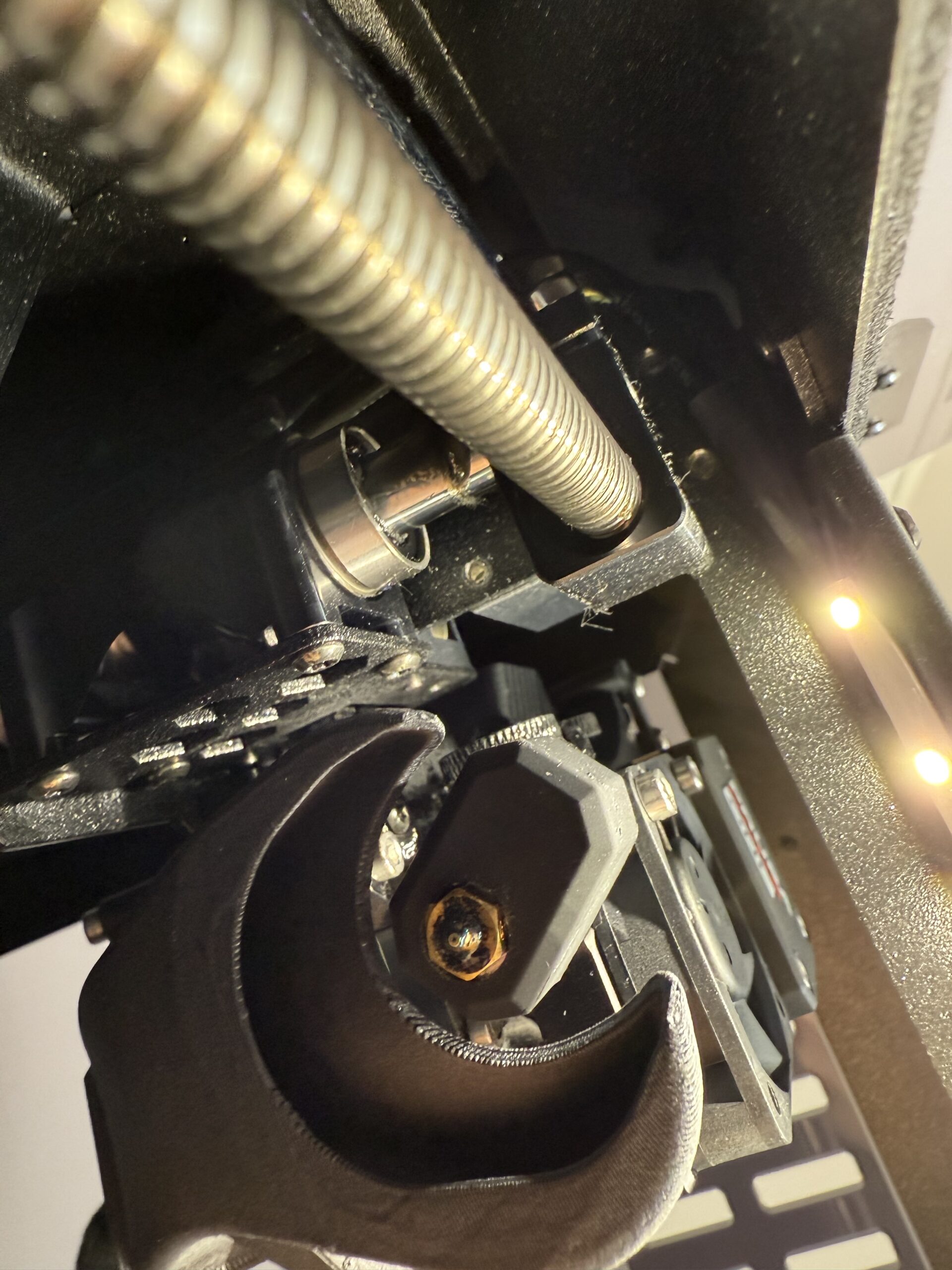

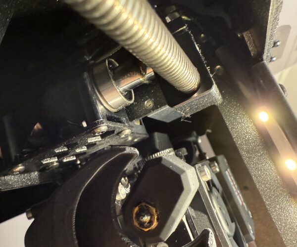

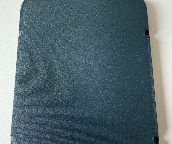

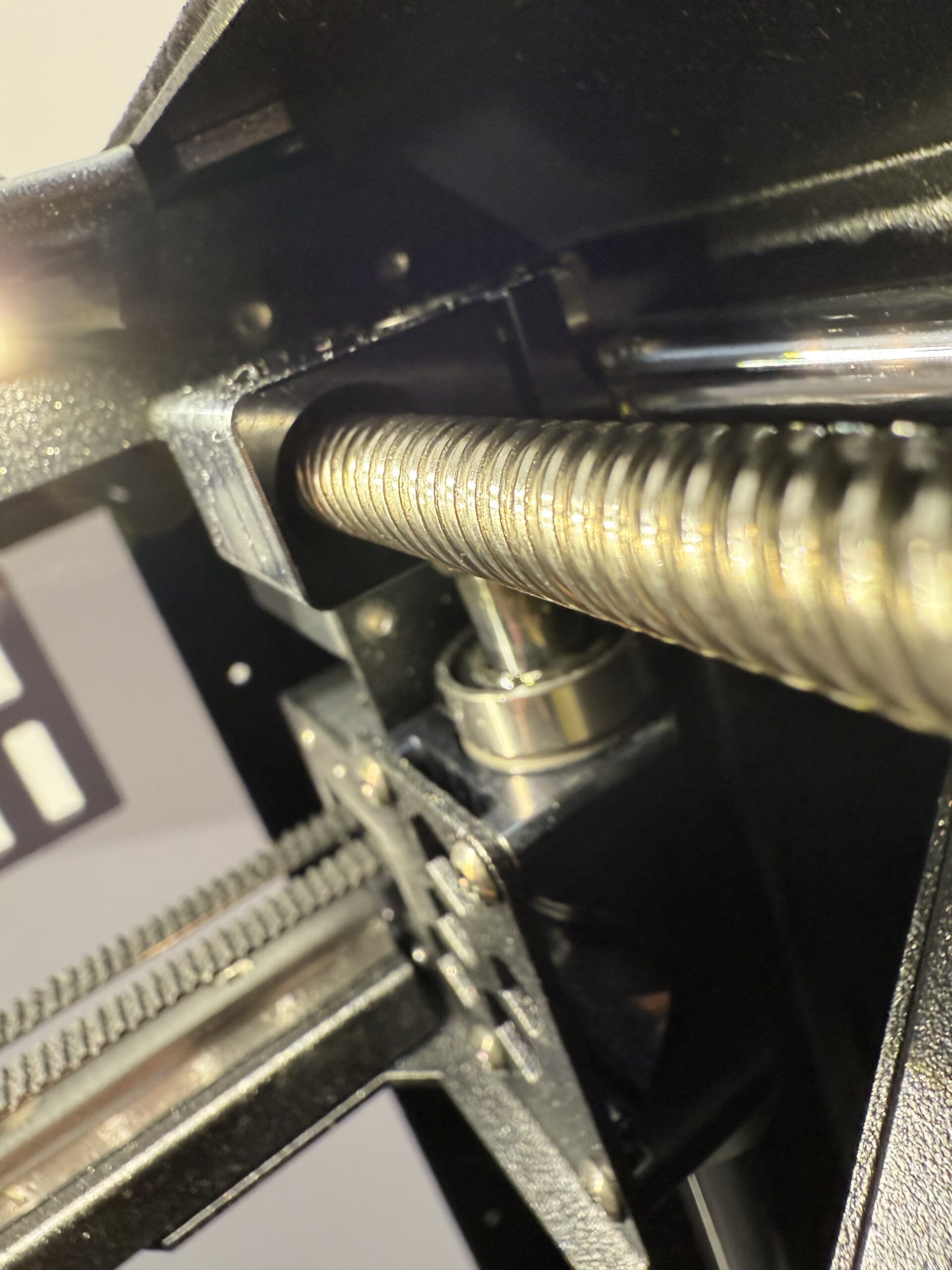

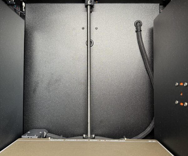

RE: Z axis trouble but only when printing
as requested, here is a full write-up of the issue, including photos and a short video.
1 | Printer & setup
Model: Prusa Core One
Firmware: 6.3.2
Total print time before issues: ≈ 7 days
Filaments tested: Extrudr and Prusament PLA and PETG (same behaviour)
Slicer: PrusaSlicer 2.9.2
Build plates: textured and silk sheet (problem identical on both)
Mods: none
2 | What happens
Initial problem (back-left corner):
After the normal 49-point mesh-bed probe, the Z assembly rises in a small area at the rear-left. This begins on the very first layer—so early that the nozzle almost scrapes the sheet and the layer was pressed so hard into the print bed that it was almost impossible to remove. After a lot of troubleshooting that didn’t help at all, turning the printer off for 2 days and pushing a bit on the far left corner of the bed solved the issue.
New problem (center of bed):
While printing a perfectly flat test print, the first layers look flawless. At roughly 6-8 mm height, the Z spindles start turning slowly—even though the printer is still on the same layer. I captured this in the attached video: the spindles rotate even though no height change should occur.
3 | Things I have tried
Greased the three trapezoidal nuts → removed heavy squeaking, but Z drift remains.
Loosened all bed screws, Heated bed to 110 °C, re-tightened while hot, cooled → no effect.
Repeated Z calibrations → problem persists.
Swapped to a different build plate → no change.
Checked PSU and electronics for loose connectors → everything solid.
Tried “heater off” trick in the start G-code to rule out thermal expansion → no effect.
Left printer powered down for two days and pressed firmly on back-left of bed → corner issue disappeared temporarily, then center issue surfaced.
4 | Media
Photo 1+2: First failed part in the back-left corner—underside shows a pronounced “ditch.”
Photo 3+4: Current test plate—underside perfect, topside shows waves/gaps.
Video: Door-shot of the machine; Z spindles clearly turning during what should be a motionless layer.

I am currently printing the test print you sent and at roughly 10mm layer height I can hear some very bad squeaking sounds. It sounds like something is scratching on something.
Napsal : 24/05/2025 2:42 pm
1 lidem se líbí
Bolt Engineering
(@bolt-engineering)
The test print finished and it had some issue with heatbed adhesion. Also at a layer height of roughly 3.15mm, there is a visible issue. This issue is only within the circular part of the test print. Everyhing else printed just fine.
See photo:
Napsal : 24/05/2025 4:42 pm

Bolt Engineering
(@bolt-engineering)
I spent several hours today to disassemble the entire extrder and change the loadcell (Support shipped a new one to me). After re-assembling and re-calibration I did another test print (also with the M104 S0 command). Nothing changed, the issue still persists.
I then did the following: Auto home -> manually moved the Z axis to 0 and then to 1 mm in the fron right position. The values seem to fit since the nozzle is touching the print bed at 0mm and there is a tiny gap between the nozzle and the print bed at 1mm.
I then moved X and Y manually while having the Z axis steady at 1mm distance. In the X-axis at front part of the printer, everything is perfectly fine. From all the way to the left to all the way to the right, the gap is constantly 1 mm.
When moving the Y axis further back, I noticed that the 1mm gap was widening. significantly. We're not talking 1mm here but more like 3-5 mm.
Therefore the whole bed seems to be skewed. Shouldn't the Z calibration take care of this when ramming the bed all the way down?
I also noticed another thing: When the heatbed is at a very low position, the far Z-axis is touching the plastic part at the top. Maybe that whole rod is skewed somehow? Whole taking a photo of it, i also noticed that the front left Z-axis threaded rod is touching the plastic part at the top, while the front right one is aligned perfectly centered.
See Pictures:
1. The threaded Z rod in the back is so skewed that it is touching the plastic part
2. a macro view of the skewed z rod
3. the front left one that is also touching the plastic
4. the front right one which is perfectly aligned.
Napsal : 25/05/2025 9:35 am
