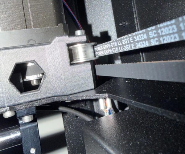

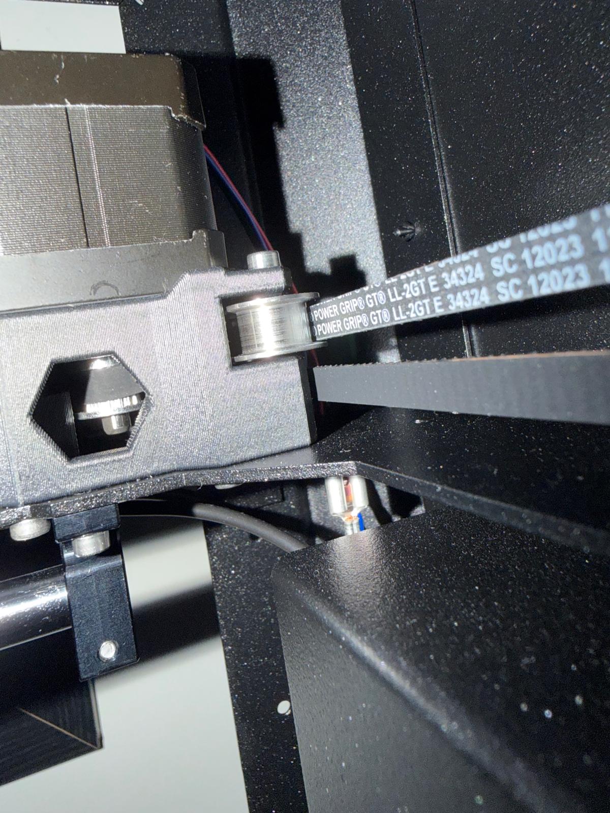

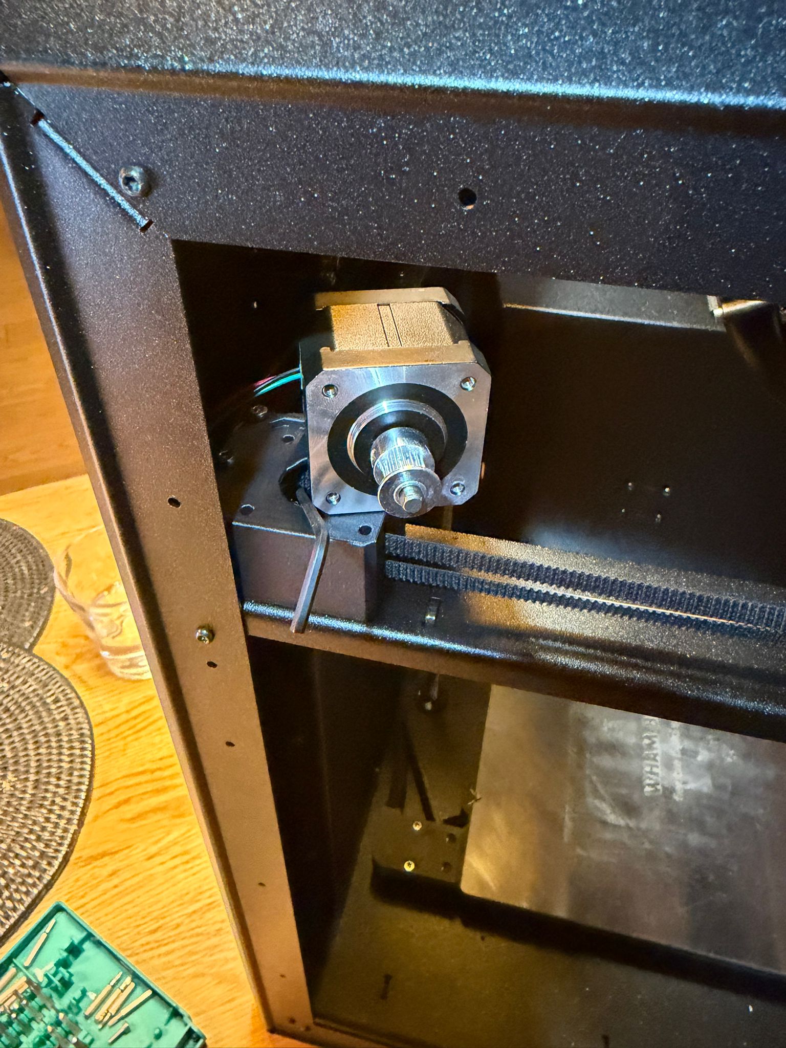

I made a mistake during my MK4s-to-CoreOne conversion 🙁 I installed the X-axis pulley upside down, despite the instructions clearly stating in red: “Slide the pulley on, note the CORRECT orientation.” Feeling pretty foolish about it! Now I need to fix the issue, which requires removing the X-axis motor, and that part has me a bit worried. I’ve already taken off the side panels on the motor side of the X-axis. Do I also need to remove the hotend and completely take off the CoreXY plate?

I have not had to do this myself, but don't see why it would be necessary to remove the Nextruder and CoreXY unit. If you have the side panel and top panel removed, doesn't that give you access to all the motor mounting screws, and a free path to pull the motor upwards? Make sure to relax the belt tensioners as far as you can before you remove the motor.
Before you start disassembling things: Are you sure it is the X motor (the one on the left) which has the pulley reversed? The more common error is to get the Y pulley wrong, because that comes second in the assembly guide and one is tempted to install it in the same orientation as the X pulley before.

Thanks for the feedback, yes, its the X motor back left. As you can see I've messed up the pulley 🙁

Indeed, that dos not look right... You used the spacer tool correctly (with just the narrow gap between motor and pulley), but put the pulley on the wrong way round.
Fingers crossed that the disassembly and reassembly goes smoothly! It may be a bit of a fumble to get the pulley back into the belt loop. If you need more slack on the belt, I would loosen the X belt tensioner to the point where it comes apart.

Took the side panel off, loosened the belts, hooked in to keep the belt loop, unbolted the motor, turned the pulley round, reinstalled the motor. working 🙂
