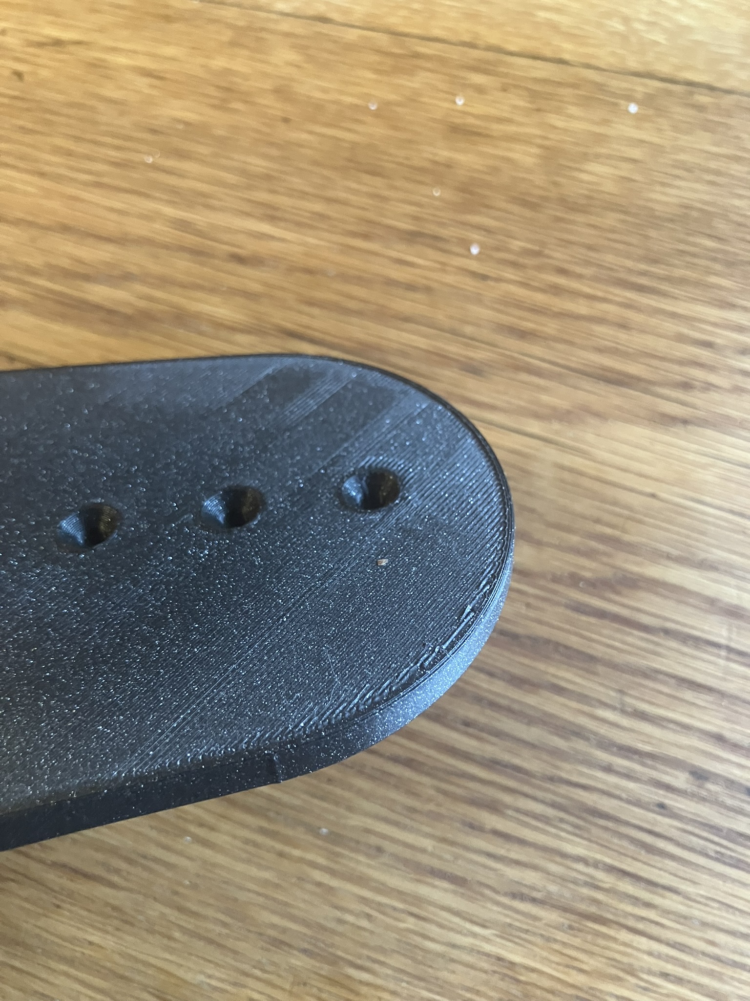

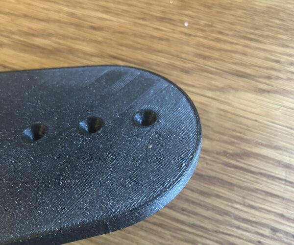

Top layer finish rough in some areas
After doing the super fast benchy out of the box I went right to printing things I want.  Second print was two objects laying flat with a flat top surface.  The top surface that was toward the back of the printer was rough and not pretty and smooth like the rest of the print.  Is this cooling issue? or mesh bed?  Should I try doing a calibration again?  or?   Anyone else have similar on out of box.  New to Prusa world, I don't have carried over mk experience.

RE: Top layer finish rough in some areas -solved
It appears it is due to warping.  The warping was so small I didn't notice.. but there it is.
Which material are you using?
I was hoping the Core One would eliminate warping issues, at least for PLA and PETG......
Posted : 24/02/2025 9:11 am
LarGriff
(@largriff)
I went through a period right after getting my Mk4s where everything seemed to be warping.  I thought at first it was poor bed adhesion.  But finally realized that just because the machine can go so much faster doesn’t mean the filaments will behave.  PrusaSlicer’s default profiles push up the extruded temps, presumably to get faster speeds, but that can cause increased warping.  Now I generally start with the default filament profiles, but add 10 to the bed temp and subtract 10 from the extruded temp, and print at Structural.  Seems to have made a big improvement!  Some filaments may behave better at faster speeds but I haven’t figured out which ones, yet.
I am using the black galaxy prusa pla that came with the printer.  I wanted to give the printer the best chance at giving me good first impressions so I thought I would use the filament they sent with settings they suggest before I through in and try to use the variety of odd ball stuff I have stashed away that tends to be very hit or miss.  I had such a tried and true method on my old printers and had not dealt with warping in literal years.   It didn't occur to me.  I have such a learning curve that I think is worse than someone who has no experience honestly.
It worked like a charm.

Even though the printer has automatic levelling compensation, your still best off doing a manual adjustment.
Brint the bed up to just below the nozzle (0.2mm) then using a piece of card (Business card is ideal) and the power off, adust each Z axis screw moving the print head to each screw every time until you have the same amount of drag on the card between the nozzle and bed, your bed is now about as aligned as your going to get it.
Note, a Z homing where it drives the bed down to the bottom of the printer will reset the alignment back to where it is now, not perfectly aligned.
What you will notice is that as the print head moves across the full rance of the print head, the Z axis screws will be turning to compensate, after this adjustment any motion will be so small as to be not really noticeable at all and it keeps this between prints and power cycles, only the bed running all the way down to the bottom will upset this adjustment.

Since I got a "like" for my post, I visited this thread again and have to eat my own words.
We've found out in another thread, that the Z-leadscrews often aren't perfectly identical and if your print sheet is perfectly leveled to the nozzle across its area, it can be off by 0.5-1.5 mm at the bottom.
So no, please don't only use the shimming mod.
Instead, especially as long as you won't replace your leadscrews for more accurate ones:
Use a credit card or similar as described above my post, level the bed manually with the 3 leadscrews in spots close to them and then drive the Z-axis all the way down until you can measure the distance to the bottom plate accurately.
Then print shims for these distances, so your still tilted print bed at the bottom end-stops, will result in a perfectly levelled bed at the nozzle.
