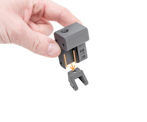

Tensioner wearing off after short period of time.
https://help.prusa3d.com/guide/5-corexy-assembly_835522#845225
Both pulleys broke the same way, however it needs noting that I was able to fix it by replacing the faulty elements (which was quicker than sending printer back and forth to Prusa service center). I do not know if it was caused by a a piece of dirt or something but it locked the screw in place and thus made nut chew through the printed element. Perhaps it needs more solid fill around where the nut is being inserted, i dont know. Just posting for awareness...
BTW Getting the pulley out with locked screw is not easy, if you try tilting it to hard against the belt tensioner it will crack.

Unfortunately i did not make pictures other than ones i posted to the support way back when the printer was still assembled and wasnt working:
https://www.icloud.com/photos/#/icloudlinks/0bd0oncyV2uk1c61D0rBeqVEw/0/
It was in fact one of the support engineers who suggested nut may be spinning inside the printed part hence i was not able to modify the belt tension level
I replaced it with these and it is now working like a charm:
https://www.prusa3d.com/pl/produkt/belt-tensioner-pulley/

...mine broke the same way too... I reused the broken Belt-tensioner-pulley and i melted a thread insert in the tensioner pulley...
Now its fixed and is working perfectly...

mine broke when squaring the gantry up. The part could probably be printed stronger. To avoid this, just make sure that you loosen the belts completely to square the gantry up or the belts will pull as your are squaring it up, breaking the pully holder in half. Belts do not need to be tight to square the gantry up.

Fun fact: I'm going to have to replace it again — and of course, it's the left pulley again. The nut started spinning inside the plastic mount… unbelievable. I'm still having fun with the printer nonetheless, but some components could really use a bit more strength.

To work out what was going on I cut the bolt head off with a dremel and then cut the thin wall away to expose the nut. I found that both nuts had both cross threaded within a few mm of the bolt ends.
This made sense as to why they broke whilst loosening as there is a lot more flex when loose, and the pully wheel housing gets twisted by the belt. Keep in mind that they had been fine up until I loosened them
The Fix
To fix, I simply used two 10mm long brass inserts that I pressed into place with a hot soldering iron. These partially span the gap where the square nut was (so the thread starts at the same point), but they also give a longer thread (10mm) and hopefully prevent any future cross threading. They do poke slightly through to the curved surface near the belt/wheel, but do clear it by a around 5mm.

Same thing happened to me with the right belt tensioner and pulley. Fortunately i have a Prusa XL and PCCF, so i printed the replacement parts.
But both parts do not fit together 🙁  The pulley is slightly too big or the tensioner "rail" slighly too narrow for this step:
I printed them with an 0.4mm Obxidian Nozzle, the default Prusament PCCF preset and 15% grid infill and 0.2mm STRUCUTRAL layer height.

PCCF profile default has an extrusion multiplier of 1,04 but for me I needed something like 0,96 or 0,97.
Also note that the Prusa parts actually use three perimeters and you can opt for a bit more infill than 15% as well. Maybe 25/30%?

An EM value of 1.00 gave me a part that fitted nicely (still on the tight side) and into which the square nut fitted reasonably well.  I can see how 0.97 might have been even better though.  I'm really curious why the default is 1.04.

I spent most of yesterday taking the VFA thread off-topic (oops!) because I also suffered a seized tension nut when trying different pulleys to potentially mitigate the VFAs.
It seems like the tension nuts are seizing not because of cross threading, but maybe due to 'galling' between the stainless square nut and the stainless screw.  This might explain why properly finctioning tensioners can suddenly seize up.  If this is what's going on, then it's reasonable to expect it to become more common with the increased tension that Prusa are now specifying in their web-based tuning app.  The increased belt tension implies an approximately 50% increase in the tension force on the adjuster screw.
A little bit of thread lubricant on the screw threads will likely prevent the galling.
Alternatively the use of a brass threaded insert instead of the square nut, as already implemented by a couple of posters earlier in this thread, should also prevent galling.  I've made a modification to the original part to make it more suitable for a threaded insert - it's on Printables here.  It is designed so that the insert should be pushed in from the pulley side, with a shoulder for it to push against on the screw side - this should make it less likely to pull out under tension.
