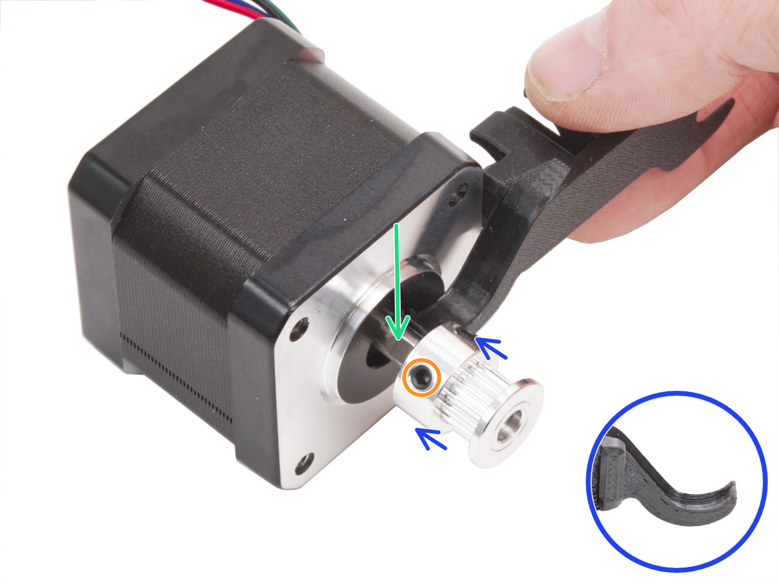

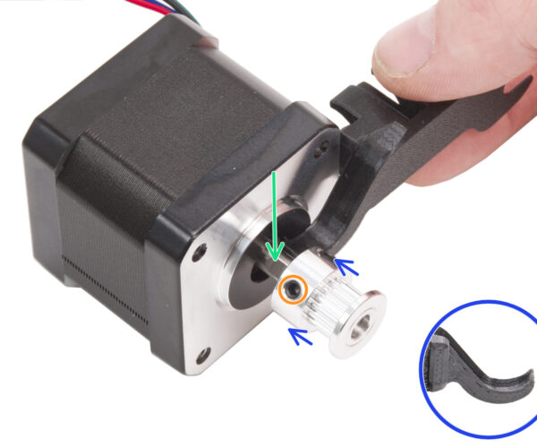

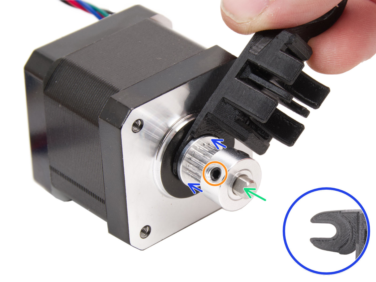

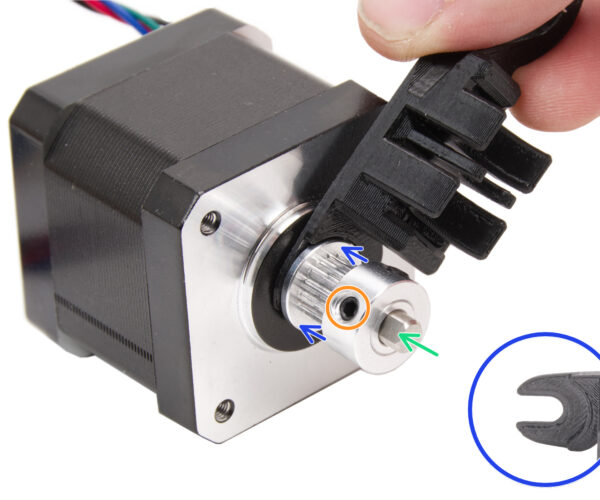

darkmattermaker
(@darkmattermaker)
RE: Squaring the Gantry - Going Crazy
Have you verified the pulley installation is correct on the x- and y-axis motors? There's been several people who have installed one (or both) upside-down. They need to be oriented very specifically as shown in the assembly guide:
https://help.prusa3d.com/guide/5-corexy-assembly_835522#843284
x-axis:
y-axis:
Posted : 11/06/2025 7:45 pm
jfbyers
(@jfbyers)
Posted by: @darkmattermaker
x-axis:
y-axis:
Me! Thank you for this!
"Just" the x pulley was backwards.  I was very careful doing that. The gap to the motor was perfect.🙄
Very frustrating, but I guess that's one of the things the test is good for.
I pulled the side panels off, pulled out the motor bolts, put a wrench though the belt while juggling the motor and pulley.  Worst part was fighting the nylon rivets.
By the time I figured this out, my gantry was straight and belt tuning was pretty easy.
