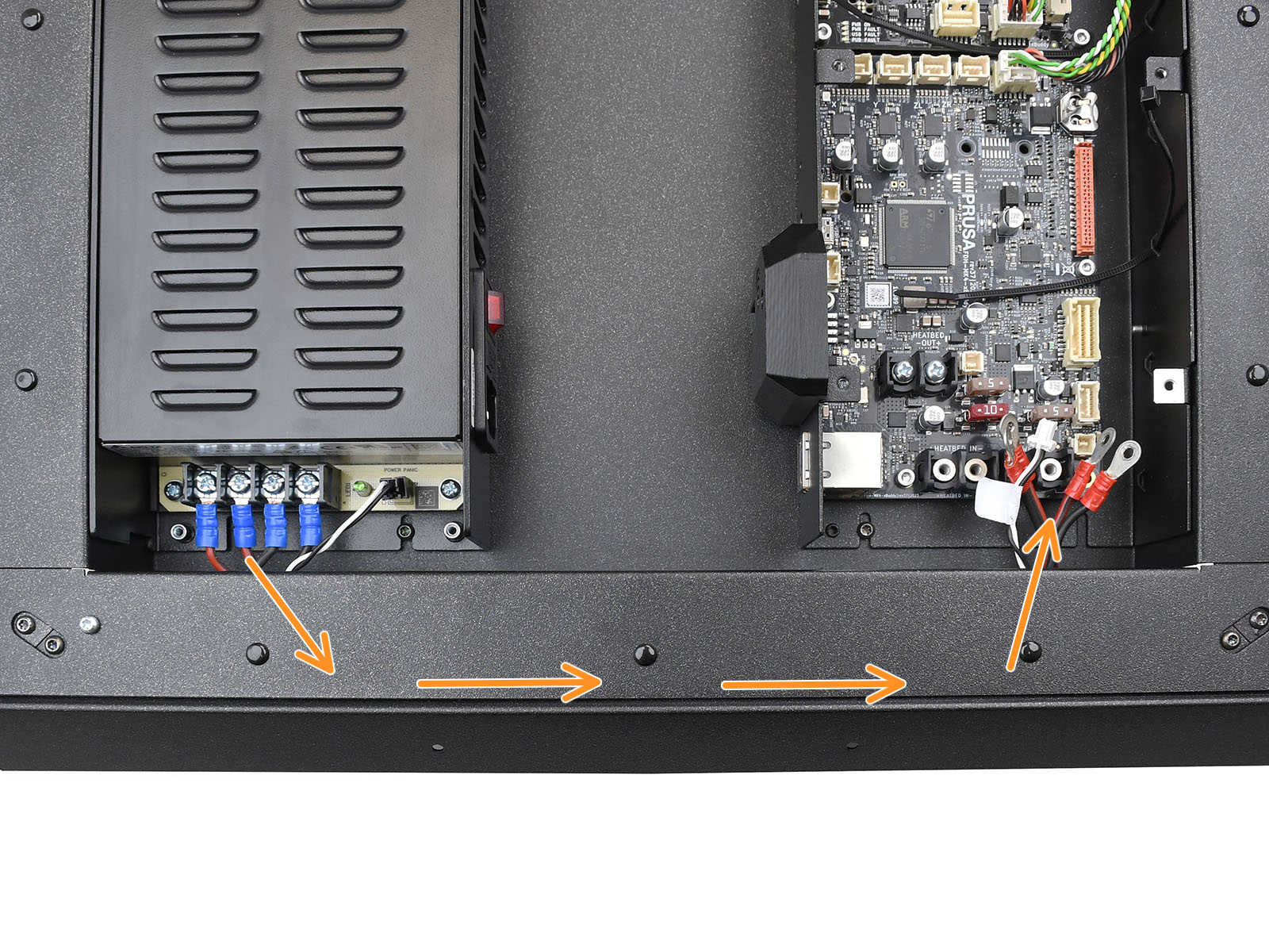

Very good videos. I think the power cable management is the issue; normally they run through the frame...

Not seen that image before where the cables run through the actual rear panel? Prusa instruct to use the cable cover just above......
