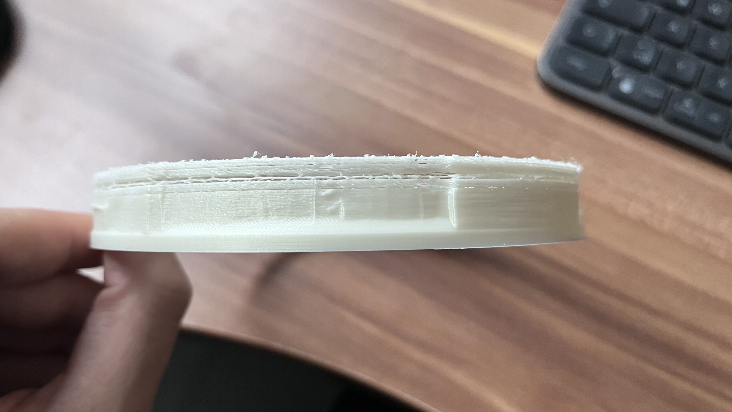

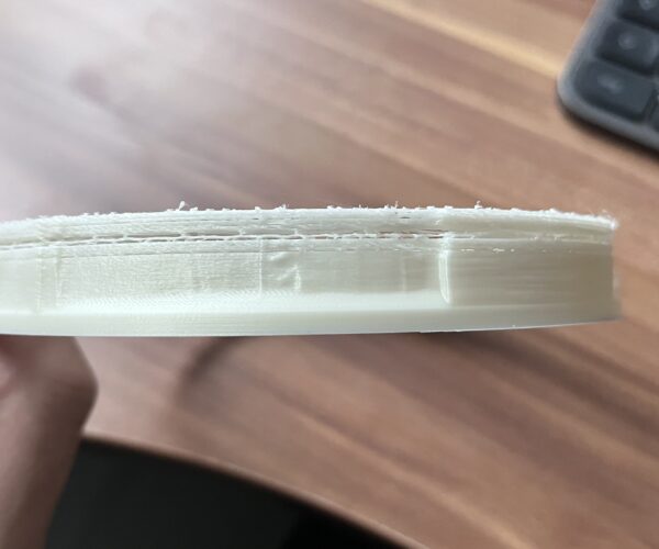

I’ve attached a photo of my last catastrophic print. I wasn’t in the room, otherwise I would have stopped it earlier. At around 11.5 mm you can already see the first issues where the extruder stopped feeding filament. Then it seemed to work again for a few layers before several layers were printed in mid-air again.
I’m using the standard 0.10 mm FAST DETAIL profile for printing (okay, as mentioned, with reduced speeds), and the Prusament PLA filament preset with the flow factor left at the default value of 1. When I just checked the filament profile in the slicer, I noticed that the nozzle temperature is set to 230 °C by default. On the Prusa website, only 215 °C is listed. That surprises me a bit. As I said, I haven’t had any problems with the standard profile so far — except now. But maybe simply lowering the nozzle temperature could help?

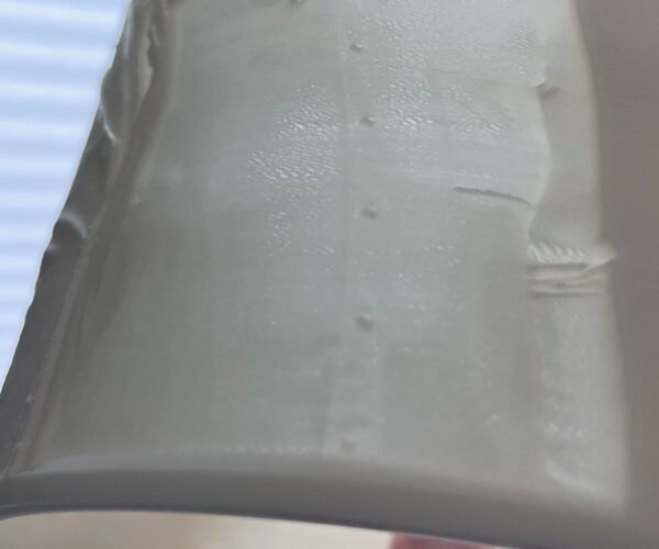

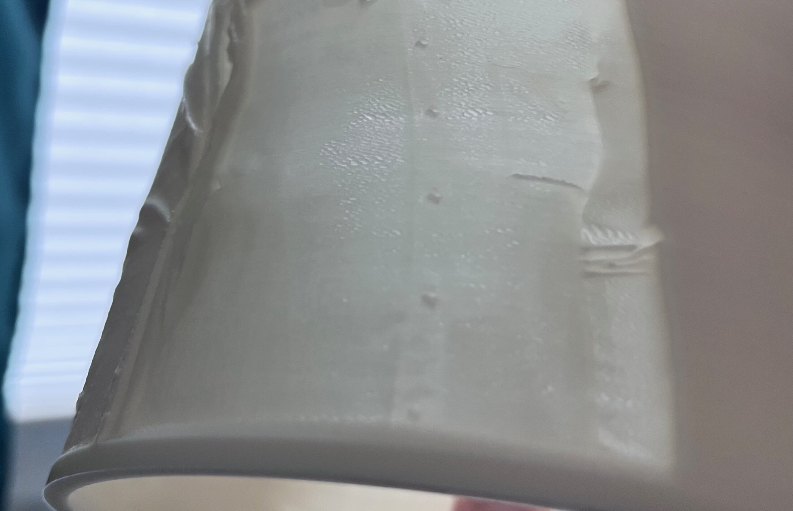

Now I actually have another problem, which would probably fit better in a new thread. I’ll try it here anyway… In some places I can see small holes in the print. I can rule out a clog — it’s too systematic, over several layers, and I don’t think it’s a printing error. With a lithophane you might assume it’s just brighter areas in the photo, maybe a light reflection — but it isn’t. There’s also nothing visible in the slicer; everything looks normal there.
However, it’s worth mentioning that after generating the litho, the slicer detected and repaired quite a lot of errors (30,000+) as well as 10 open edges. From what I’ve researched, that seems relatively normal for lithos. Could that possibly be related?

Hello, it seems the Nextruder doesn't like slow printing, or rather, low filament flow rates. The heat isn't dissipated quickly enough, leading to premature melting of the filament in the heat break zone and resulting in partial clogging, which in turn causes underextrusion. I recently observed this myself with TPU Extrudr Flex hard. At a maximum extrusion rate of 1.5 mm³/s, I had very poor results in terms of underextrusion and surface quality. At 3.5 mm³/s, it was okay. Therefore, a certain throughput seems necessary to keep the melt zone stable. Could you mark which holes you're referring to in the image?
