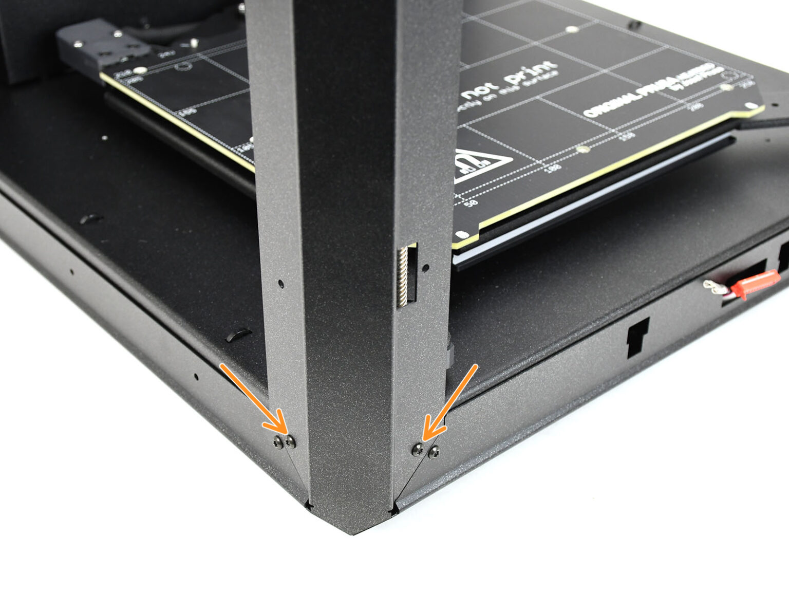

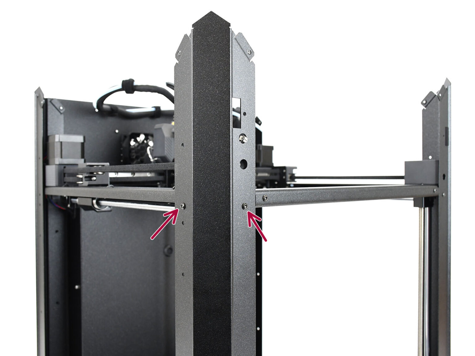

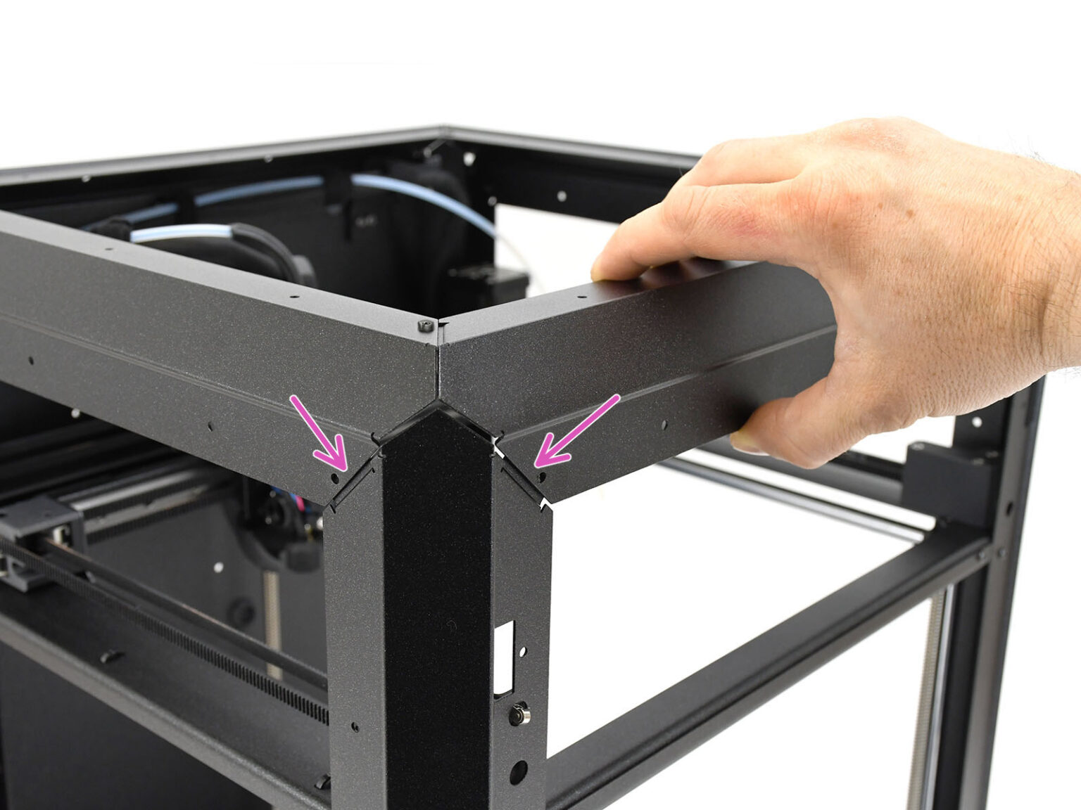

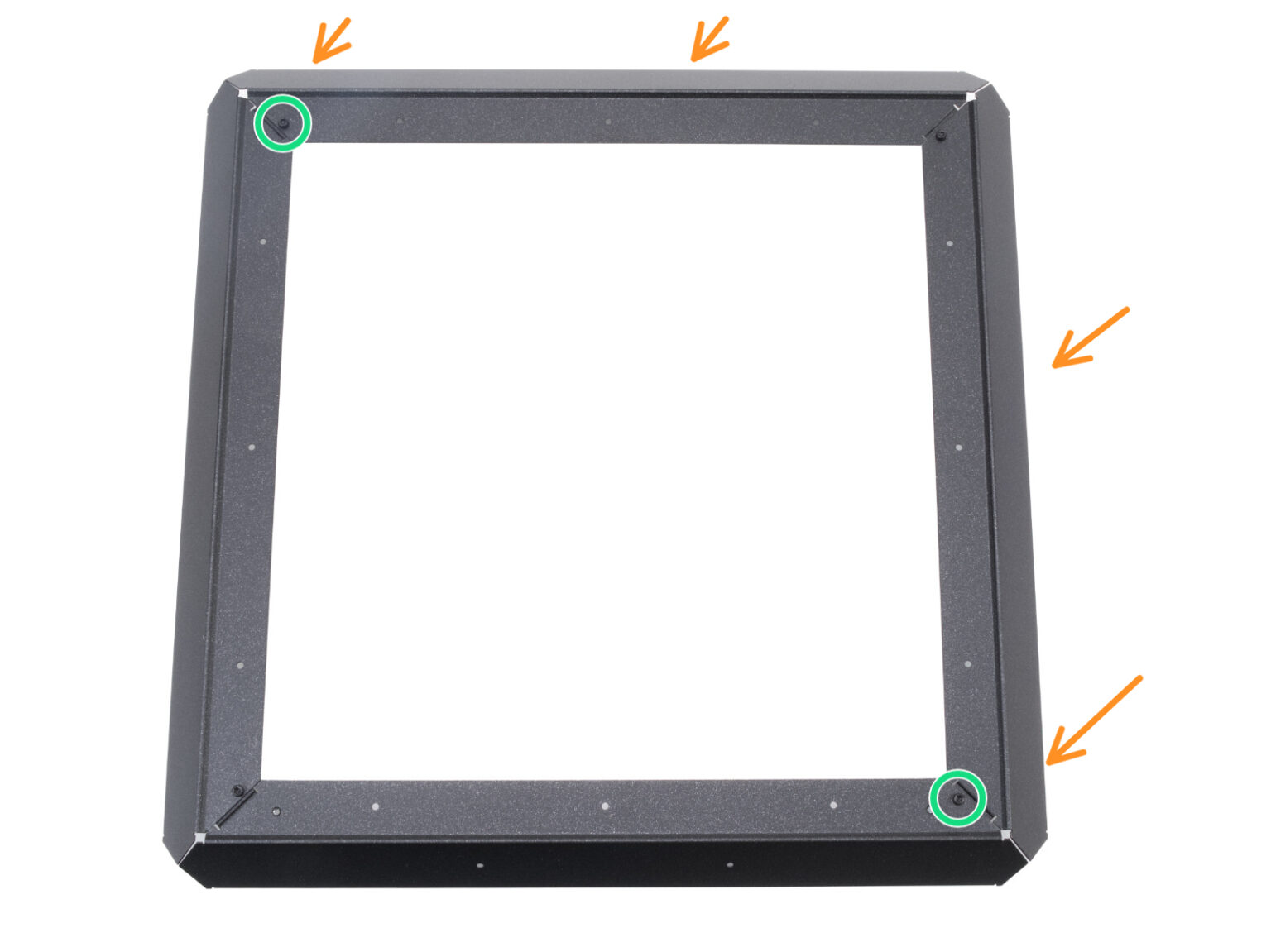

Thomas D.
(@thomas-d-2)
RE: Printing head calibration going wild
Posted by: @raaz-2
Without pre-heating, does the "Auto Home" from the Control menu on the printer work fine and only bangs about 8x in the corner?
I did not check this before reaching the customer support. The support suggested me to check the alignment of the CoreXY structure. It was off only a fraction of a millimeter on one side. However I couldn't fix this while having the same tension of both the belts. Because of this I loosened all the screws of the frame and then re-tighened them again. After that the alignment of the gantry was perfect.Now the printhead still hammers a few times, but it is way shorter now (only about 10 seconds).
Obvisouly the frame was not aligned in a 100% perfect right angle. I had tightened them during the built before the side plates and covers.Now with the covers and side plates the angles seem to correct themselves if you loosen the screws a bit.
These are the screws that I loosened and tightened again:
Posted : 19/07/2025 2:15 pm
Posted by: @thomas-d-2
This does not make sense to me. How can the enclosure profiles affect the geometry of the CoreXY mechanism?
The CoreXY is a self-contained unit, supported by its single-piece, laser-cut frame. That frame is "suspended" in the enclosure. I don't think that mounting the CoreyXY frame to the enclosure can actually distort that frame -- and especially that it can shear the frame in a way where the X vs. Y axes are not orthogonal in the XY plane.
Posted : 20/07/2025 8:59 am
