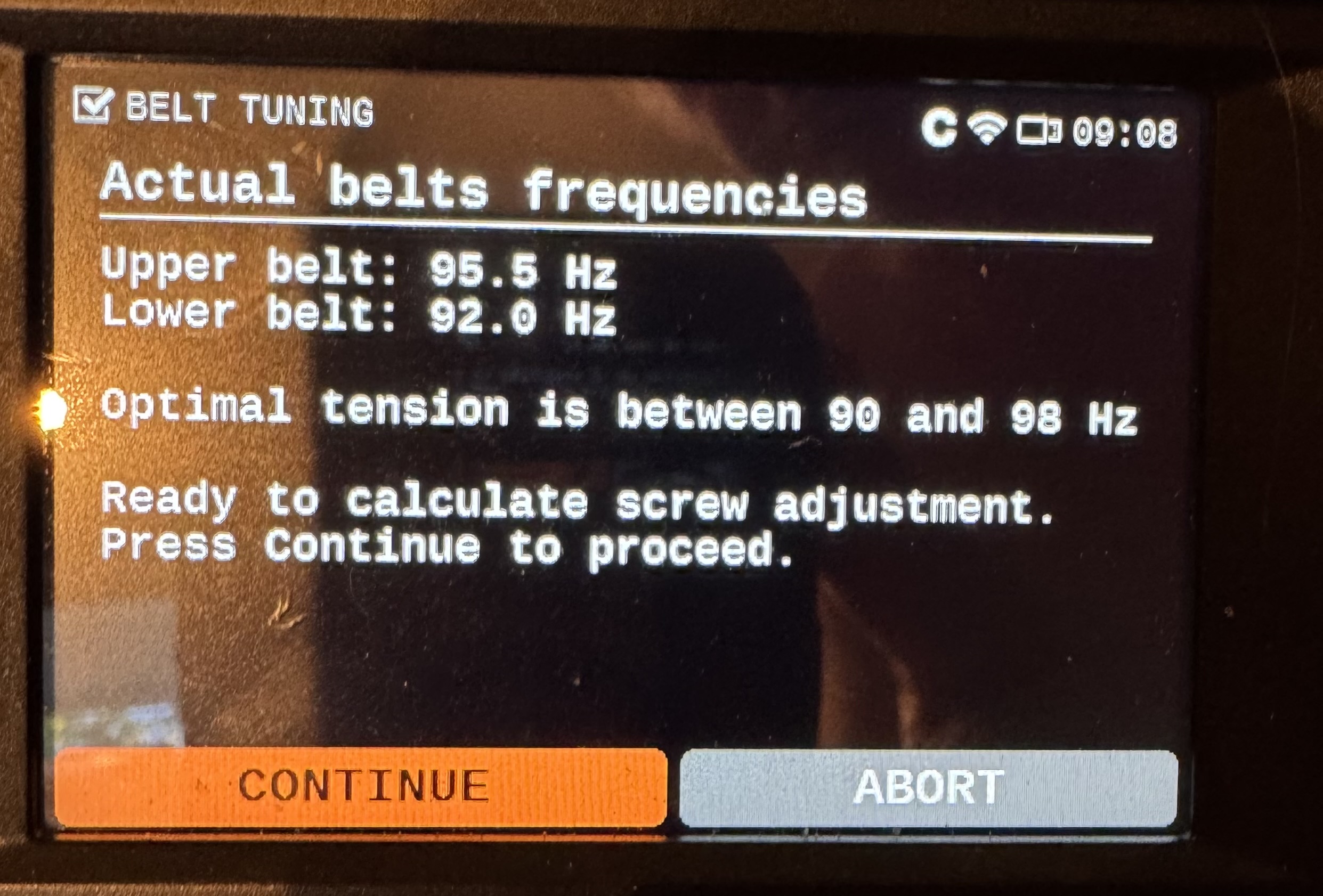

NickAtNight
(@nickatnight)
Excellent point.  I should recheck my tension now that I have upgraded the software from 6.3 to 6.4. The belts had relaxed a bit from the original tensioning and had to be retightened 1/4 of a turn.
The Phone/plucking option worked fine.
The new method works great also.  Perhaps the wording of the step could be improved slightly.  It says:
Upper belt actual frequency
Turn the knob to adjust frequency. Look
for slow belt movements with sharp,
regular peaks, then click the knob to proceed.
95.5 Hz
I went through the Tuning step a number of times to gain familiarity with the program. I found the wording in the linked instructions /screen a bit confusing.
My understanding is that WE have to manually adjust the knob UNTIL we see the belt resonate. Whatever we select as the frequency is what the program will use to calculate the amount of adjustment needed to tighten the belts to the correct frequency. It tested that by entering an very low frequency of 88 Hz that was out of the resonance range. The program recommended a tightening of the belts. When I restarted the test, the program started from the last frequency given.

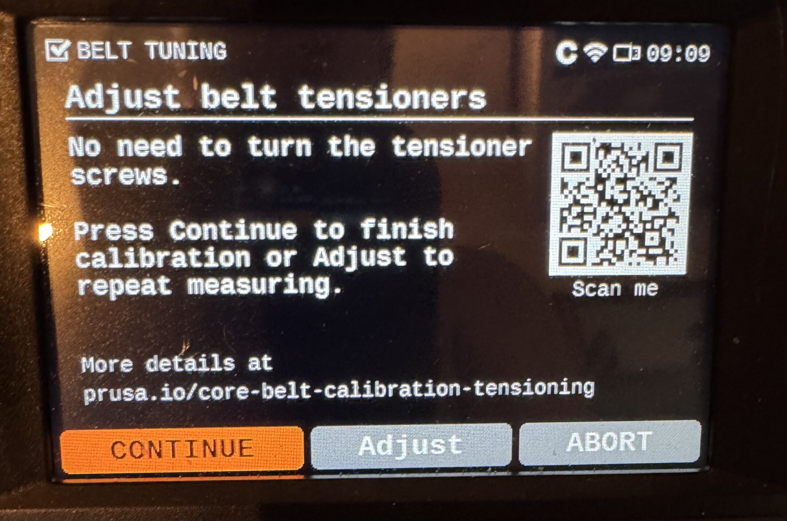

The Wizard is NOT measuring the frequency. The USER is using the knob to adjust the frequency UNTIL the USER observes the resonance frequency occurring in the belts. The Wizard is dependent upon our observation.
Perhaps the screen should say:
Upper belt observed frequency
Turn the knob to adjust frequency until the belt resonates (Large slow belt movements with sharp, regular peaks), then click the knob to proceed.
BELT TENSION
FINAL SCREEN
Posted : 10/12/2025 3:39 pm
RE: Is this normal?
Yes, it could be worded more clearly. Maybe something like this?
  • The wizard varies the frequency of belt excitation and stroboscopic light (under user control).
  • The user observes the amplitude of the resulting belt resonance and tells the wizard when it is maximal.
  • From that, the wizard determines the current resonant frequency and belt tension,
  • and derives the required tensioner adjustments to get to the target values (while maintaining symmetric belt tension).
