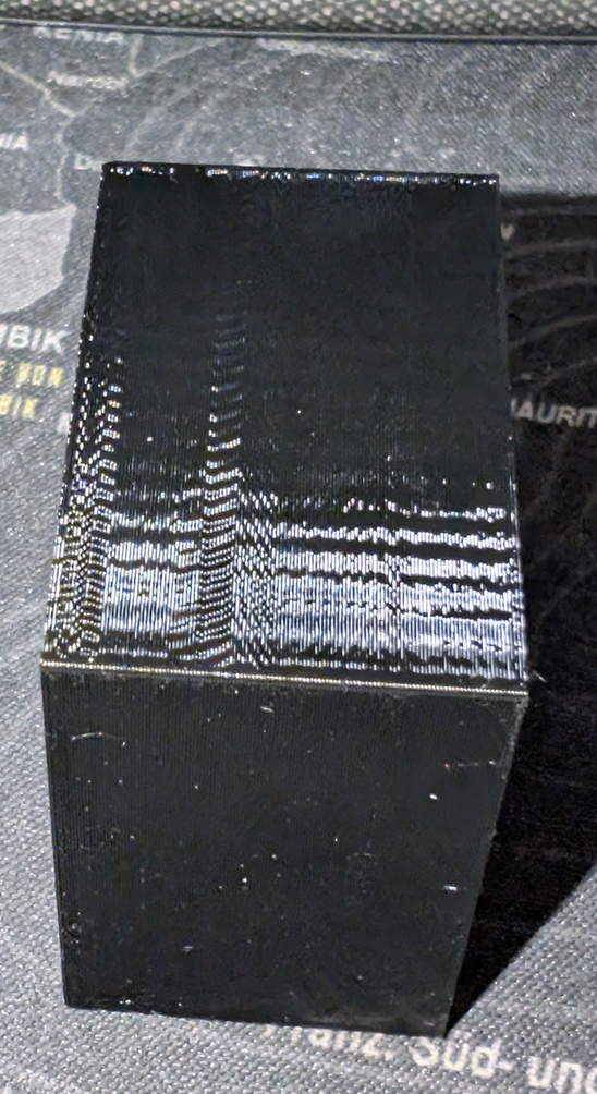

Hello
Two parts printed from one gcode. The first one had normal surface few first mm. Than I've got a really strange pattern. Looks like a PG pattern, would I say...
All other tries after this one looks similar. Changed nozzle and profiles, reduced volumetric speed - always look similar. Belt tensions is okay
What could be the problem ?

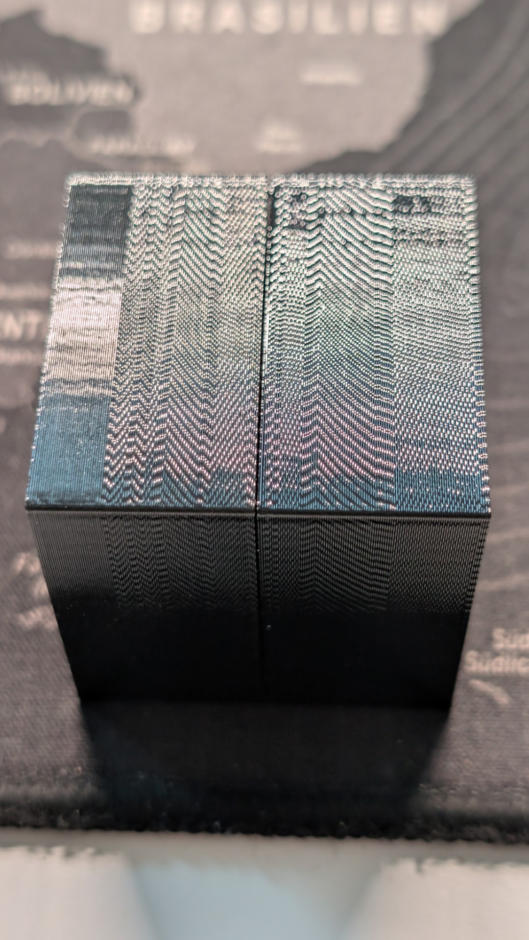

I've changed the nozzles (have obxidian, normal and high flow - all 0.4), changed the hotend thermistor, changed the heater block with platted copper one (bought a spare one).
Made a lot of additional prints and found really smth strange - the PLA samples are almost always are ok. But not always. And PETG only sometimes, usually 5-6 mm from the beginning are ok - after could start, than start getting this pattern. I've tested different PLAs and PETGs - the original from Prusa and some others, with different flow (also tried to increase flow, decrease a speed in the menu during the print). I've dried the PETG to make sure, that water isn't the problem. I've testet different positions of the idler screws. Checked (released and tighted again) the both X/Y pulleys.
I'm started to think, that smth wrong is with extrudr motor or PG or heatbreak - it looks like, smth is overheating after sometime. Because of the thermal expansion this could lead to some jamming.
Pause of the printing for few minutes and than starting again (with intermediate releasing of the idler) sometime leads to 1-2-3 mm of the normal perimeter, than it prints with such pattern.
P.s: Both thermistors (hotend and heatbed) are died one after another in the short period of time. With hotend thermistor it was easy, but the one from the headbed had a thermal runaway and was not precise any more, so the print could have stopped in the middle with red screen of death. So, this could be the issue with lifespan of the prusa parts?

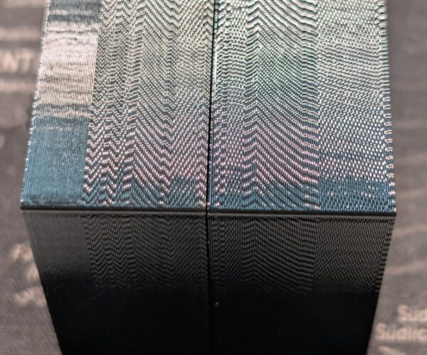

Seems, I found the real reason for that - somehow, when advanced filtration fan speed is over 60-65%, the printer produces such uneven walls. This explains why the PLA prints has no such problem, if printing only PLA. The chamber temperature isn't so high, so fan speed is slower.
Changing of the fan speed during printing produced different kind of surfaces:
Now is the question - what is wrong? Power supply? Cable management (signal for the filtration fan disturbs the signal to the extruder motor)? Defect fan, producing a noise in a circuit ?
I'll try tomorrow to contact the Prusa support. May be, they now smth about this....
