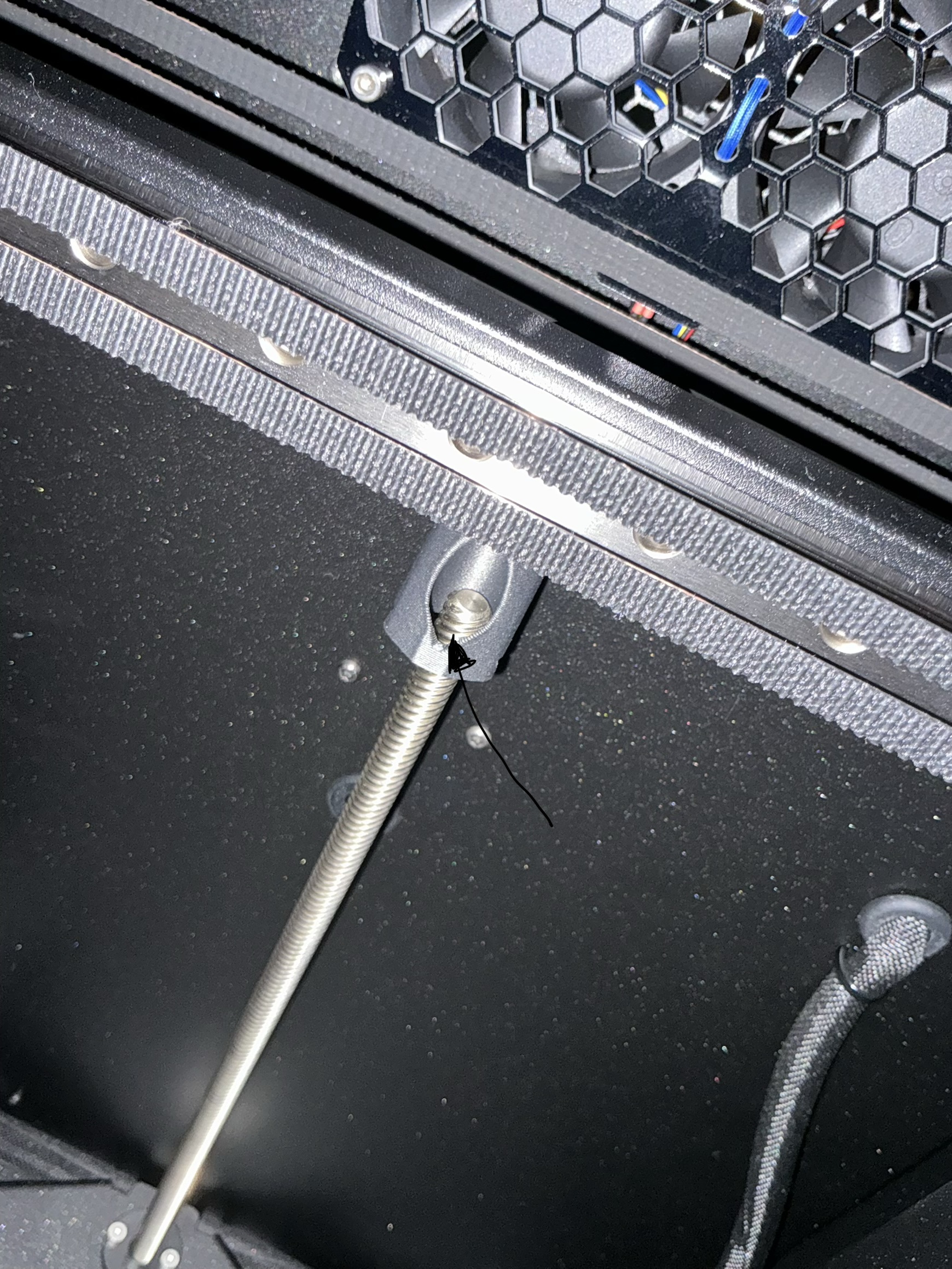

Hello all,
I encounter an annoying issue with the printer.
Both of the three Z axis are lightly off-centered of the respective end parts.
The two front axis are grinding inside the aluminium fixing parts when moving up and down.
And the rear axis is rumbling inside the Bed-stop at some different positions.
i have double (triple) check the assembly and there is no visible problem at this side.
Is there any tip to solve this issue regarding your own experience ?
Other than that, the print quality is pretty good…
Thank you in advance !

Drive the heatbed to its lowest position, then loosen the M3 screws which hold the three black trapezoidal nuts that travel on the lead screws. Loosen all six screws at once, then re-tighten them. Do not overtighten since the nuts are made of POM, i.e. plastic.
This will allow the nuts to settle into a strain-free lateral position. (The heatbed's lateral position is defined by the smooth rods, and the nuts & lead screws must align to that.) It avoids lateral forces on the lead screws, and should leave their top ends reasonably centered.
Printables has a handful of  mods which add bearings at the top end of the lead screws, to force them to a centered position there. I do not recommend these. They will over-constrain the lead screws, causing increased mechanical tension and friction.

As described above, you can adjust the nuts, but I'd take it a step further. Spin the nuts up the screws a bit so nothing is affecting the position of the screws. They should be centered in the pockets in front (or at least not be rubbing much) and the rear plastic piece should be adjusted so the rear screw is centered. If that condition doesn't exist, something else is wrong, maybe something bent or not seated where the motors mount. If all is good, you should then adjust the nuts and possible other local parts. Note that the nuts are supposed to be rotated to a certain position per the assembly instructions. I think that has to do with the bed zeroing out cleanly with the natural stepper detents, but not sure.

It's confirmed, I'm a few card short of a full deck. The motor detents are too small for this to matter. What I did discover was that I could improve the friction by readjusting the nuts, in spite of believing I had it as good as possible when I built it. I doubt anything moved, maybe it wore in a bit. At any rate, the lead screws should move fairly easily by hand over a short range. Not a fan of the idea of lubricating it to correct a problem. It should work fine dry.

I would also prefer to run the lead screws without lubrication, but did lubricate mine right after I built the kit in April. With the "relaxed" nut positions the Z drive never lost steps, but made that "Chewbacca noise" during extended moves. Lubrication with the grease included in the kit fixed that, and I have not noted any detrimental effects yet. Fingers crossed!

I successfully followed the tips and managed to cure the issue ✌🏻.
