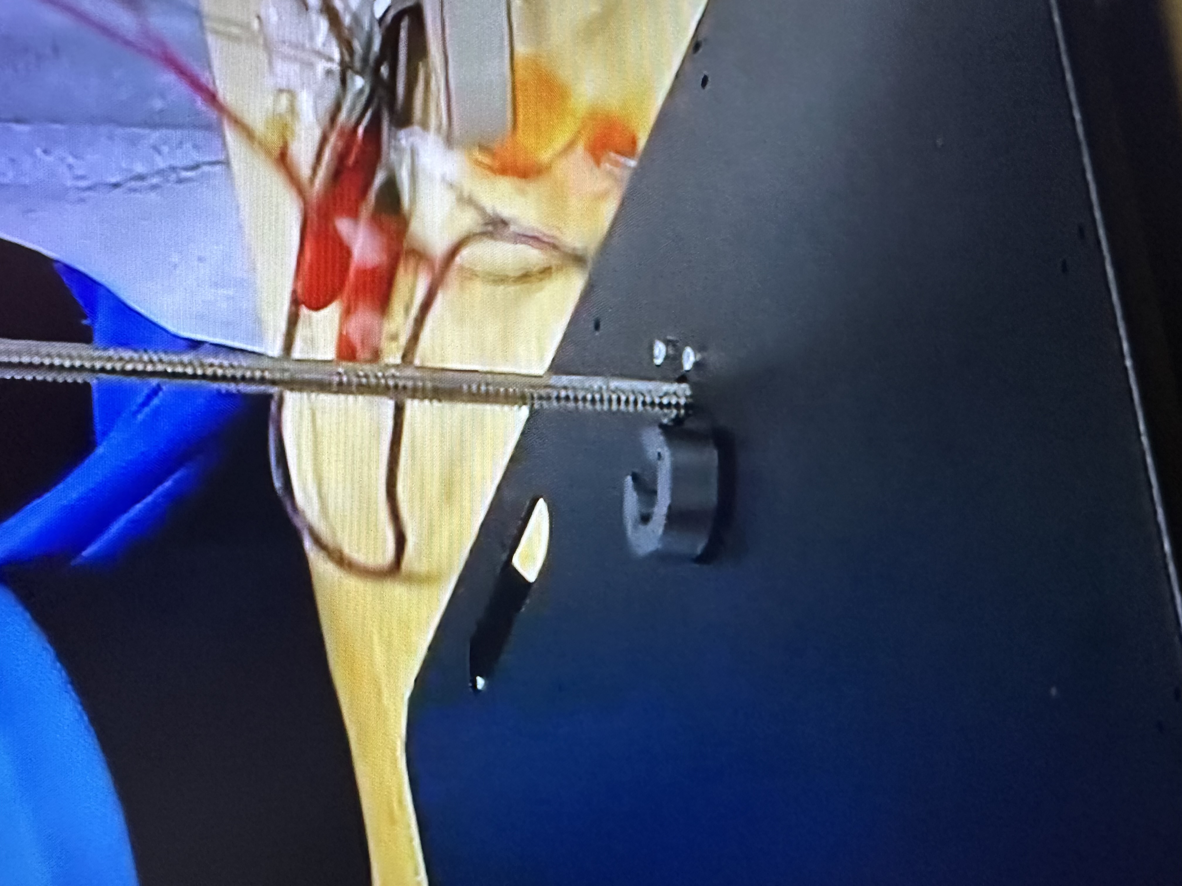

I received my long-awaited Core One yesterday, and its been a bit of an adventure setting it up. WiFi doesn't work on my machine, but I'll troubleshoot that later. my pressing concern is that my machine was shipped without the two retaining nuts for the rear Z-Axis trapezoid nut. As a result, z-axis calibration obviously fails. okay, mistakes happen, however I can't for the life of me get any M3 or M4 screw to take purchase, of any reasonable length. The nuts don't take purchase and fall straight through (M3) or fail to catch a tap for either size. It appears that the two screw holes were drilled but never tapped. its the only explanation as to why no screw will catch. Unless this is some proprietary screw, which I doubt.
Anyone else face a similar issue? any advice would be welcome.
for reference, https://help.prusa3d.com/article/homing-error-13301_401205 here you can see which screws are missing. (under trapezoid nuts, rear motor, first pic)

1. The build plate doesn't have tapped screw holes, as I previously assumed. Watching Vector3d's teardown of the Core One on YT revealed that there are 3D printed parts that attach to the trap screw that serve as vibration dampeners and fasteners. My machine was shipped without this printed piece for the rear z-axis motor, as well as the two M3x14 screws. I attached a still of the video where you can see the part. I. believe it is this part: https://www.prusa3d.com/product/bed-spacer-rear/ I will try to print one on my Bambu and report back.
2. The Core One documentation and shop are woefully lacking for a product launch. There is no BOM or teardown instructions available anywhere, and the docs on the website are just haphazard at best. because this machine uses a lot of parts from MK 3 and Mk4, the docs link back to MK specific issues that aren't relevant for the core one. There is no Core One specific hardware kit available on the eShop, so I'm left to my own devices here...

Probably T8x8
 8mm diameter 4 start, 8mm lead 2mm pitch
Trapezoidal thread
