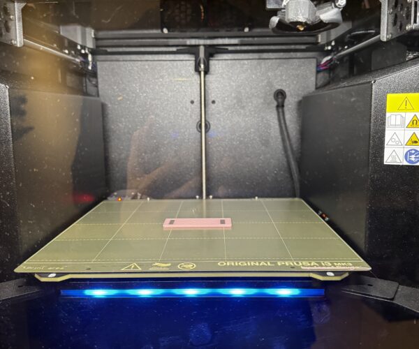

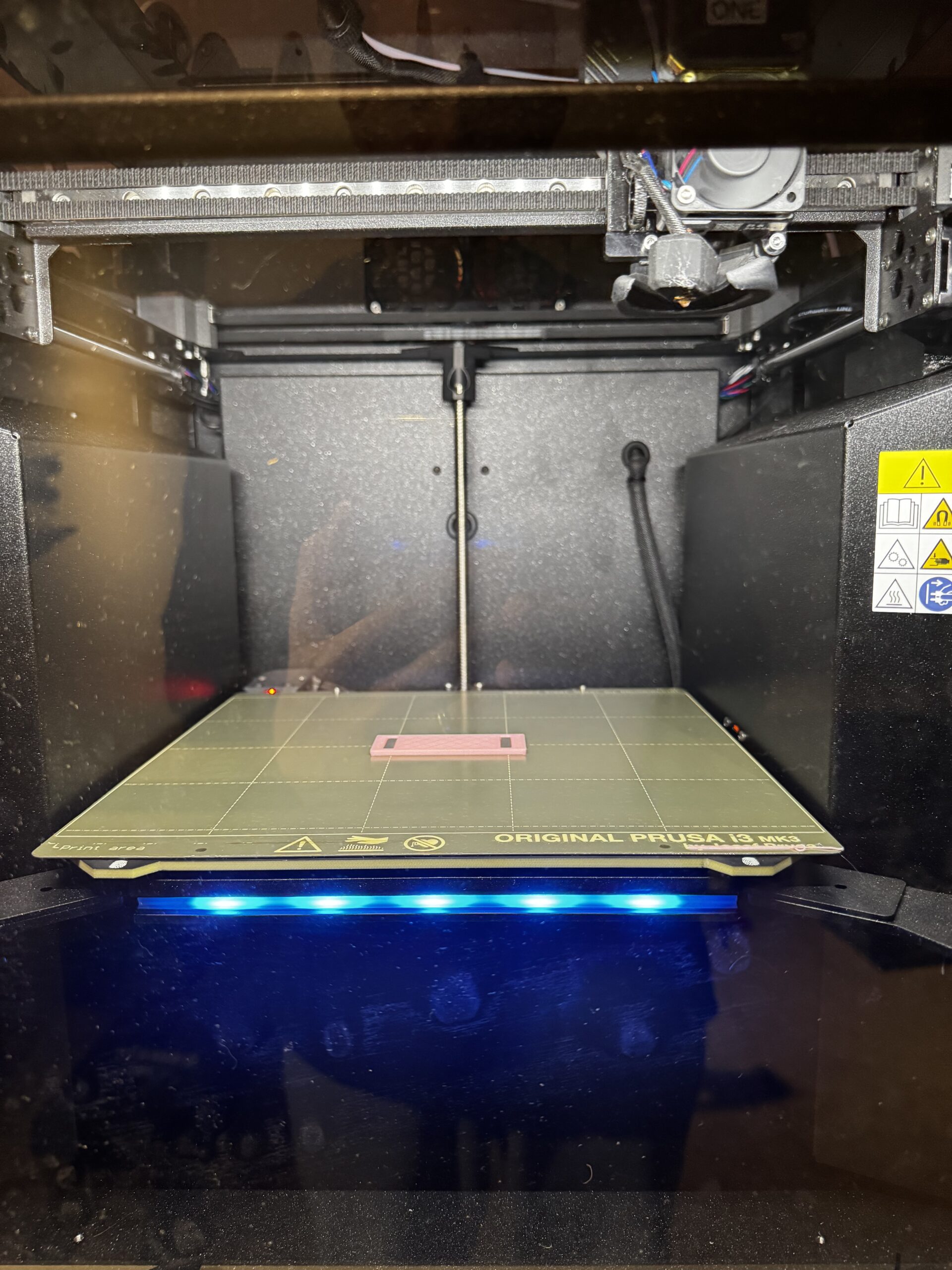

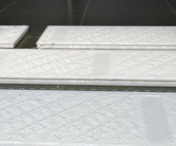

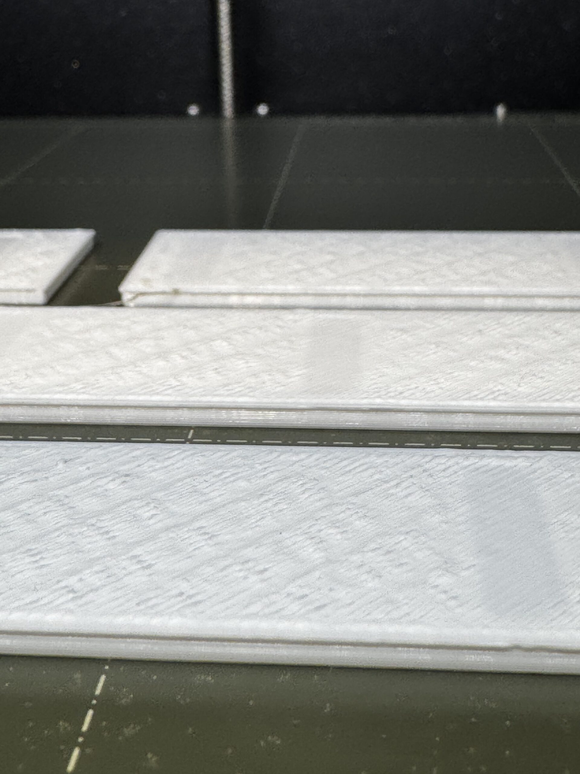

Wanted to print some nameplates with magnets inside so I added a pause at a layer and the CORE One did not do a good job of going back to the right layer. The layer over top of the magnets is too low and the nozzle was constantly scraping the print.

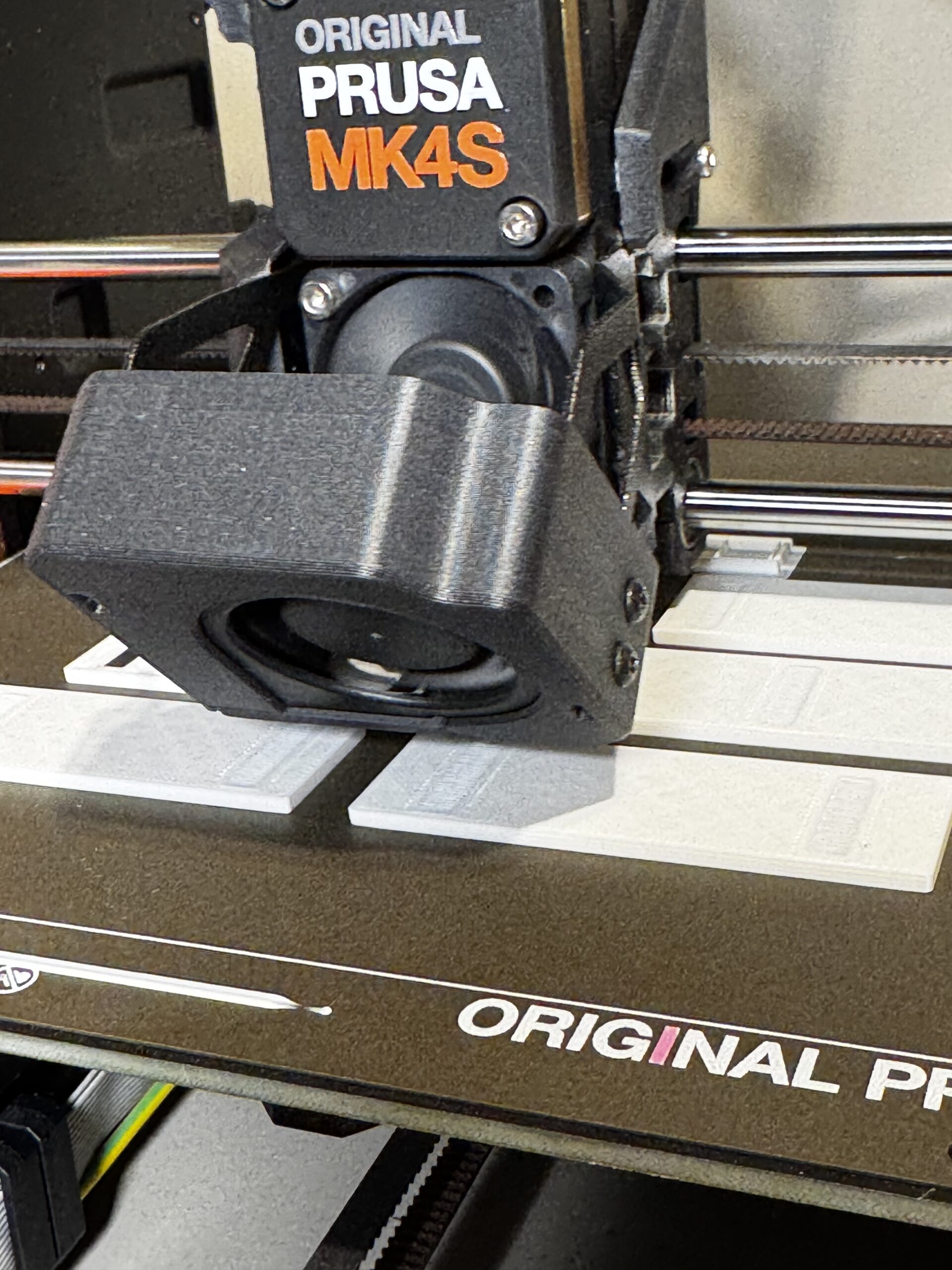

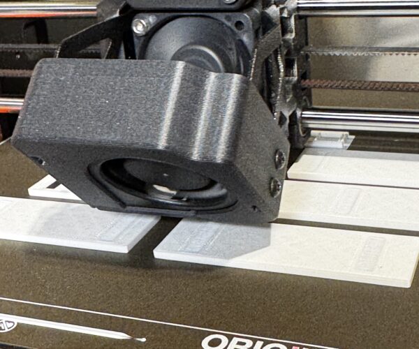

The core one lowered the bed by a huge amount for me to add the magnets, then it cooled the nozzle down and waited. In contrast,  my MK4S just simply parked the extruder at the back corner, kept the nozzle hot, and barely raised the Z height. It produced a beautiful next layer and never struck the nozzle.  I think this will need some tuning in a future firmware update
here’s a picture of my CORE One on the next layers before I stopped it
And here’s my MK4 (like butter!)
Here is how far down the bed goes so I can add the magnets. I get it needs to do this because of the bar, but I want it to go back properly.

This seems like something that can be fixed in firmware. It may be worth opening a case on github as Prusa team members don't participate here but are quite active on github.

Just in case people follow here but don't get notified from github, the case there has been updated and acknowledged by CZDanol at Prusa:
Hello, guys, we have identified an issue that I believe might have been the cause for your problems. It will not get into 6.2.2, but I will suggest putting it into 6.2.3, if there will be one. Internal ticket: BFW-6825
Posted : 01/03/2025 10:56 pm
RE: CORE One doesn’t do a good job with pauses
So there is indeed a 6.2.3 firmware now, and it includes a fix for this issue. Now all we need is a firmware release for the Core One...

It's a bug in the firmware: https://github.com/prusa3d/Prusa-Firmware-Buddy/issues/4505
