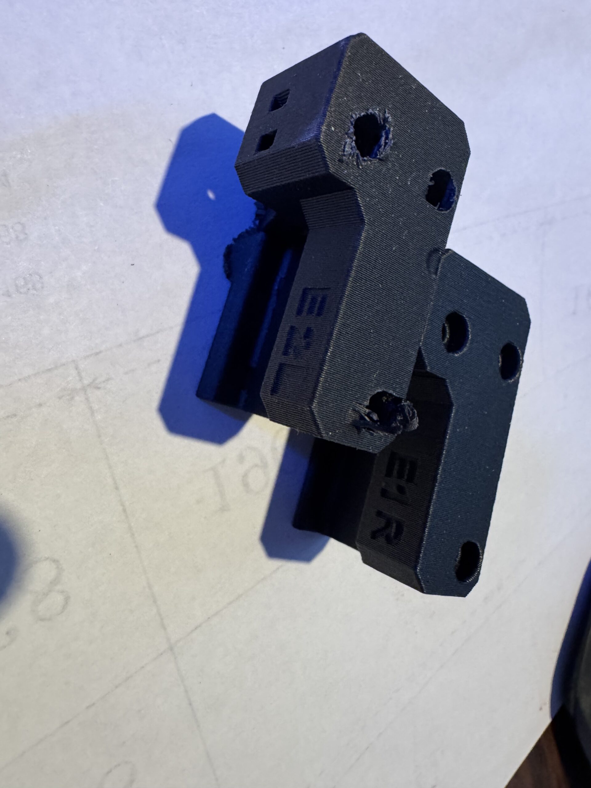

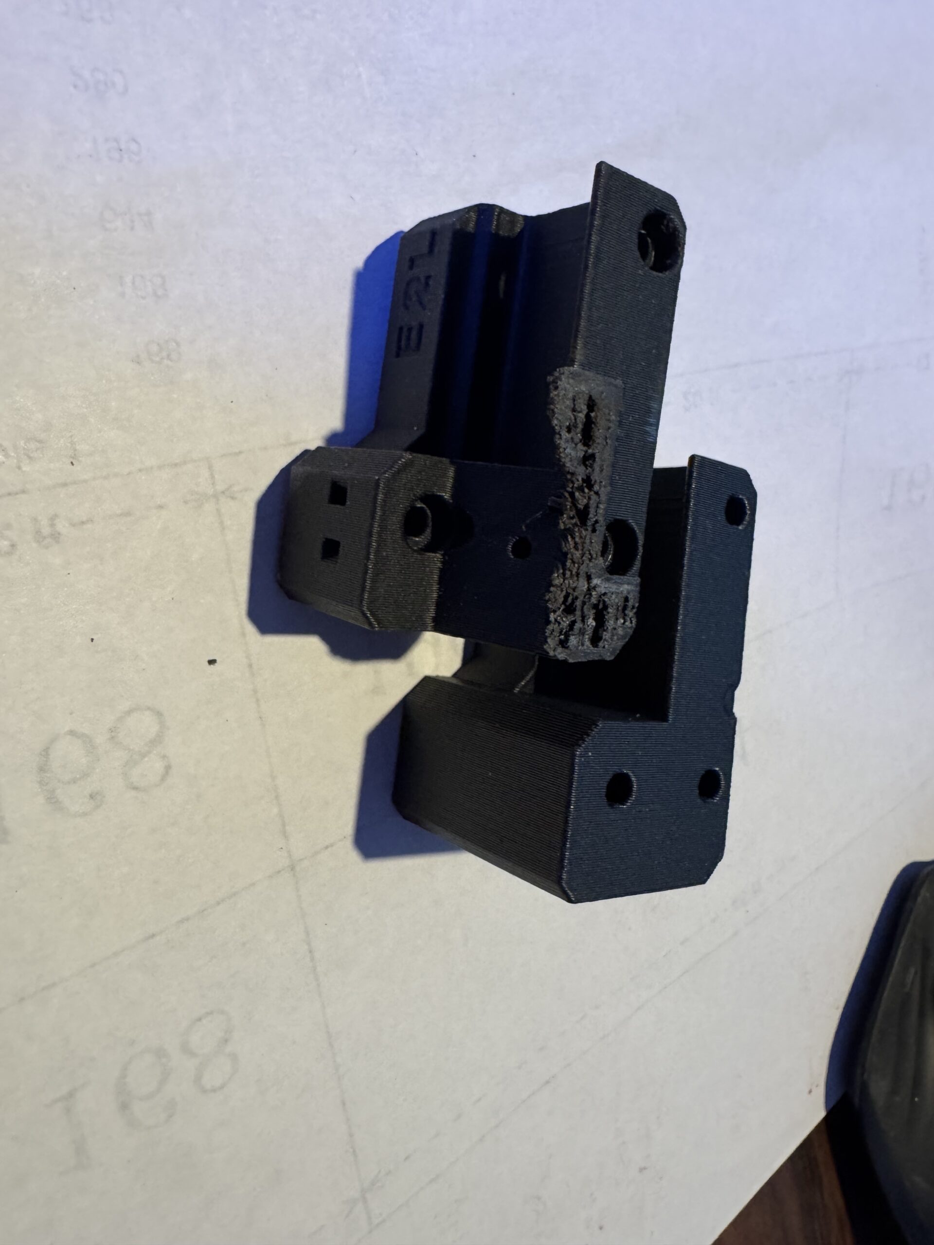

Hello @yamighor,
I had that exact problem.  I contacted Prusa, they shipped me a new part. (E1R).  Installation was (mostly) put on hold for four days.
SHORT TERM SOLUTION:  What I did short term to push on past the problem was to modify the extra part to fit:
  1: I observed the shape of the piece that was needed (E1R) was similar to the shape i had (E2L)
  2: To modify it, I used a hacksaw to cut off the raised section on top so that it would lay flat.
  3: I then flipped the piece over.
  4:  I then used a 7/16" drill out the three holes to make a counter sink sufficiently large to hide the bolt heads.
  5: This revised piece is very similar in size and shape to the actual E1R piece.
  6: It allowed me to continue the building process to complete the step and obtain the delicious Habro Bear Reward.
  7: When the actual piece came in, it was very simple to swap out the jury rigged piece for the real piece.
SWAP:
  1: Remove the three bolts holding the piece in place
  2: Remove the belt tensioner assembly and bolt.
  3: Put the belt tensioner assembly and bolt on the new piece.
  4: Put the belt around the pulley
  5: Mount the new piece to the frame with the three bolts.
PHOTOS: Comparing the shipped E1R to the modified E2L
1: BOTTOM
- Shows the (poorly) counter sunk holes.
2: TOP
- Shows the bit that was sawn off
  2: So
I have two belt tensioner left and I searched on all boxes. What I have to do? Can I print that part with my other printer?
Posted : 10/12/2025 2:13 pm
