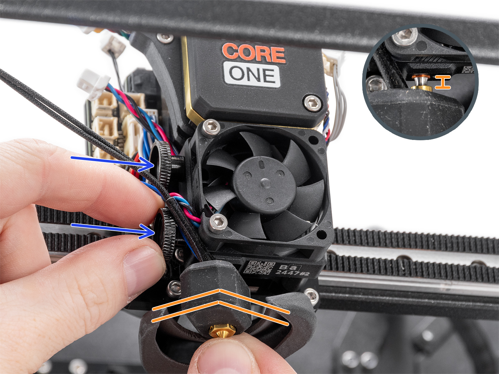

If the Z axis test fails, it might not be related to the mechanical Z drive at all, but could also be due to problems with the load cell sensing. A somewhat common and easily fixed cause seems to be that the nozzle is not inserted far enough into the hotend. There should only be a gap of ~ 2mm between the heater block and the brass part of the nozzle, as shown here.

Because it's taken from an angle, I can't tell from the photo you linked the actual vertical distance that the nozzle is supposed to be. Edit: sorry, I completely missed the inset photo. However, that inset photo makes it look like the red/orange ring is way, way higher than mine could possibly go - as if the red/orange ring itself is pushed up and into the extruder assembly?
The big orange arrows just point up. without any real reference to how far. I've attached a photo of what mine looks like right now. It's too small of a space to fit into to measure with calipers (the only metric tool I have), so I'm not sure if it's 2mm or not. I attached a photo with a tape measure next to it, but it's in inches and I doubt it helps very much because it's the coarse side.
I think my first print may have been messed up, at least in part, because the nozzle was too far down. Since then and finding out from there that I needed to raise the nozzle up, I can't get this z-axis test to pass. It's impossible for me to know for sure, but it _seems_ like the load cell test is maybe also a little more difficult to pass now. I don't have to strike the nozzle hard, but I do have to tap it with my finger fairly firmly to get the test to pass. Touching it on command (even though the little horizontal bar on the screen registers) is not enough to pass the test. It may have been that way from the start. It's really hard to tell - and the screen doesn't show - if the z-axis test is actually coming into contact with the nozzle as it appears to be intending to do.
I don't know if that's part of the problem and why the z-axis test won't pass. It seems reasonable that this would be a way to sense that maybe the plate is at it's highest position. Unfortunately I can't seem to get any diagnostic information from the printer other than the test fails.

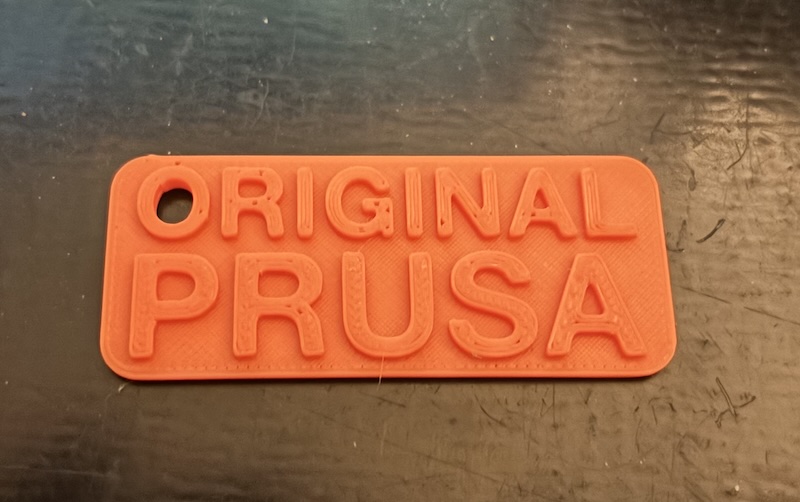

The inset image was the key. Finally got a print. I don't know if I feel relieved that it finally worked or like I accomplished something. Maybe both. To push the nozzle up that far you have to push through some spring tension. It's not much tension, but it's enough that it didn't seem like it wanted to move that far up into the extruder assembly.
With the nozzle pushed further in, the z-axis test passed easily and the load cell test seemed (it's difficult to tell) to take much less force to pass as well.
Thanks for everyone's help and patience while I figured this out.
