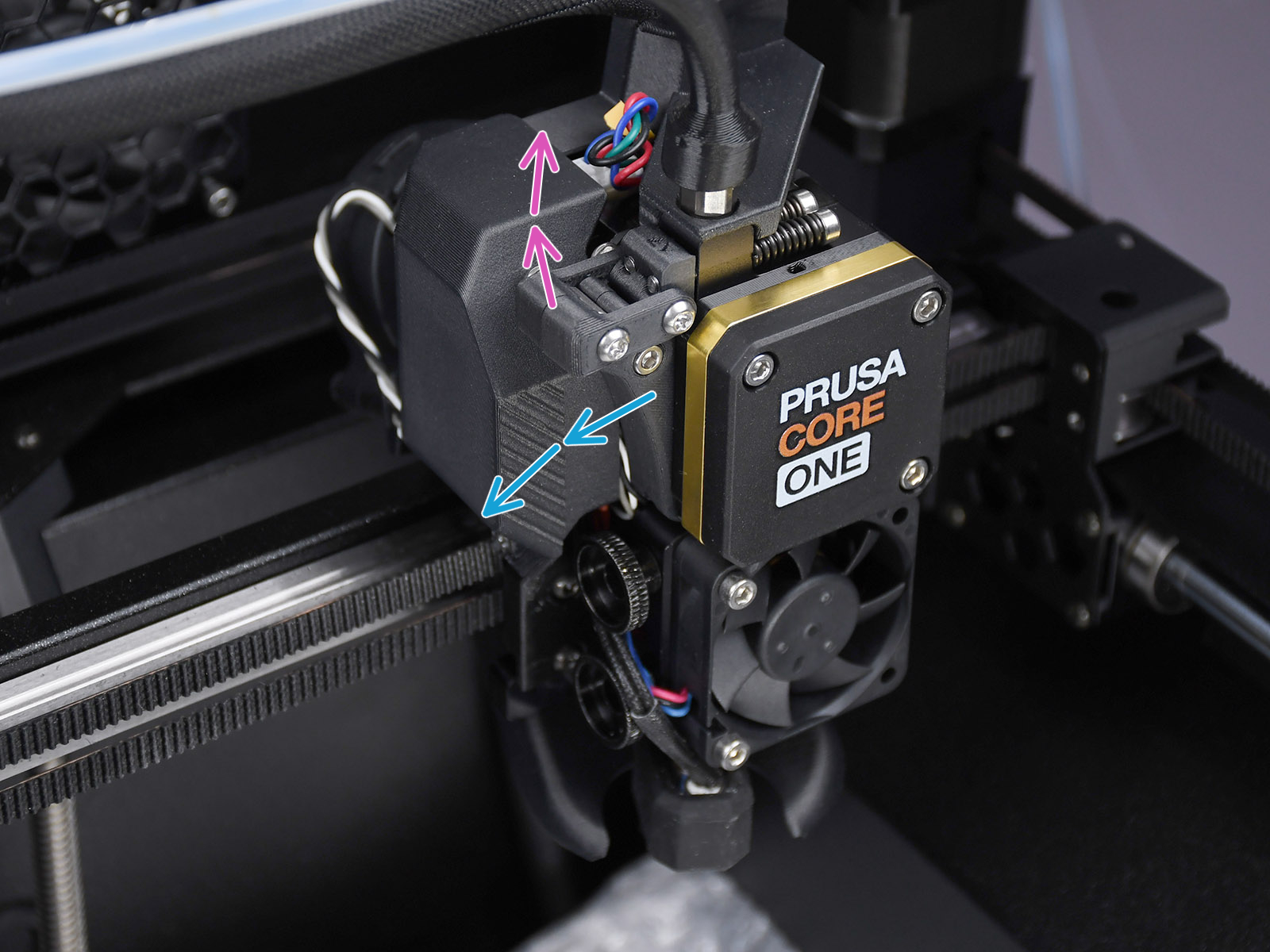

How do you even open the idler? Ther isn't clear instructions anywhere, very frustrating.

The "idler" on the CORE One is the lever/clamp on top left of the Nextruder. To open, lift it upwards as shown in the image below (pink arrows). Then you can open the idler shaft by moving the lever below to the left (blue arrows).
(see also the description from Prusa for regular maintenance of the printer here: https://help.prusa3d.com/article/regular-printer-maintenance-core-one_829710 )
