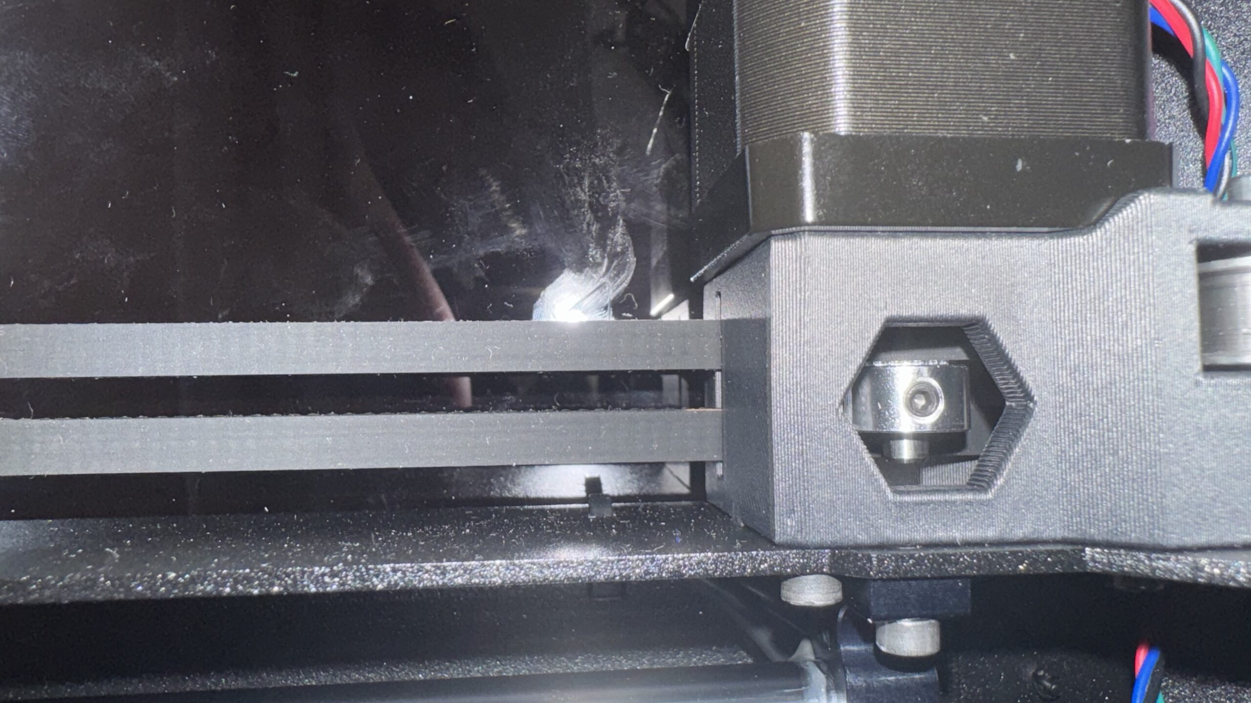

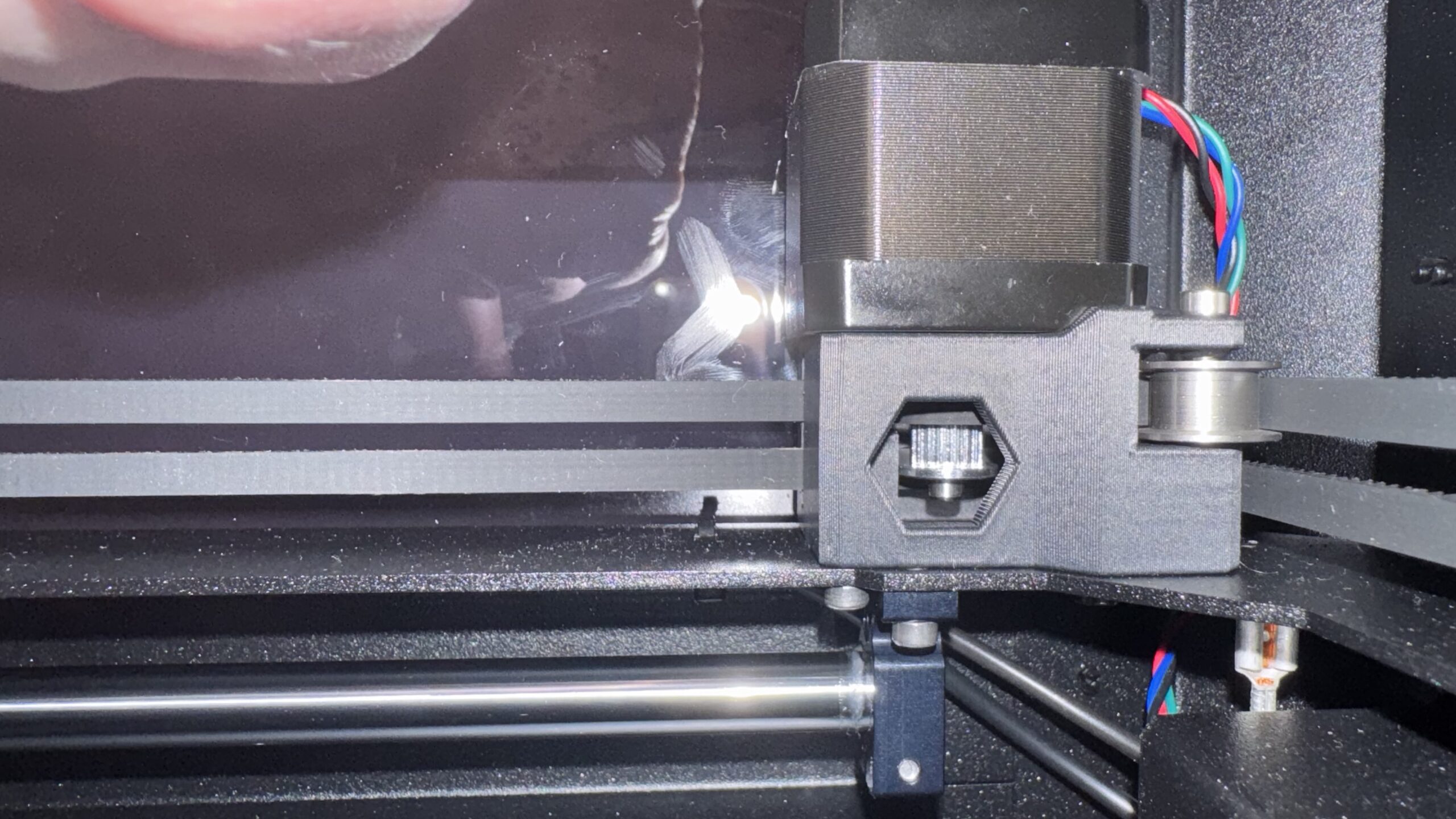

Was fighting the same issue with my freshly built core on kit and was able to fix it…
made a (stupid) mistake while installing the pulleys to the X/Y motors and did not check it… so double check the pulleys on both sides and make sure the belts are centered!
after correcting this, tensioning the belts to 85hz on both sides, the calibration ran through on both axis.
before and after pics
This post was modified 11 months ago 2 times by mosch
