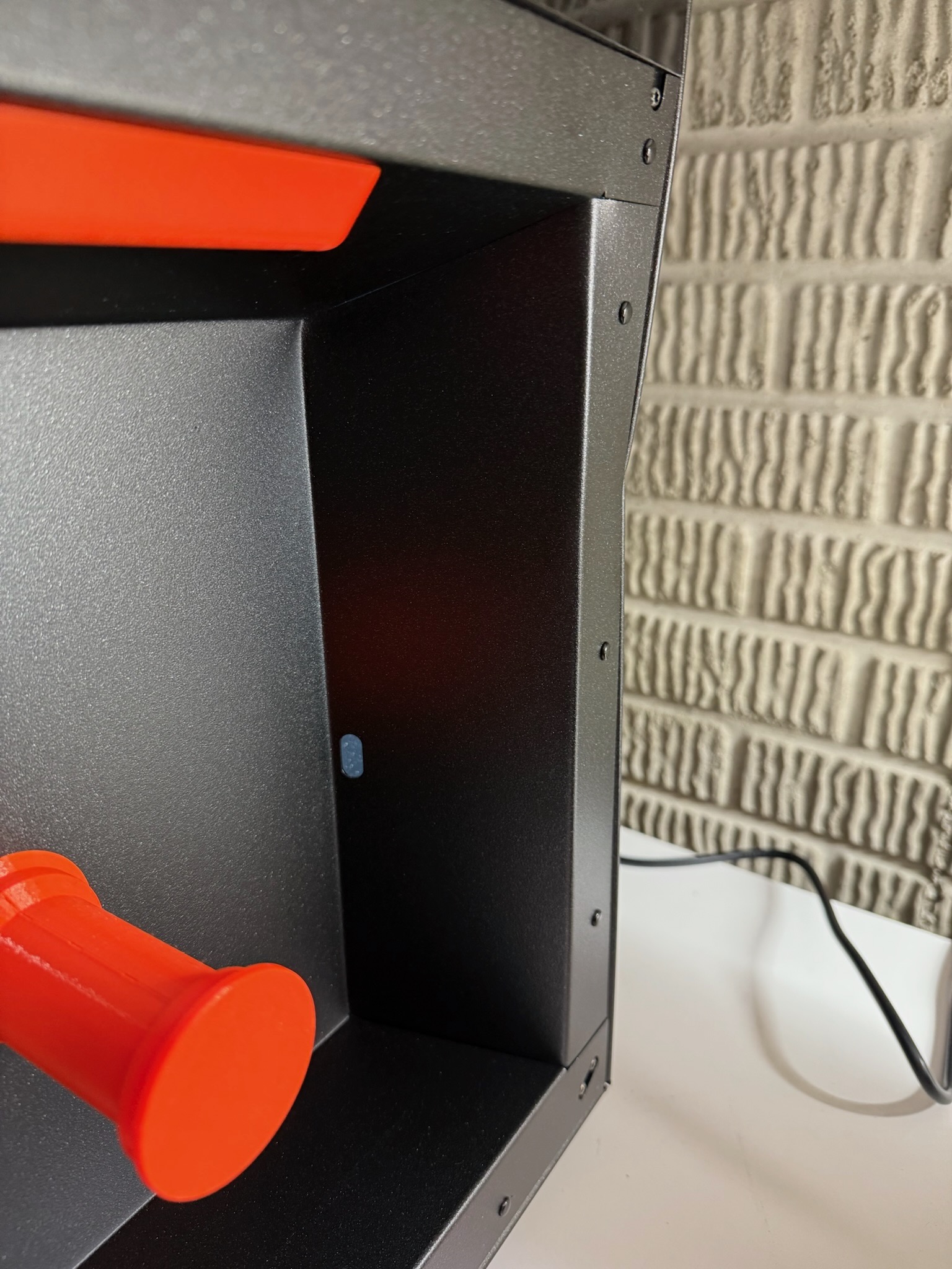

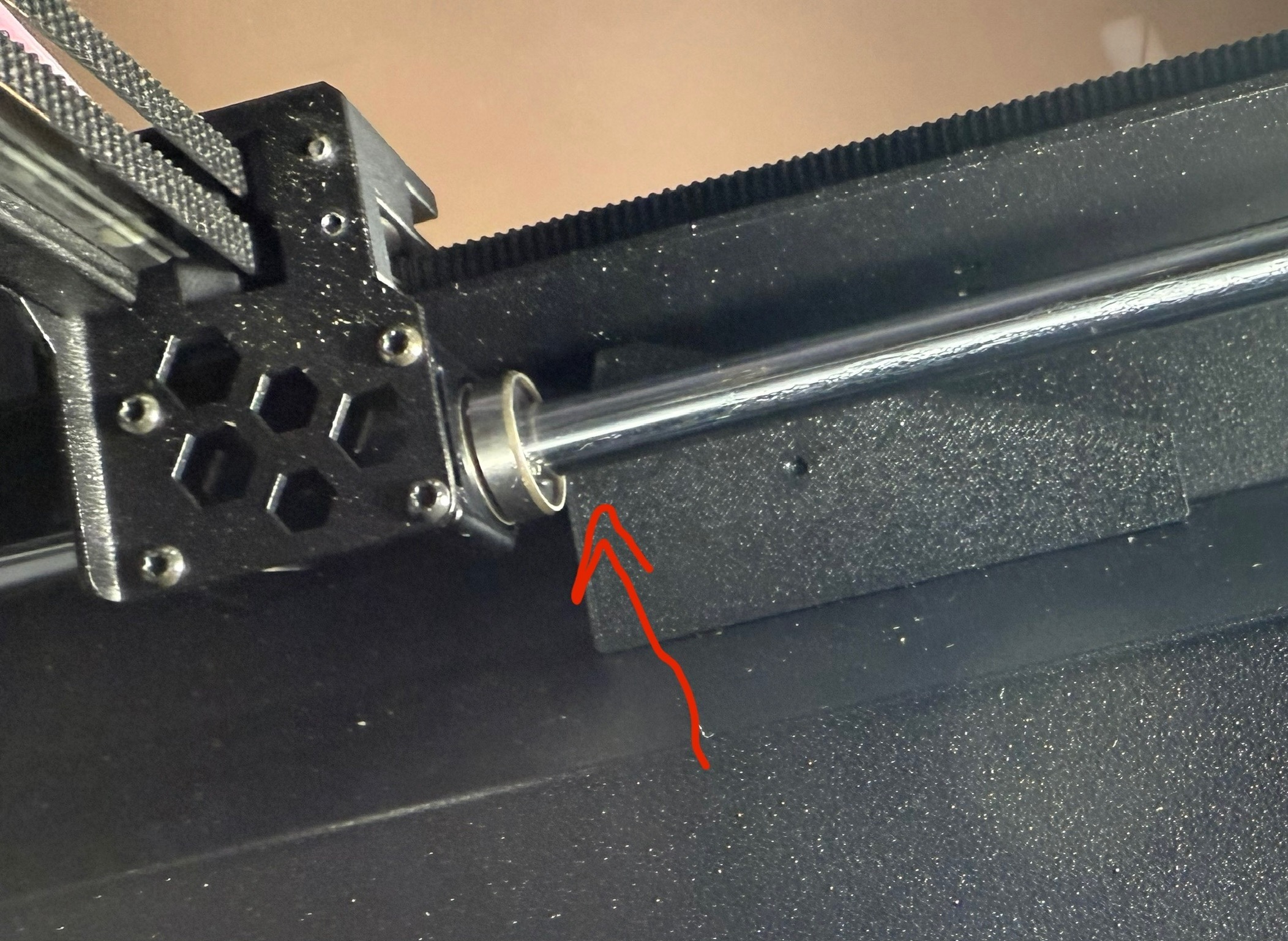

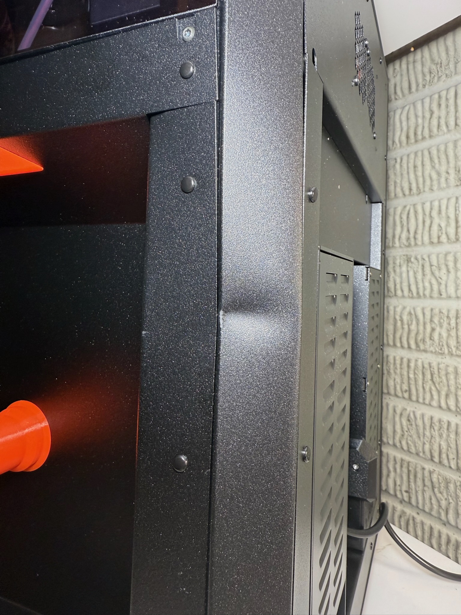

I had this issue today. It was caused by shipping damage in my case.
Self test failed Y-Axis test like you all.  Upon closer inspection I noticed there was a big dent in the outside of the housing and this was causing the Y-Axis to collide with the wall of the printer when it tried to traverse beyond half way!
Check your printer for damage, I think Prusa's shipping box isn't so robust for international shipping in this case.
This is where it was colliding on the inside:
Posted : 27/03/2025 12:09 am

To clarify, Prusa is sending me a replacement Core One because of the shipping damage.  I do wonder though if some of your axis alignment issues are coming from minor handling damage that isn't very obvious when casually looking at the printer.  For example: Maybe that angle started off as 90 degrees.
Posted : 27/03/2025 11:10 am
