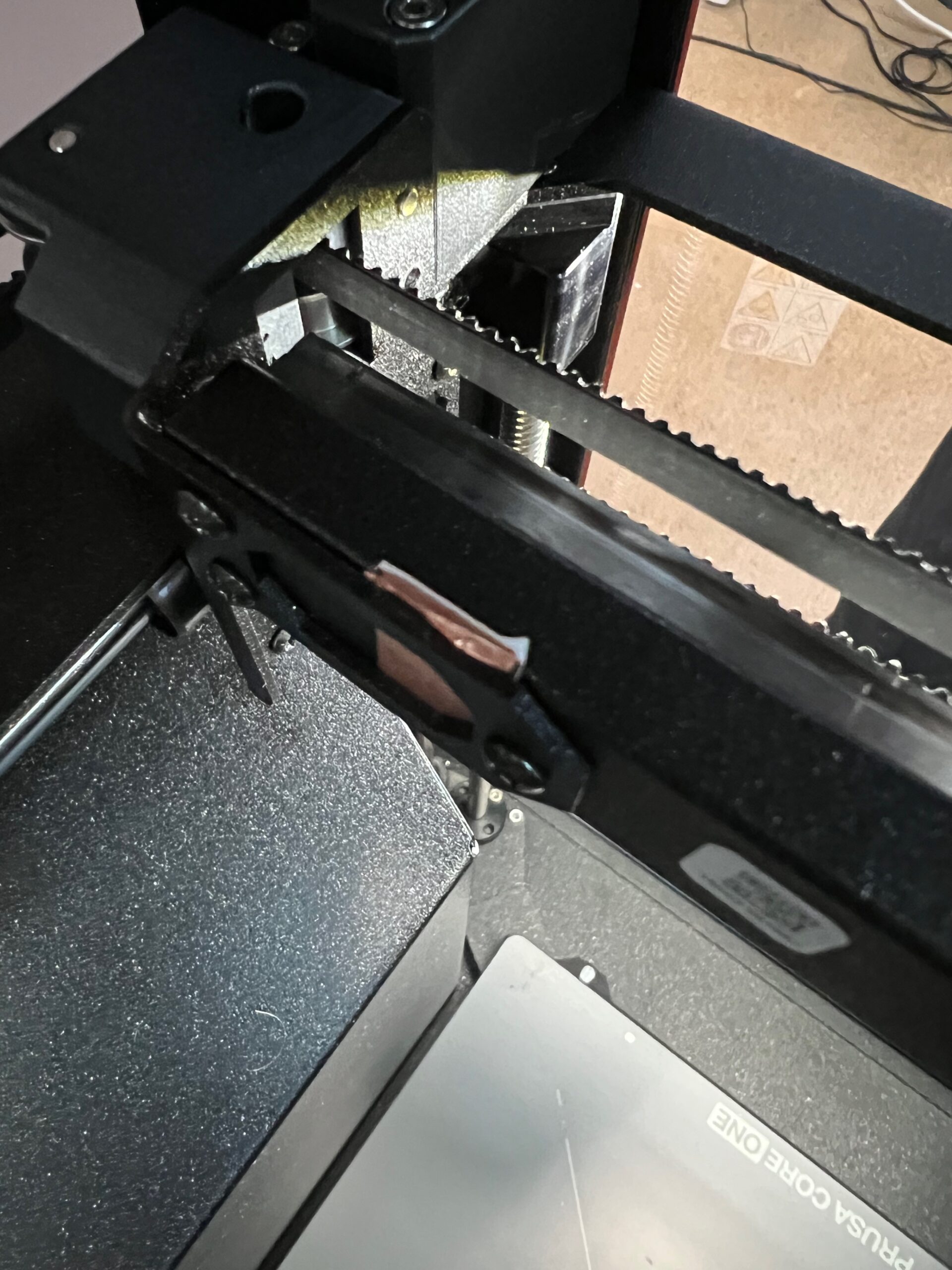

Mine fails both the Y-axis test and homing. Here are pictures of the left and right sides. I've tried different belt tensions. The Y-axis test passed with the "factory setup," but at that time, the left belt was much tighter than the right, and the print quality was terrible. Now, if I set the belts back to those tensions, it no longer passes.

Check out MartinF procedure on the previous pages using shims, trying to use belt tension to compensate for faulty brackets is not going to be a good solution but it looks like some in the assembly line still use it as a trick to make the printer pass.

Thanks for the suggestion! But I already straightened the gantry following the instructions from support, so it's too late for me to use shims. Also, support has not answered me for a week, so I'm not very happy with this purchase.

I'm not quite clear what the actual problem with your printer is.
If you successfully straightened the gantry by following the instructions from support, the printer should be able to succeed with the Y axis calibration.
Question: does your printer pass the Y axis test successfully when you start it manually from the menu (Control\Calibration and tests\Y axis test)?

My printer fails the Y-calibration test after I straightened the gantry. Before straightening, I could pass the test by tightening the left belt 10Hz more than the right, but that caused horrible print quality. Now, with a straight gantry, I can't pass the calibration no matter how I adjust the belts.

I'm trying to show that the gantry is straight from different angles. When I move the gantry, I push from the middle:
https://www.dropbox.com/scl/fi/3wdr7wvuw9bw83j1iznr0/IMG_3526.MOV?rlkey=x4kerw0efjprq1fy0ijxosmad&dl=0
https://www.dropbox.com/scl/fi/tl8tfaslnpyuo16ovugdi/IMG_3528.MOV?rlkey=3p43xy7hbpmrouwm6ek6nn4t2&dl=0
The gap was about 2 mm, but it's hard to tell if I used too much force to straighten it. I adjusted it multiple times, trying to use as little force as possible but enough to make a difference.
The belts should be at 85 Hz. I've used the belt tuner multiple times, tried tuning by ear, and even randomly set different belt tensions, but all attempts have failed.

Jukka, thanks for uploading the videos!
The grantry alignment looks good, but I'm not so sure about equal tension of the belts. In your first video, when you pluck the belts, the left does sound a bit tighter (more tension). But I may be wrong - it's hard to judge the tension by one pluck.
Calibration video: I think your printer has a problem by moving the head diagonally (45° angle). In one of the calibration trials (beginning at 0:55) you can hear that at the beginning the head does hit the stop of both axles alternatively. In subsequent movements the head moves away from one of the axes - it does only hit one stop in each cycle.
The printer does then starts a new calibration cycle (at 1:05) with the same result. I think there's more resistance in one axis than the other. The printer seems to loose steps in these diagonal calibration movements. I think the steps are lost in the Y-axis.
I do recommed to check the belt tension again (with the belt tensioner app).
When you already have read my recommandation in one of my previous steps, you know that it is important that BOTH brackets are aligned correctly (exact 90° angle). The gantry can be aligned well (like in your printer), but the individual bracket angles may still be off. You can check the situation with the following steps:
1.) loosen tension of both belts
2.) check if the gantry is still aligned perfectly (no gaps on either side)
3.) loosen the three mounting screws that attach the bracket to the X axis carriage on the left side.

After loosening both belts the left side still had a small gap (the same side that had a 2 mm gap before). I fixed this by putting copper tape under the right bracket. Now it feels straight.
I did all the other steps too and it seems good to me. I set the belts to 85 Hz many times. I also tried other belt tensions just to be sure. But it always fails the Y-axis test the same way as in the video at 0:55.
